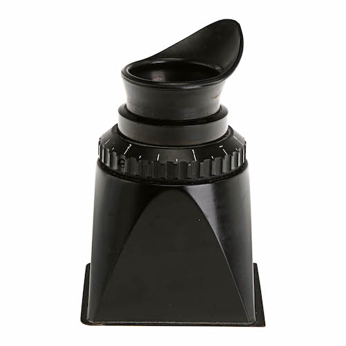

Like you, I also use the pop up magnifier, I had also considered a prism finder however it makes a semi portable camera into a behemoth instantly so I'm going to persevere, with a view to swapping out the screen if I don't get any better!
As for finder, I cannot agree more that prism is adding on quite a bit and also would not change much as focusing aid. I don't know if using the chimney magnifier (52094 or variants) would help you. While this has some bulk added, it weighs next to nothing and in several ways it is better in my view than WLF.

Unless I missed it in the thread, one other thing to check is the diopter used in your finder (WLF i'm assuming). The scribed marks on your screen should be critically sharp to your eyes, or you will never be able to focus correctly on the matte part of the screen. You can push the flip-up magnifier in and out a bit to see if the screen sharpens up, and if it is not optimally sharp when it is in the resting position, then you should fix it.
The other thing is, the acute matte screen has a small arial image component, which will appear sharp over a small range of focus. The technique to get critical focus is to ensure that the scribed lines look sharp at the same time the focus point looks sharp - which ensures that the focussed plane is coincident with the scribes on the matte side of the screen. The split and micro prism do not display this issue, and neither do the acute matte II screen (by your description, I think you have the II)
I use the Split, micro prism, and/or matte, depending on the subject and screen I have installed.
