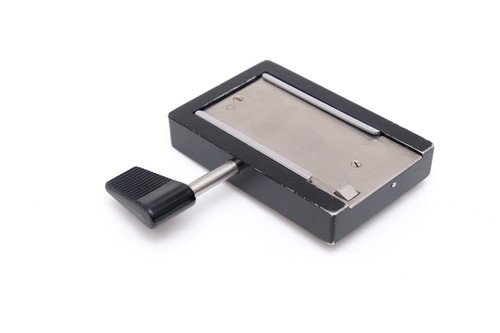

I really don't want to spend your money, but...
... for that tripod, get a Hasselblad quick release plate, either the long or short one; it doesn't matter which. Watch ebay and it won't take long to find one at a really affordable price.
For example:

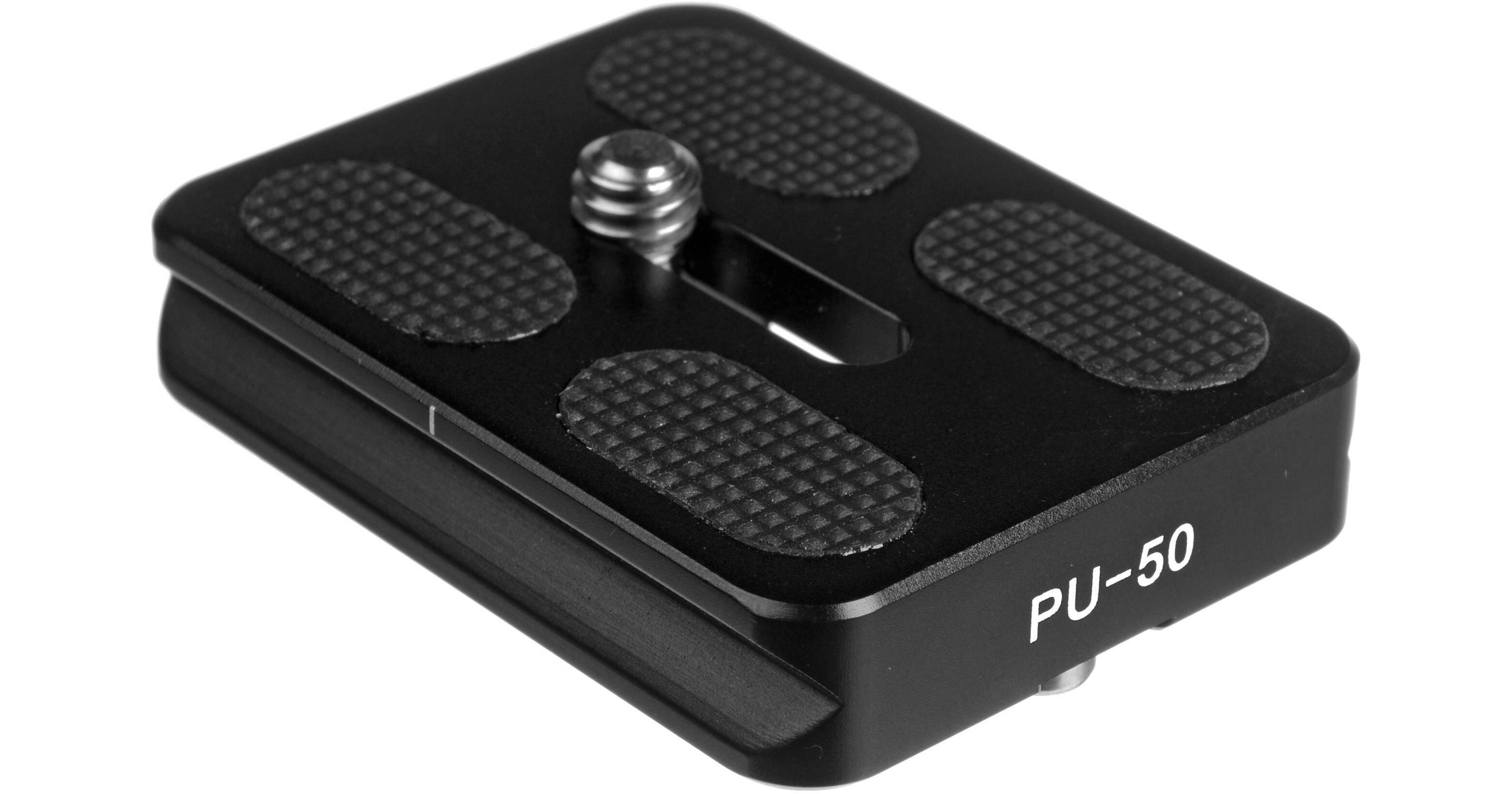

@BrianShaw What's even cooler is finding an arca-swiss compatible tripod foot for a Hasselblad. It works with any arca-swiss compatible quick release head, so you can use the same tripod head with any other camera. I've never seen one on eBay though.
Induro tripods meet that need at a lower cost.
