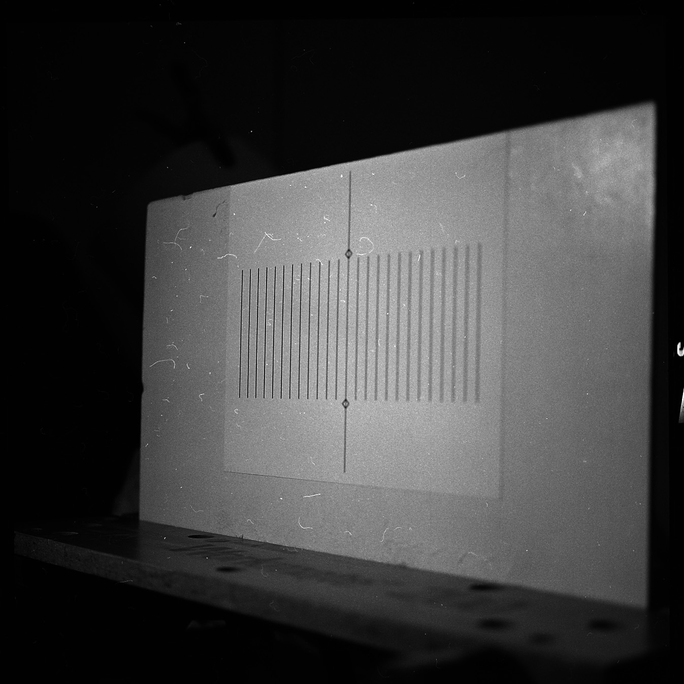

If a focus test is what you want to do, be sure the target is not flat to the camera. That won’t tell you enough. It has to be like 45 degrees so you can tell where the critical focus is in the negative vs where you thought you were focused.
Here is a very poor contact scan of the focus chart I use. Each line is about 1/2 inch apart. The chart is at a 45Âş angle to the camera, camera on a tripod. I focus on the center line (with the diamonds) at the lens's closest focusing distance, wide open. You can see from this particular image the focus is actually a bit further out than what I saw in the viewfinder, but not enough to be an issue a couple of stops down.

A fine way to check your lenses focusing.
If you can provide a sharp PDF, we should make it a sticky, for others to use and learn from.

I use the same method with success and can provide a pdf to print your own
