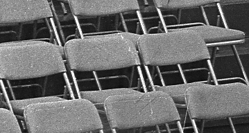

Yes, but the negative will be scanned. I'm attaching a 600 dpi scan from a test shot (HP5). I'm thinking if there had been people, they'd be reasonably clear.
