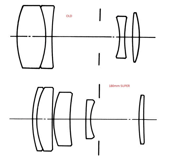

Thanks for the replies folks. I suppose all things being equal it looks like the one big difference and advantage is that the "Super" is going to be a newer lens which in the used realm is worth considering. By the way, regarding the black vs chrome lenses I've read that some people find the older chrome lenses to be sharper then the newer black lenses. I have a chrome and a black Blue Dot 80mm lens and honestly I don't think I could tell the difference; I've used both but never really compared the two but if there was a glaring difference I would be able to tell which was which.
Most of the TLR lenses have the same optical design. The exceptions are the 80mm 2.8 and the 3.7 which are different lenses, the 180 Super is 5 elements in 4 groups vs 4 elements in 3 groups in the earlier versions, and there was a change in the 105mm design that actually altered the back-focus - it went from 4 elements in 3 groups to 5 elements in 4 groups with the D and DS. So performance is not going to vary much between lenses in good shape. Using a decent lens shade goes a long way towards getting the best out of any older lens.
I personally rank the 180mm Super among the best lenses ever (all times, all makes, all formats). It is definitely the "signature" lens for the Mamiya TLR system and by far the first that comes to mind when one talks about the highlights of this system. Optically it was completely redesigned in order to get better performance and also a much shorter barrel, as can be seen in this comparison picture.
This of course doesn't necessarily mean that the "standard" 180mm is not a good lens, but I never heard anyone regretting having purchased a 180mm Super.

Interesting - is the perfect Mamiya RB (RZ) 180mm lens of the same design as Mamiya TLR 180 mm Super ?
I'd say not at all, the only thing they all have in common is being triplet derivatives and being long focus lenses (that is not telelenses).
The "standard" C 180mm has a sort of reversed-Tessar design, with the cemented doublet facing the subject. This Tessar variant is quite peculiar and as far as I know very few other manufacturers used it, among them Taylor, Taylor and Hobson.
The C 180mm SUPER was radically redesigned to an extent that it's even hard to tell that it's still a triplet derivative; it may be recognised as such by considering that the expected front positive element is composed by two split positive groups of which the first is a cemented doublet closely followed by a positive singlet; this said, the central negative element and the rightmost positive element should be easily detected. This scheme is once again very peculiar, and it is worth noting that also Asahi used it in another highly regarded lens: the 135mm Takumar, with the bright f:2,5 variant being nearly identical to this one.
For their RB 180mm Mamiya went a more travelled path by choosing the super-classic Voigtländer signature optical scheme of the Heliar / Apo Lanthar lenses, but putting the shutter/diaphragm assembly on the back:
The C 180mm SUPER was radically redesigned to an extent that it's even hard to tell that it's still a triplet derivative; it may be recognised as such by considering that the expected front positive element is composed by two split positive groups of which the first is a cemented doublet closely followed by a positive singlet; this said, the central negative element and the rightmost positive element should be easily detected. This scheme is once again very peculiar, and it is worth nothing that also Asahi used it in another highly regarded lens: the 135mm Takumar, with the bright f:2,5 variant being nearly identical to this one.
