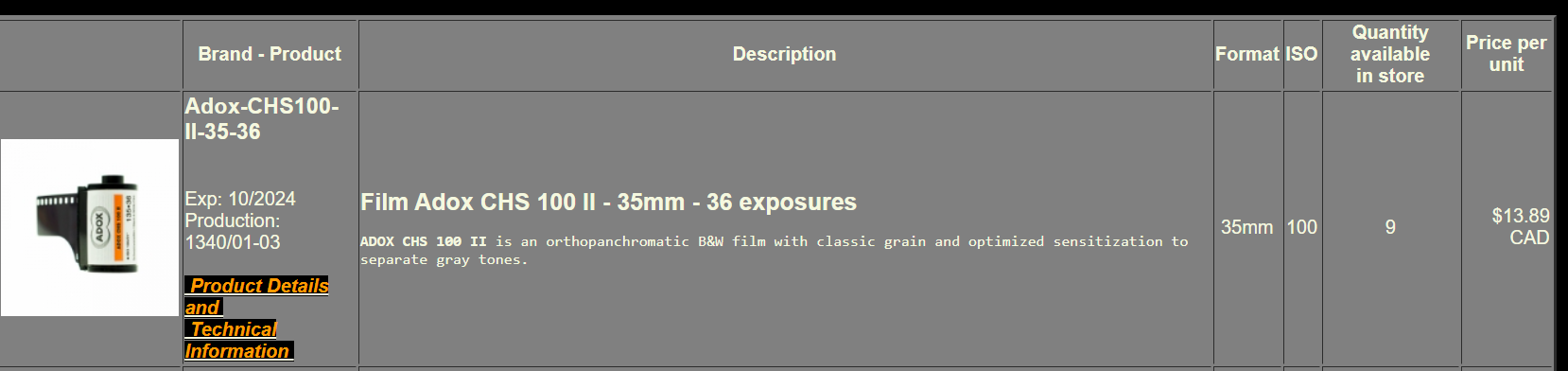

Thanks for the help everyone. I now have 9 rolls of CHS 100 II film on the way.
GregY should contact Argentix and get his sales commission. :D
Jacques at Argentix is great. I just wish he could scale up the availability of what he has on offer.
Yes, those 9 rolls of 35mm finished off their Adox. Since Covid, there seems to be more out-of-stock than in stock, on their website, as far as film and paper are concerned. Like Adox film, Foma paper is virtually all gone.
I just ordered a few rolls of 35mm CHS100ii. Since Brexit (#littlebitofpolitics) I have to order at least 170 Euros' worth of stuff at a time. If I ordered that much as film, I would use it, slowly, but I confess it's off-putting: maybe wouldn't be if I could get a new job. Also because of Brexit, Fotoimpex can't charge me the VAT; but I will have to go to the depot and pay import duty on the stuff before I can have it (and I don't know in advance exactly how much that will be). Anyhow I think it could be as soon as tomorrow, from the DHL tracking.
My dozen rolls of film, and a few hoods and some developer, arrived this afternoon. I didn't have to pay any tax, so now I have to stop griping, though this is a strictly temporary measure. All the hoods fit the things they are for, nothing vignettes, everything is groovy. The first roll of CHS100ii will go in my Zenit (the original Zenit; mine is from 1953, so is 70 years old this year), as soon as I finish the HP5 that's in there now. I also want to put some in my Balda Jubilette, and then maybe the Canon A-1.
When anything is out of stock, I usually just email Jacques and ask him if and when he can bring the item in.
