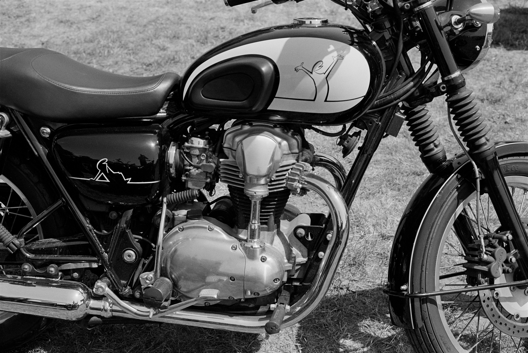

Just continue with ADOX CHS 100 II.
Because it is very similar to Silvermax: The spectral sensitization is almost identical, sharpness and resolution as well.
CHS 100 II has a bit coarser grain.
In a blind test you will really have difficulties to differentiate the both. I have that situation often with my Silvermax and CHS 100 II pictures: I have to look at my notices of the prints to see from which film the prints were made.
By the way:
Also both films have a characteristic curve which flattens a bit in the highlight zones with a (semi)compensating developer like FX-39 II.
That is very helpful in higher contrast scenes (see the first three pictures below, which all had a high object contrast due to the light situation).
Here just some examples of Silvermax and CHS 100 II in a blind test:
Try to identify which photo is from which film 🙂:
