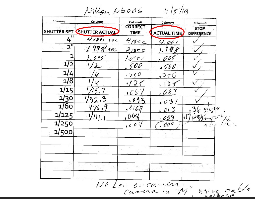

I have a 30+-year-old Nikon N6006 SLR, electronic. A couple of years ago I checked the electronic shutter and was happy to find it's absolutely still accurate, more than any mechanical camera (lens) I have. I couldn't;t really check it faster than 1/125th of a second. But look at the results I got for the other settings. Really quite accurate.
