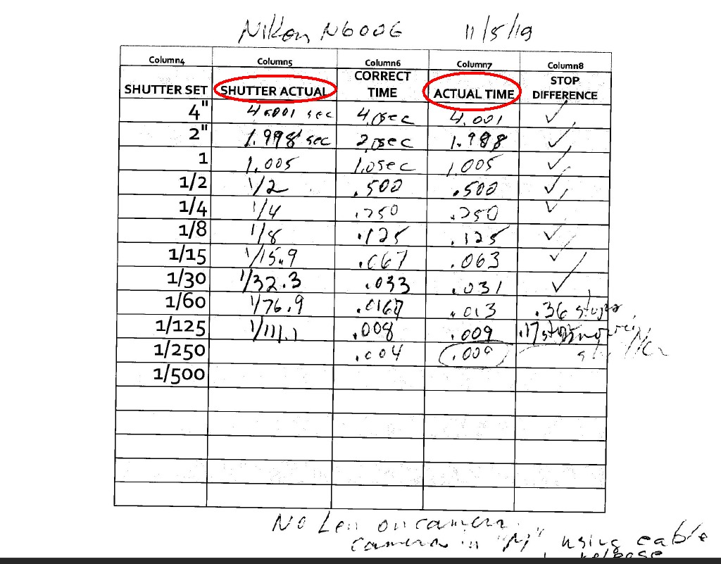

I have a 30+-year-old Nikon N6006 SLR, electronic. A couple of years ago I checked the electronic shutter and was happy to find it's absolutely still accurate, more than any mechanical camera (lens) I have. I couldn't;t really check it faster than 1/125th of a second. But look at the results I got for the other settings. Really quite accurate.

As you can see from my last post, the all-electronic 30-year-old N6006 seems to work flawlessly including exposure and shutter. Here are sample shots were just taken with it recently. using Tmax 400 35mm film.
https://www.flickr.com/photos/alanklein2000/albums/72157716777378896
Meanwhile, my Nikomat FT3 which is all mechanical except the built-in manually adjusted exposure meter does not expose correctly half the time due to drift with the metering. So at least in my experience, electronic cameras seem to be better, at least slightly modern ones like the N6006. I guess the answer is to make sure you buy one that works when you buy it. And hope it lasts awhile.
