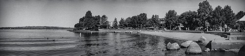

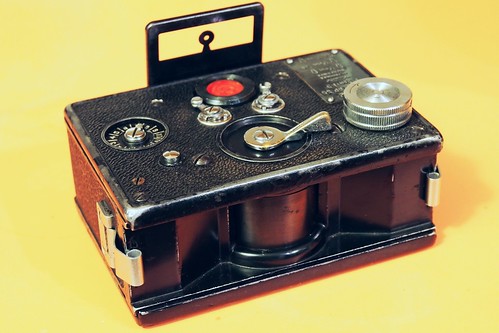

Another to consider in 35mm is the KMZ FT-2. It's a swing lens with a curved film plane. It's not the easiest to use but they are more affordable than most. Do a bit of research before you run out and get one. They say you can't use them without the special film cartridges that you would need to re-load film into but I made a few minor modifications and have been using mine without the cartridges. You just have to load the film in a dark bag or dark room.
KMZ FT-2 by Bryan Chernick, on Flickr
Marina Park by Bryan Chernick, on Flickr
