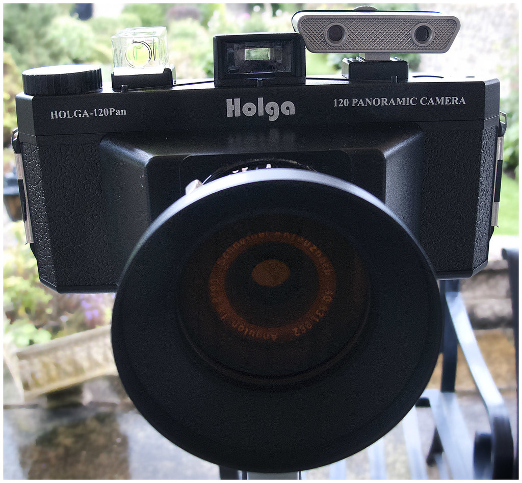

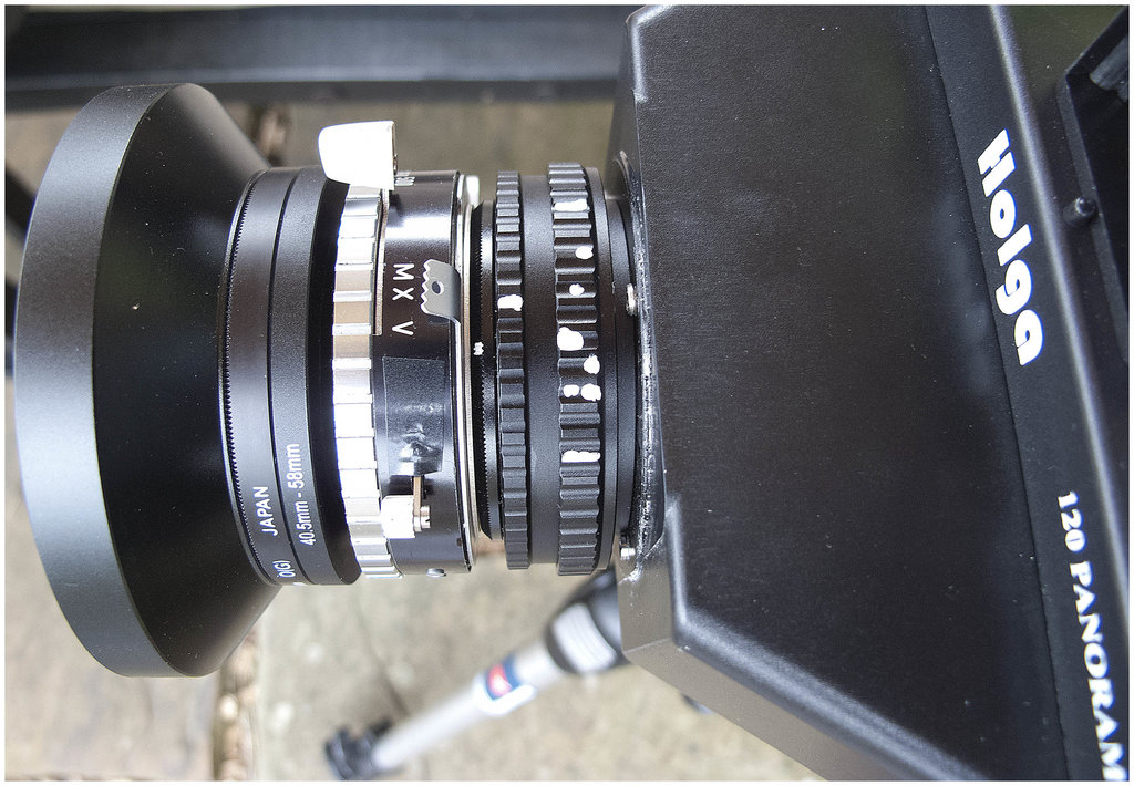

HolgAgon! £167.86 including lens is what mine cost.
attachment.php
attachment.php
attachment.php
Full instructions here: http://freepdfhosting.com/b316cbe2ff.pdf

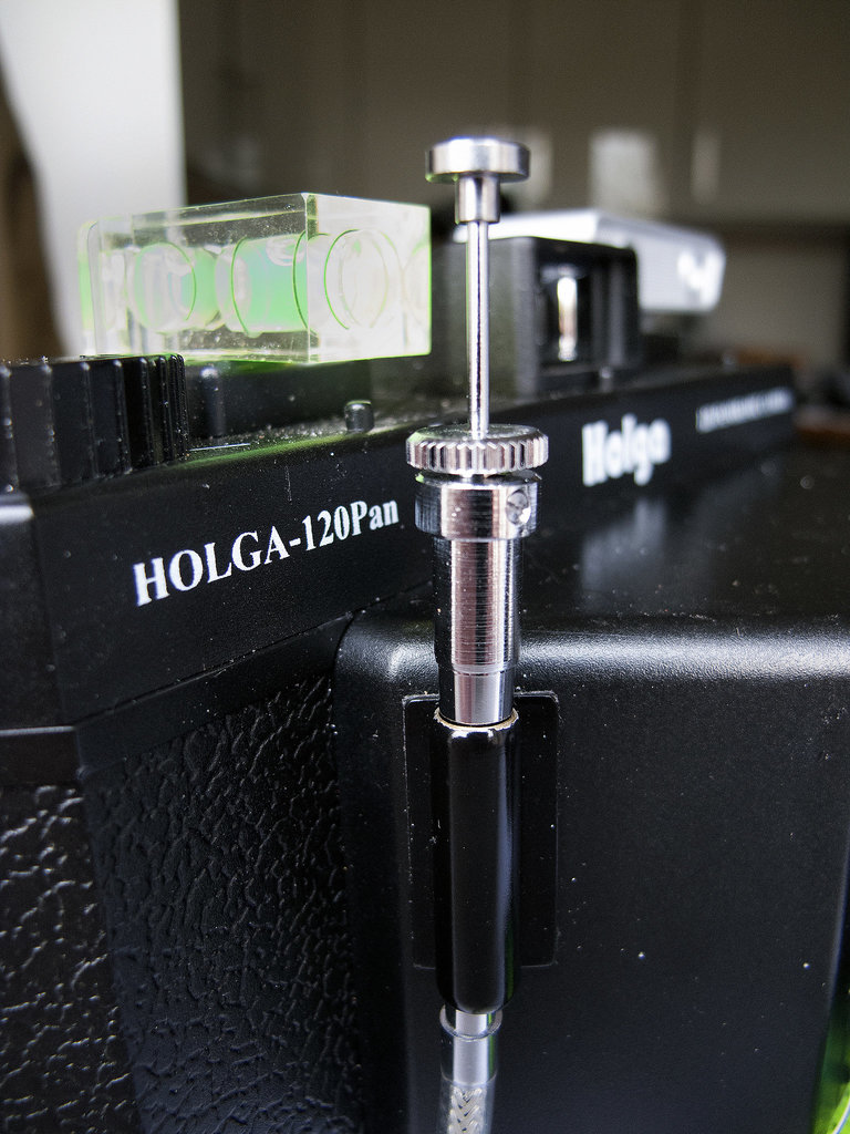

Lightweight, low-cost, practical it's become an important tool for much of my photography. It can even be made easy to use hand held with one of these:
attachment.php
