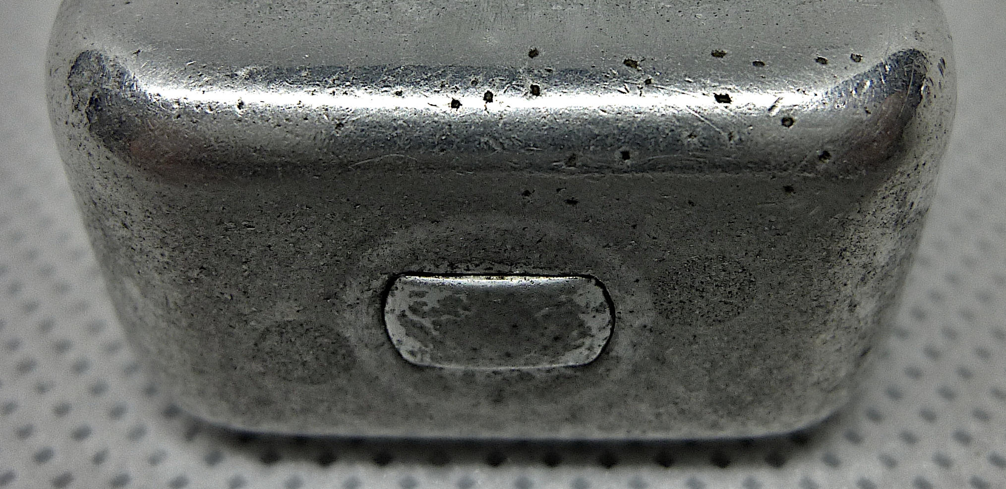

It was built in 1954, so it is a Type A IIIs. Damage caused by impacts, heavy abrasion everywhere and even pitting in the housing:

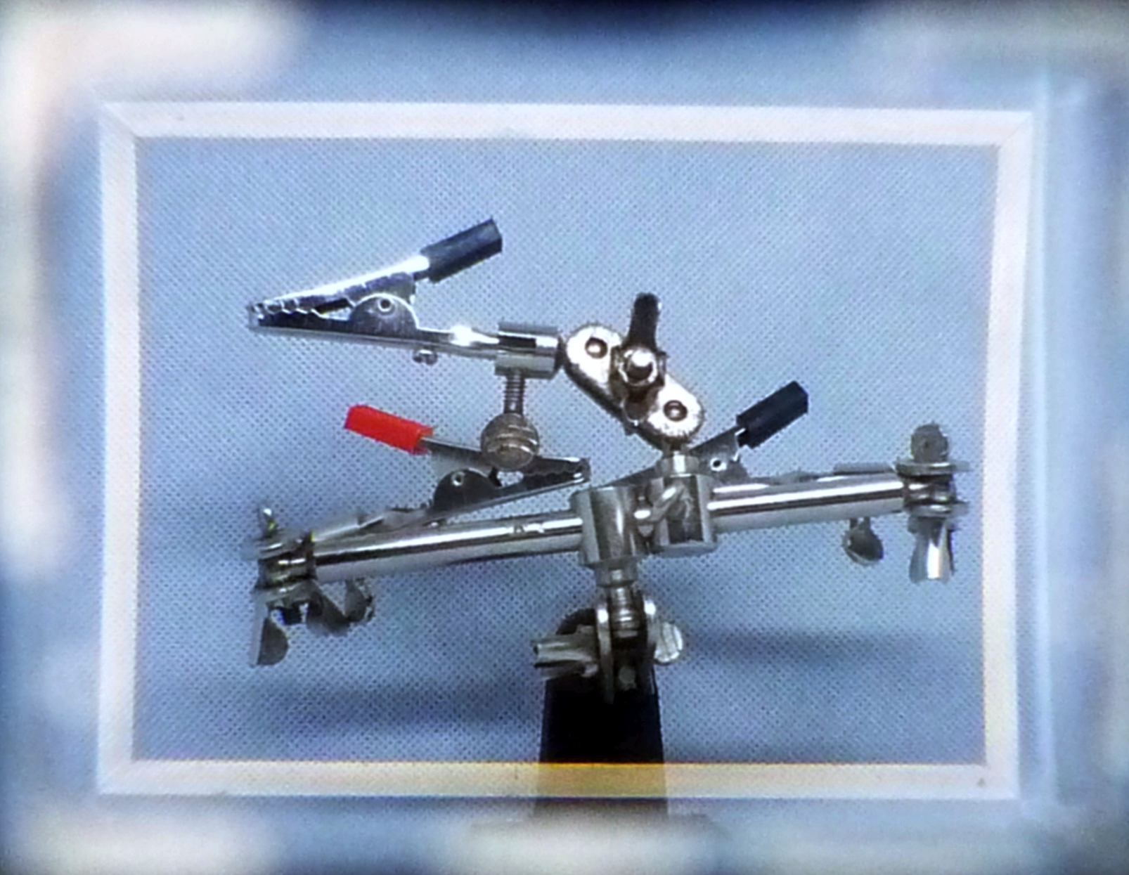

View through the illuminated frame viewfinder with automatic parallax compensation:

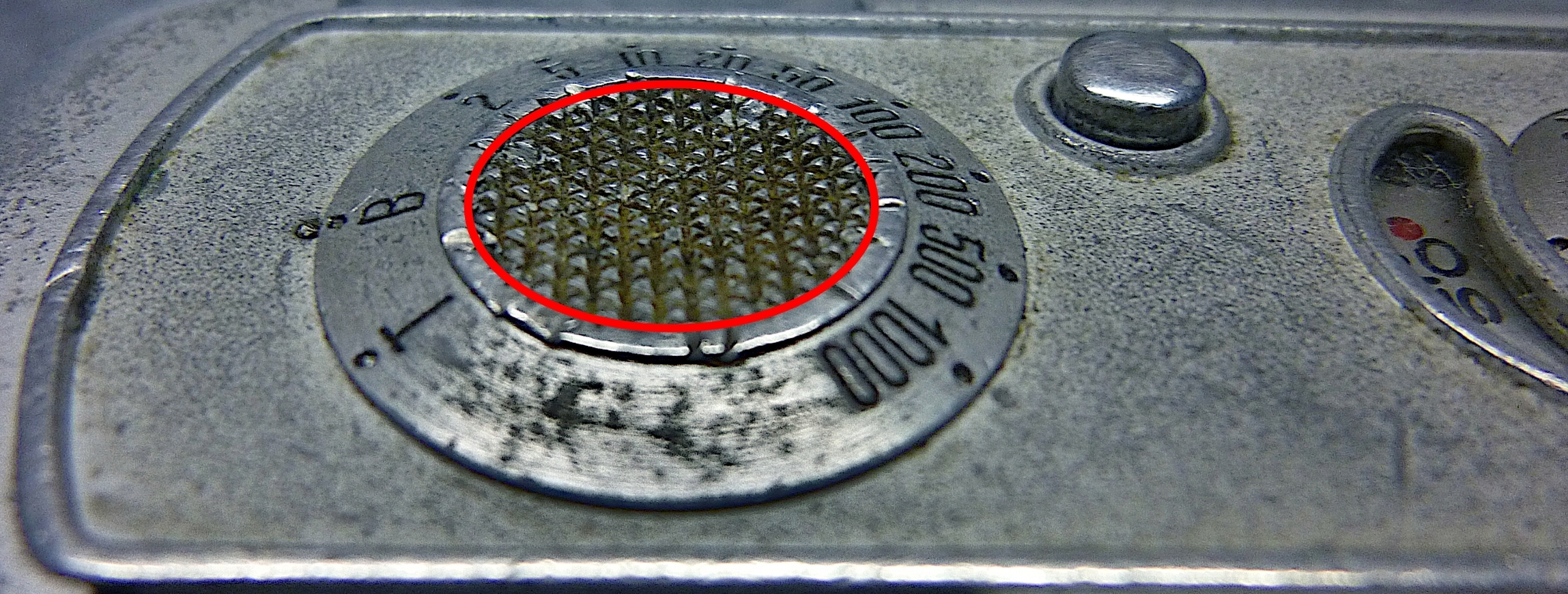

Second surprise: the shutter works, even if the times are randomly wrong.

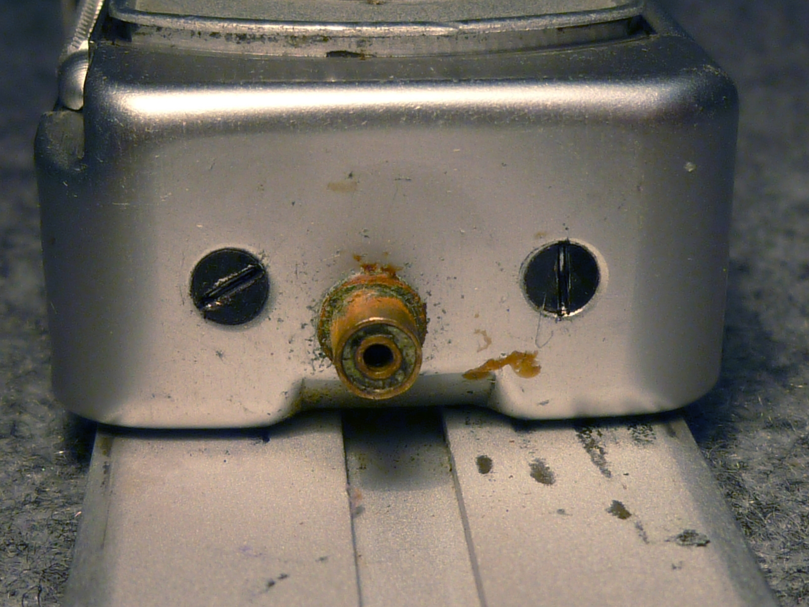

With regard to the shutter speeds, it was suspected that the pivot points in the escapement were difficult to turn due to resinification. The escapement on the Minox is easily accessible via the upper end cap, which is only attached with two screws (in the middle the flash contact):
A look inside shows that the mechanics are in very good condition. You can see how dust-tight the housing has protected the interior for 70 years. At the top edge of the case you can see exactly how far the dirt has made it. The aluminum profile of the cover plate acts as a labyrinth seal - without any rubber:

By patiently applying small amount lighter fuel to the bearings and gears, alternating with shooting at the slow shutter speeds, the movement became smooth again. Since then, times have been running plausibly and consistently again. The video gives an impression of it:
