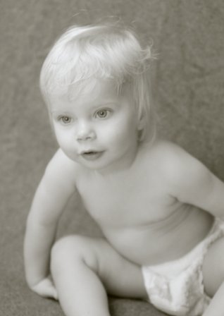

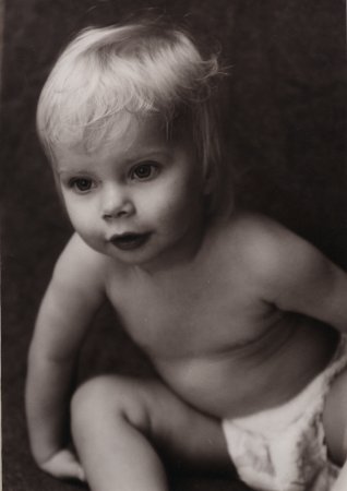

So i have a neg and print from late 2003, my first daughter Hilda.
Film is kb25 shot at 25 and developed in acutol 1+14 for recomended
time. the print is a straight print, emaks grade 2, dektol 1+3, then kodak
rapid selenium toner.
I am not sure what kind of illumination used, but likely used a couple of
300 Ws flashes bounced on ceiling and wall.
Probably quite large aperture, a non-still subject, and a resulting non perfect
sharpness.
The scan of neg and print is straight scans, no contrast adjustments, no
black/white-points set, the scan of neg is inverted though. =)
The scan of print looks contrastier and darker on screen than print in hand.
Is this neg adequate?
