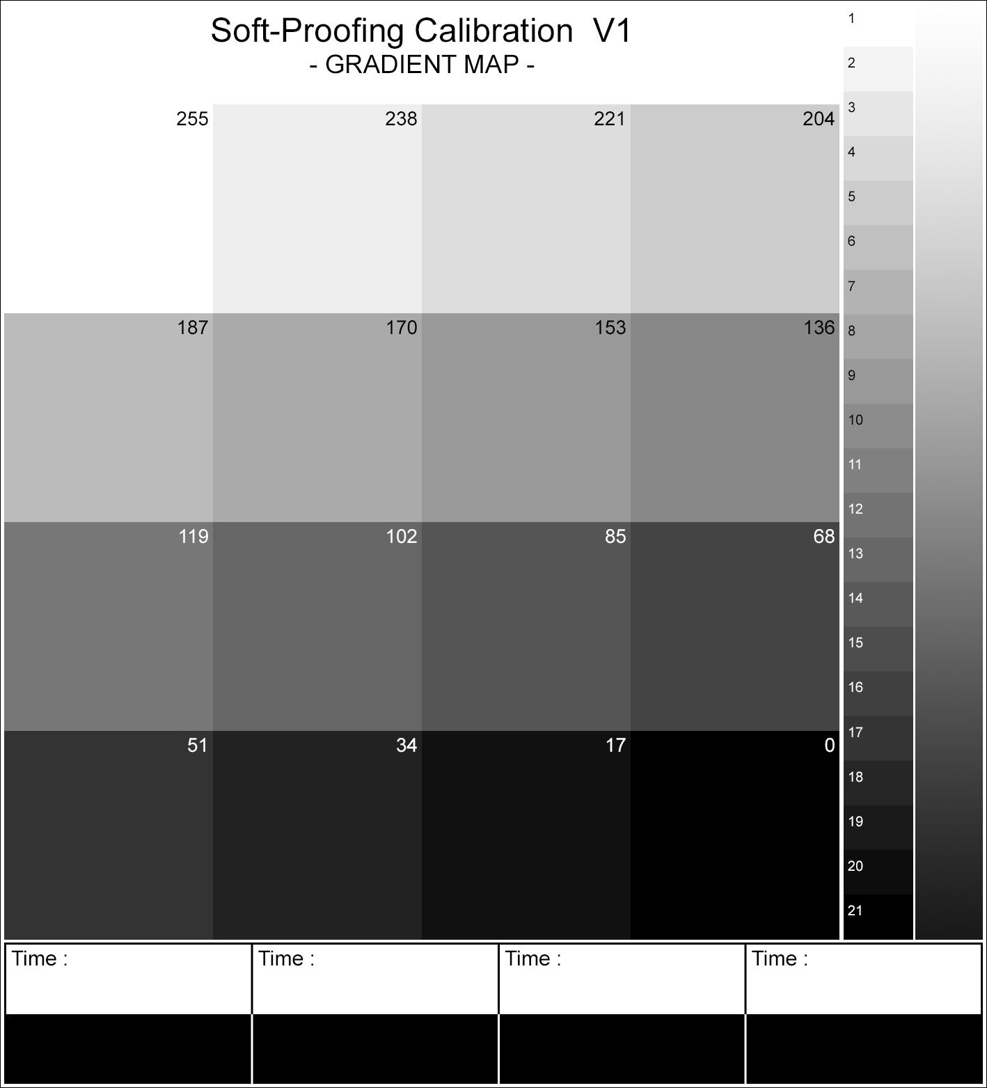

For now I've just ended the part of the script that draws the 16 grays Calibration Map. The gray patches are 300x300px.(1 inch when printed) because larger patches help to get more accurate results. It is pointless to build a larger map as long as only 16 points are acceptable in the curve creation. The strips at the bottom are intended for exposure tests.

Any suggestions of how to improve it?

I would not say that it is pointless to use more patches. There are a lot of steps between 255 and 238 and you can not see where the tones are dropping off if you don’t include them (the same for the other end of the scale).

So, you suggest to add more patches at both ends. It can be done and in that regions I'll calculate the points that generate the curve from readings.
Another way would be to keep the number of patches 16 but to use more of them at both ends (and fewer in the middle), where the problems usually are. Or, even better, to offer 2, optional, calibration maps.
It needs some real tests to see the difference.

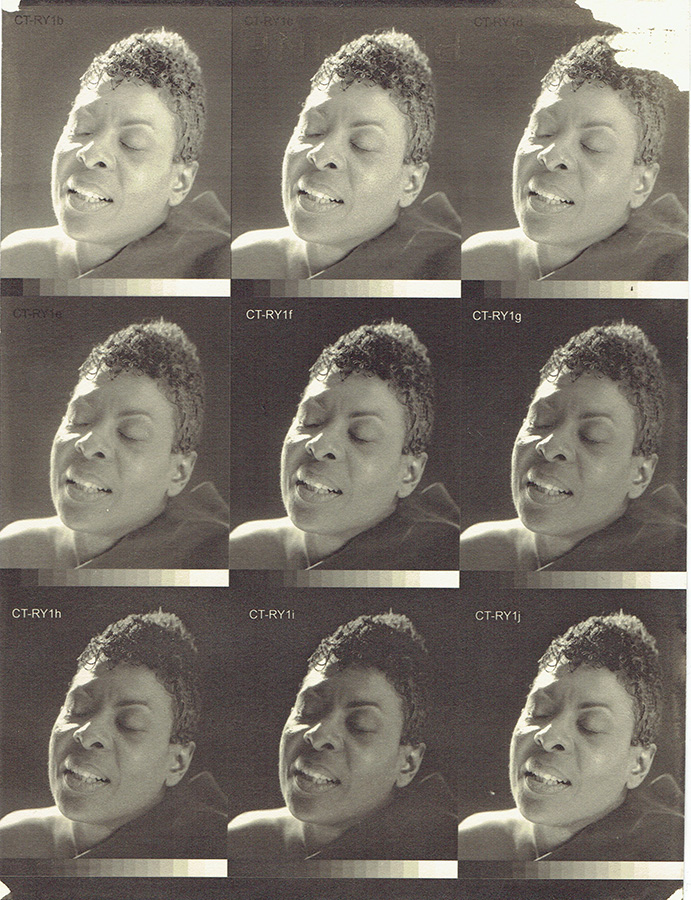

My own approach is more calibrationist. My Zone II (barely perceptible dark-gray) is RGB 30-30-30 and my Zone IX (barely perceptible light-gray) is 243-243-243. I can find the darkest and lightest textured areas and keep them within those limits. All that's left is the midtones. I made a curve-test negative starting with CharThrob's recommended curve, then tweaking and saving nine variations. I printed that and picked the curve I liked best. It seems to be working for me.

That's exactly right. There are different ways of achieving the final outcome. You are doing a tweak of the main ChartThrob-provided correction curve. What I do is apply the ChartThrob curve as is and add another curve underneath to make the final image to look like the way I want. The key is, as you surmised, because of the inherent lower contrast of the process itself (clipping everything below 30 and above 243 in your case,) we have to give it some more perceptual contrast to the original image which was otherwise processed to look its best on the monitor. The only drawback with your appraoch perhaps, though there is no substitute for empirical data, is you have to print that matrix and pick the best. The approach that both I and Dan are proposing is to use a simulation method to predict before printing the image to get a general idea. You can do this pre-tweak by using a curve or any other available means in Photoshop with or without masks.
