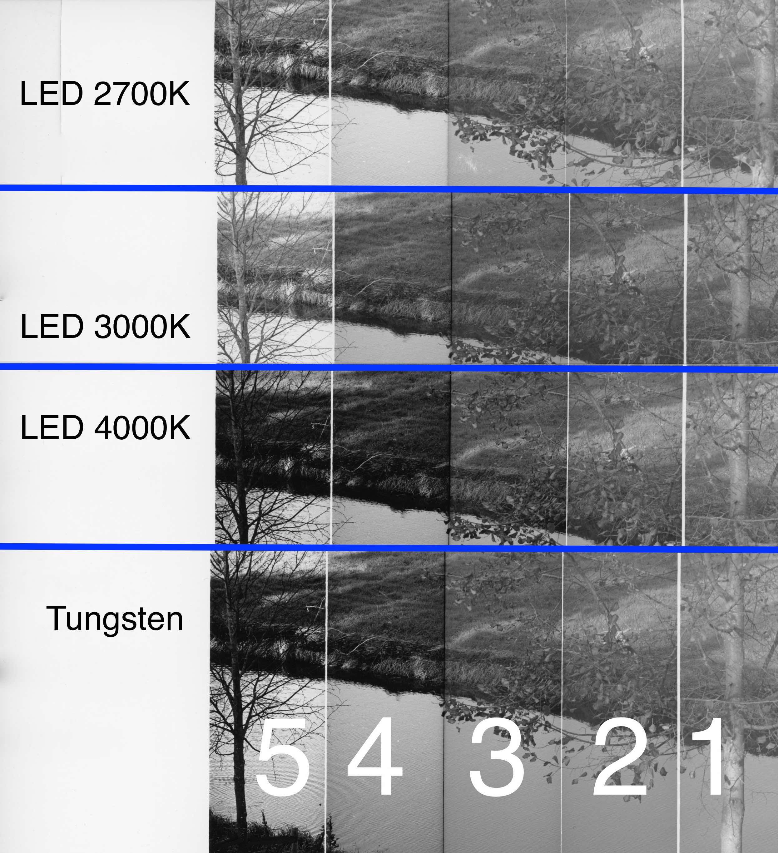

LED bulbs work perfect! Just make sure you have bulbs with a color temperature 4000K or higher. The image shows my test results. You can also look at this post:
https://www.photrio.com/forum/threads/using-led-bulbs-in-an-enlarger-great.148255/
Ron, are you inferring that I cannot get adequate contrast differentiation with my 'low' 3000K bulb? I have tested but cannot see a contrast difference compared with my #211. Your '3000' seems to be a bit underexposed. - David Lyga
The test that Ron presented is very interesting. But as he did not specifiy the models of lamp (and this includes the incandescant one and the voltage he is running it too), we only can guess that it all will work with the models we would use.
Moreover I got the impression that there still is fluctuation of models even at one manufacturer.
http://www.modernenlargerlamps.com/Modern_Enlarger_Lamps/Model_2_Data.html
Here are the VC tests Emil performed with the Modern Enlarging Systems Model 2.
His enlarging head uses Cree XP-G LEDs which he says are the best you can get.
The lamps I used for these test are Osram Parathom Classic (4000K) and Philips (2700K); don't recall what the 3000K was. The incandescent was a Philips Photocrescenta 150W at 230 volts. And you're right: there are fluctuatiions. So there is no guarantee and I recommend you do your own testing. I have several Osram Parathom Classic 4000K bulbs in use, different watts, and they all work fine.
With fluctuations I meant substituting of models. This still is a new market.

The test of @Ron789 is interesting and i'm courious how 4000 kelvin temperature can work correctly with the contrast of paper!

Thank you very much, before watching this thread, i tried a full opal led light (Philips) of 2700 kelvin and 17,5watt....but It wasn't enough for the print (very very very long time). Consider that my enlarger Need 150watt.
With 4000 kelvin i saw more food result but i agree that i Need 2700 kelvin for the same result.

I think the bottom line here is that not all led bulbs are the same. In the facility where I teach darkroom, the owner replaced the lamps in all of the Beseler 23C enlargers with leds. Worked fine for my beginners, but I was skeptical when it was time to imtroduce contrast filters. However, they appear to work fine. Or, at least well enough for our purposes. I am still skeptical that the grades are exact, but if one can get the print they wish, the all is well. As was said, test and see.
