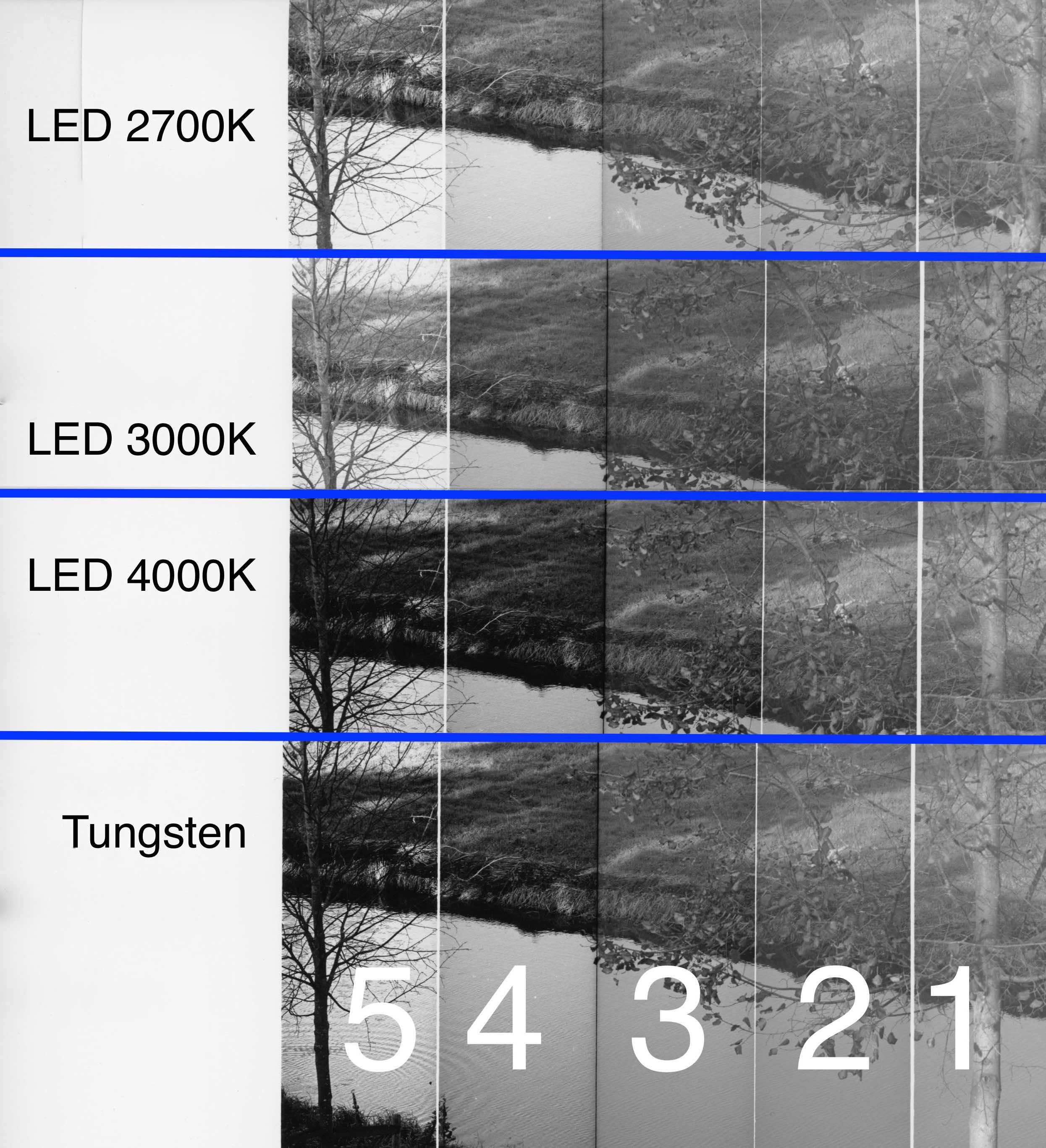

Just contract print some step wedge images with the Ilford filters and see how the LED behaves. White LED spectrum can be all over the place, depending on how your lamp is manufactured. Or, as you suggest, print on graded paper and not worry about the LED spectrum.
Image shows color spectrum of three samples of WHITE LED, it is closer to an incandescent lamp than a high-voltage gas lamp.

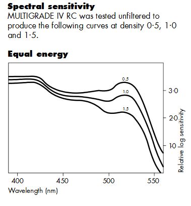

bernard_L
Feb 17, 2008
2,028
What would worry me is the dip around 470nm.
(from https://en.wikipedia.org/wiki/Light-emitting_diode)
For both MGFB and MGRC papers, Ilford states that each of the three emulsions has a different amount of green sensitizing dye; no mention of sensitivity at an intermediate wavelength, like blue-green (say 500nm). So far so good.
For the FB paper, the sensitivity curve matches the text, with a dip... just at the same wavelength as the "white" LED; pre-arranged harmony?
For the RC paper, the curve has three "humps", the middle one being at approx same lambda as the dip in the LED emission.
Go figure. I would bet the emulsions are actually identical, and either one of the documents is an obsolete version, or the curves are "artist impression", (or both).
So, in the David Lyga spirit, I'd say: just test. Maybe the result will be different from incandescent. Maybe, even, it will be more eye-pleasing to some. Who knows.
