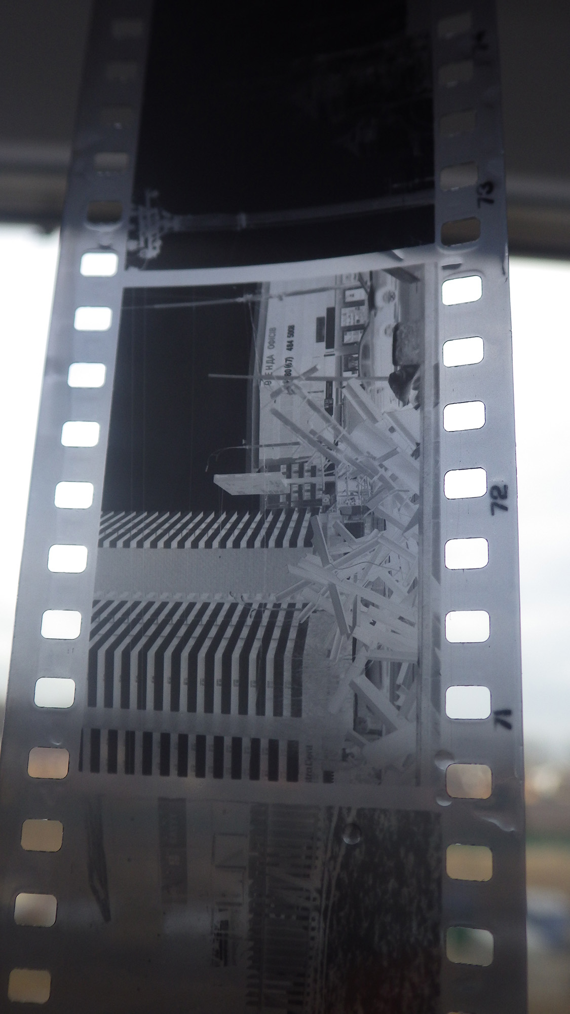

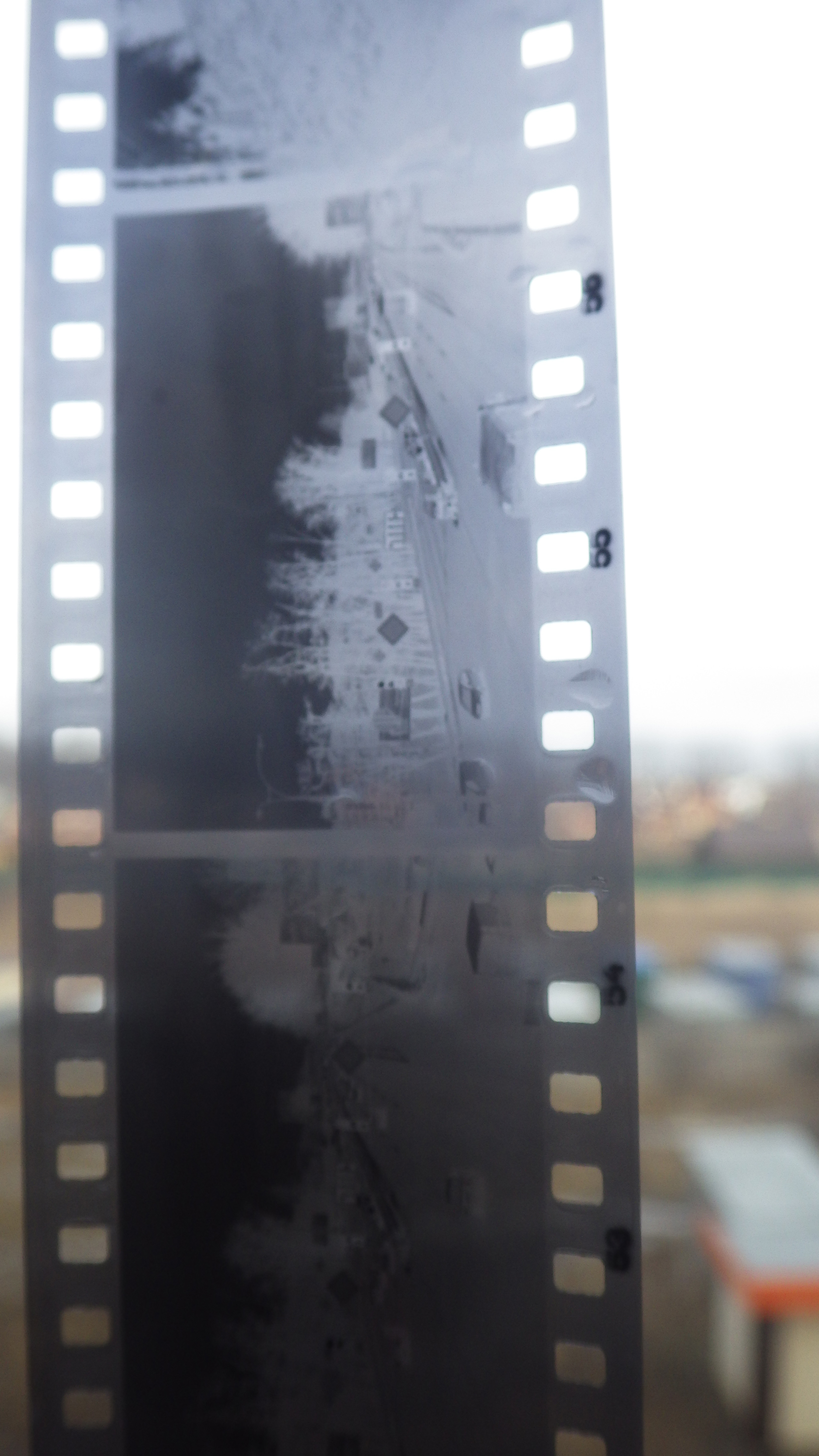

Just developed the film. Film Svema130, overdue for 40 years. Camera Zenit11, lens Helios 44, developer "Microphen" dilution 1/3 + a little benzotriazole. Method "3.14" gave me a development time of 40 minutes. This method is intended for such cases.
