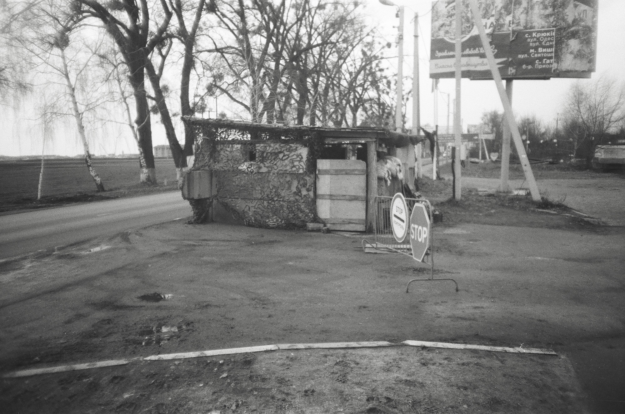

In this case, the film with which I show the photo is Foma200 but of an unknown winder, without perforation marking, Microfen developer in 1/3 dilution. But of course, during life, to a greater extent, the film was Svema, and the developer was D-76
I wouldn't have known you were using a translator. It's amazing how good they are! I'm glad the translator is working so well for you because now we get to see your images from Ukraine.

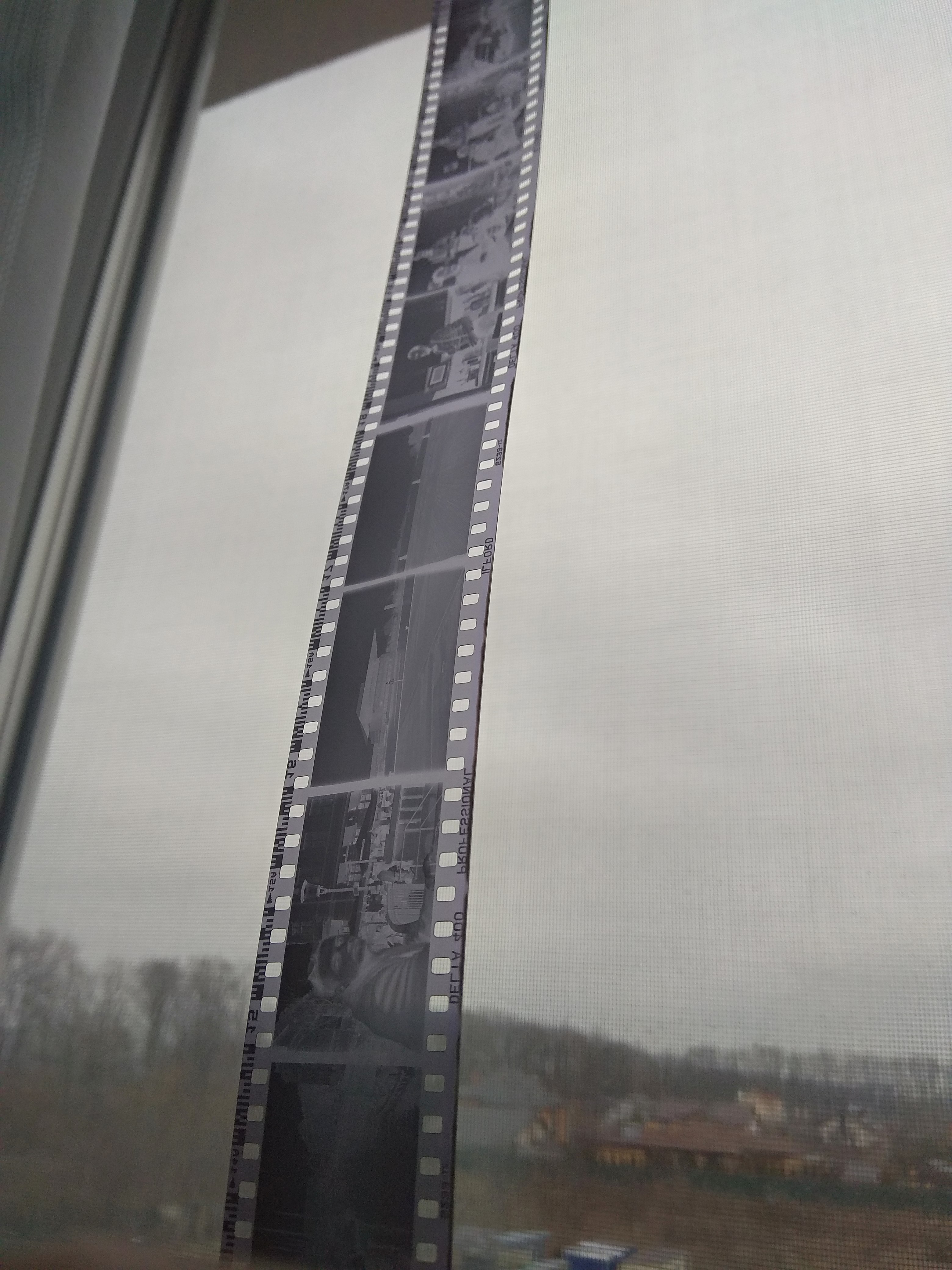

Thank you! In this case, a few more photos from the same film. In the last photo on the left in the background is the house in which I live

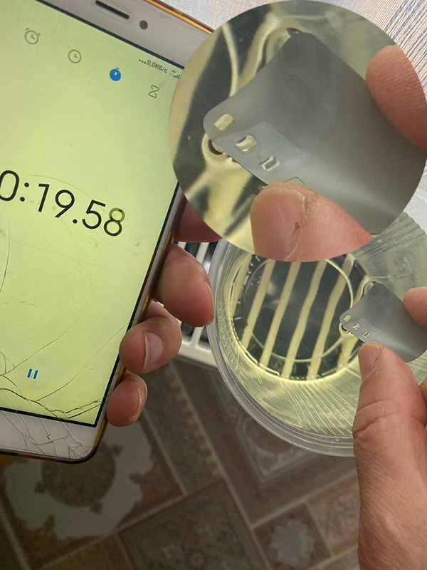

There's the usual one: put a piece of the film in the developer (in the light) and see how long it takes for it to get completely dark. Double that time as a guess for actual development.

Thank you! Thanks to my daughter, I was in Prague three years ago and I really liked it. I do not want to say that the method is ideal, perhaps it gives errors, but I am not sure that it will not spoil the film when there are any unknown
It may not be ideal, but it may be a quick way to determine a starting point for a given film+dev combo then you can proceed to fine tune the development from then on.

I make up/down movements and by the way it helps to determine the color. In the video, I did not like the application of the developer with a dot. Such a small amount of solution can oxidize very quickly. Yes, "catching" the color is a problem, this is achieved with experience. In some short term, I will try to shoot a video, at the same time see how it looks not in real life but on the screen. In winter, this was not possible, there was almost no electricity and short daylight hours. But now I know for sure that the lack of the benefits of civilization, such as communication, the Internet and even electricity, is not a reason to refuse photography)))
Oh! I found that I had a photo taken by my daughter when we developed her film, yes it was Ilford. I have already pointed out that the "3.14" method told me to exercise 7.5 minutes. The photo shows that the wet part has not yet reached the density of the dry part in 20 seconds, and the part that is in the developer looks lighter than in reality. Now everyone can see how I do it)))
