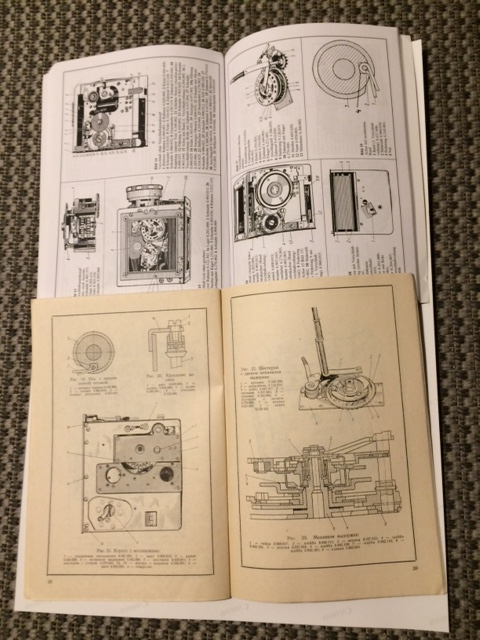

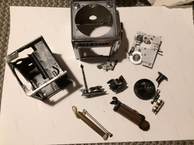

Look I have this Salyut on my to-do list, I have also the official booklet with extensive diagrams and descriptions of procedures, (for the Kiev-80 ie. Salyut-S variant, basically the same), a booklet with repair Q&A also with good technical drawings, by a german engineer who collaborated with Arsenal on this in the 90's, and there's the short and nice explanations of Steve Ash floating on the net. I could send the whole to you. You have everything, put it back together, functional and with correct shutter times and come back tell us about it :D
