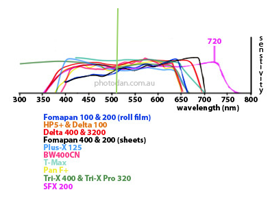

This is a scaled composite of the spectral sensitivities of FP4, Tri-X and TMX. Based on these curves I'd predict all 4 sensitometers will give useful information about the speed differences between the three.

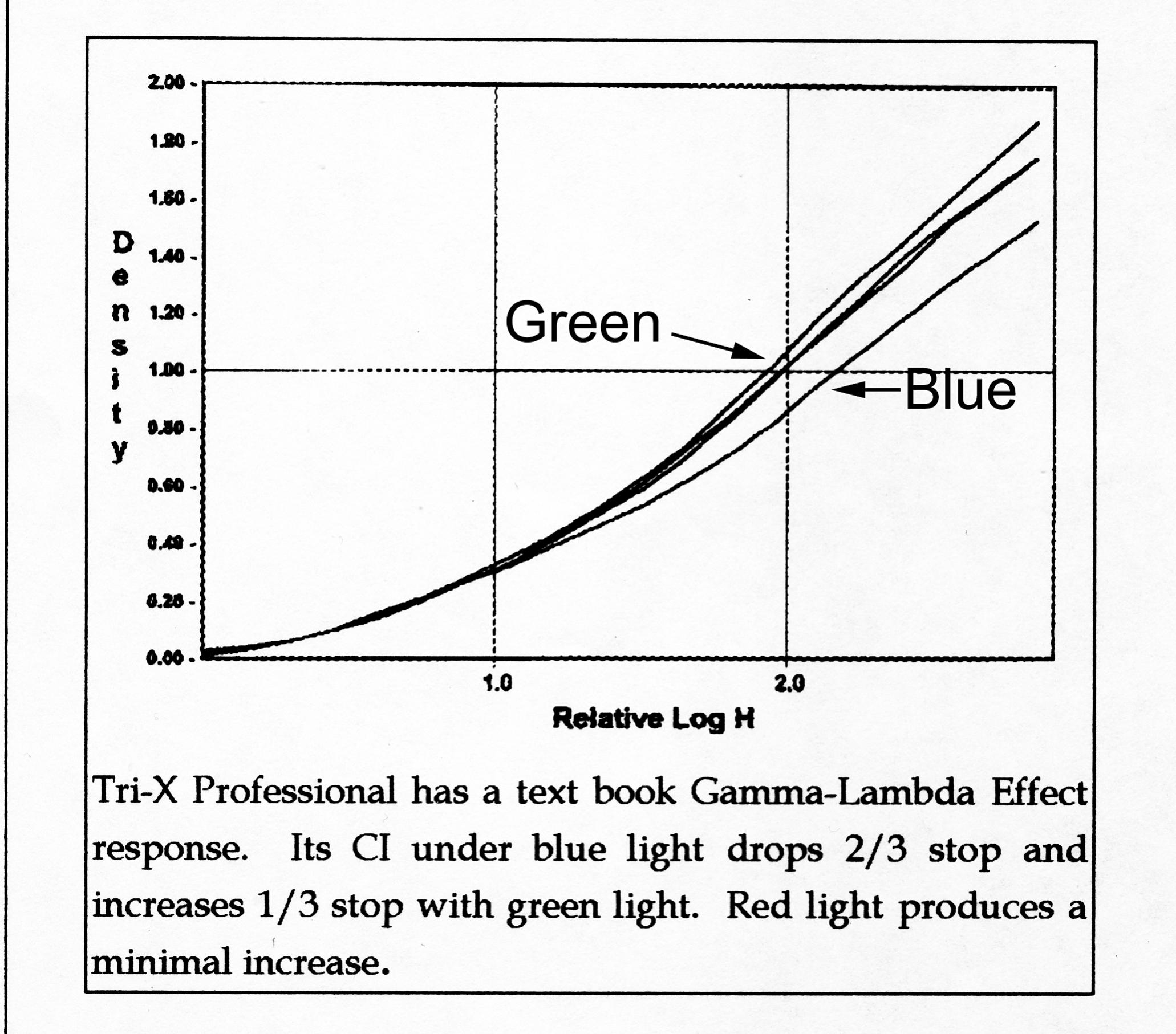

I did some testing of the Gamma-Lambda Effect many years ago. Using an EG&G calibrated sensitometer, I made 4 exposures using a tri-color red, green, and blue filter, and one without any filters. Here's what I found with Tri-X.

Those effects were accounted for by using the same colored light for each of the two comparison exposures during the development/contrast tests.

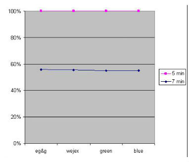

The conclusion "A two minute reduction in development time gave the same change in slope (change in contrast) irrespective of sensitometer"

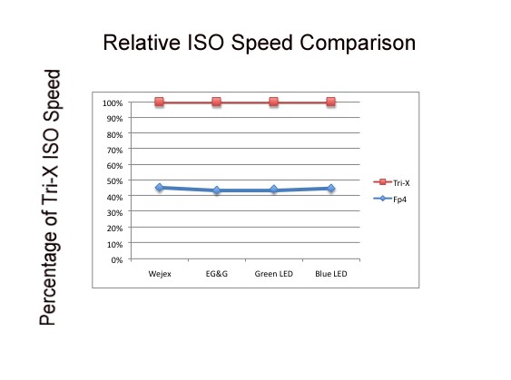

All 4 sensitometers correctly identified FP4 as being the same number of stops slower than Tri-X.

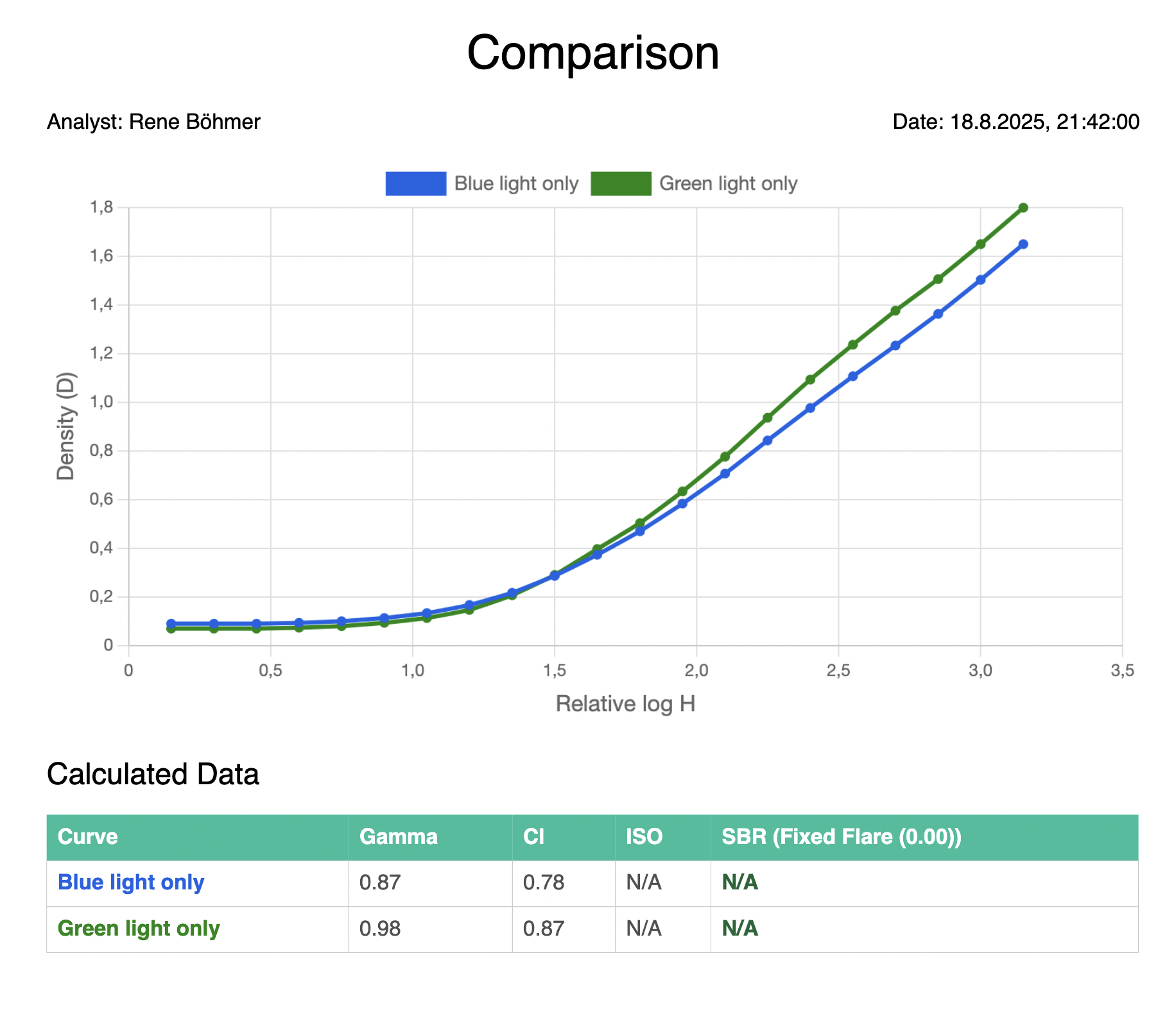

This is a modern example of the gamma lambda effect, I measured today with a SensiX blue-green sensitometer. Film used was Fp4+. It shows the contrast change of the material between green and blue exposure.

Nice.
I haven't tried gamma lambda tests. I believe they are important for color separations, getting gray balance right by developing the blue filtered (yellow plate) separation longer.
And for the sensitometer shoot out they show you that the blue/green sensitometers can be reasonably used for process control, maybe best by using the green filter if you can.

Ok, so I see another image missing from this thread. This spectral sensitiviy composite. With the green marked (as Bill suggested above).
