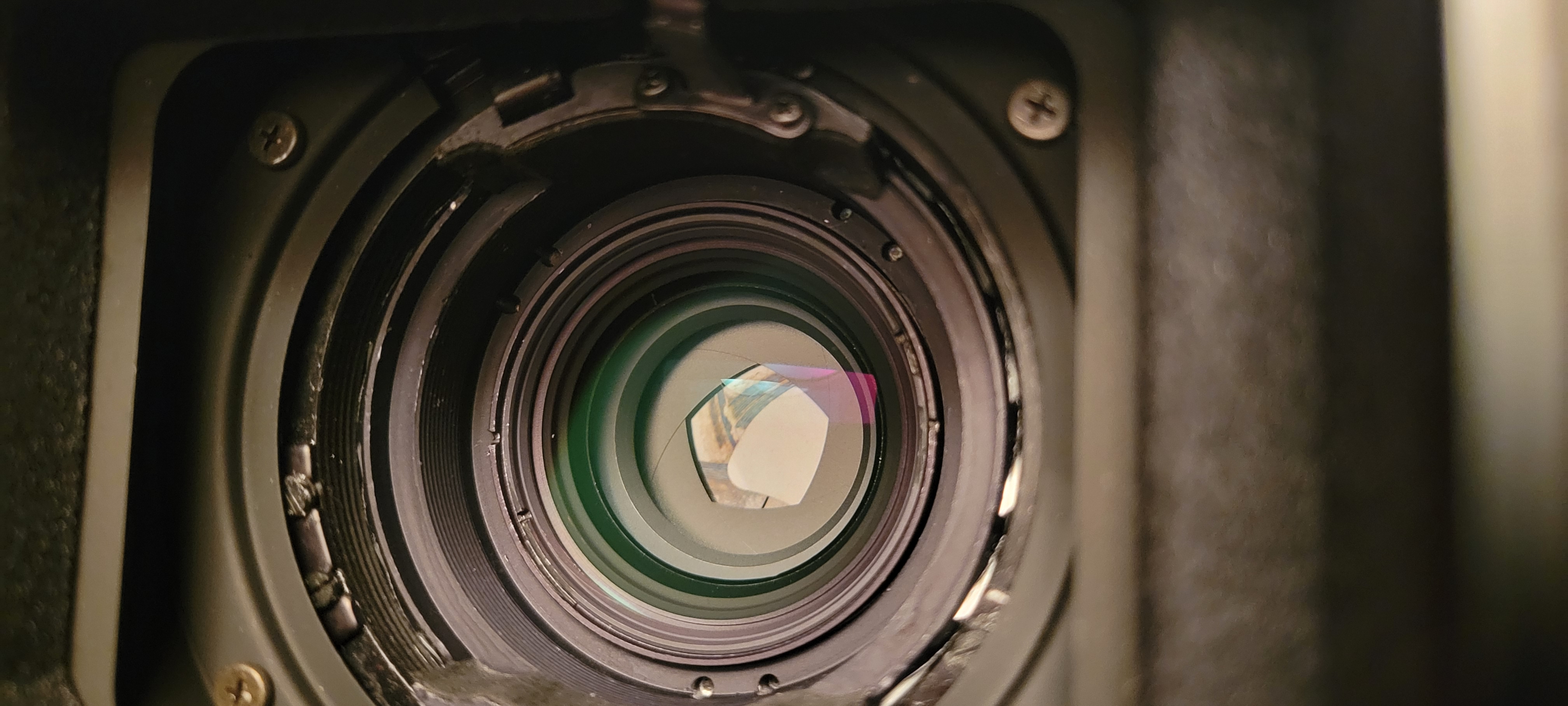

Fuji GW690II- Without film in the camera, you cannot press down the shutter release unless you open the camera back. But, I also notice that with back open, and when depressing the shutter release, looking through the lens, I'm not seeing the aperture open. I hear the snap of the release, but not seeing it open and close.
Question: is this expected behavior?

No, not expected behavior.
Lens cap?
Try different speeds to see if any of them let light through. Best to have aperture wide open just because it makes it easier to be certain.

Cap was removed and I did try with several different speeds. I just purchased and hoping not a problem here. 🙄
I'm going to retest in a bit on each speed and report back here.

Pics below... I'm seeing what looks like oil on the shutter. That would stick the shutter correct?
Otherwise the aperture should open and close on the 690.
Opinions appreciated.
After a few minutes of advancing and hitting shutter release, it looked to start working for about 10 clicks and then seized up again. Notice leafs in shutter in pic below.
I've started ebay proceedings already to return to Japan. Really too bad. It's in beautiful condition aesthetically.

No, I don't think that it's normal. I have a G690 which is different from the GW690, so I don't want to utter certainties. The paper is a good way to check operation and I try to do that with every 120 camera I get, or to test loading if I haven't used a camera for a while, since they are all a little different.
The shutter should fire when the back is open. It does on the iii version. And yes such residues (pic no1) can cause the shutter to stick. I had a few lenses with similar deposits which caused the shutter to fire with a slight delay. I was able to clean it but access was much simpler than on the GW690. Sorry for the issues! It's unfortunate that the seller didn't catch it.
