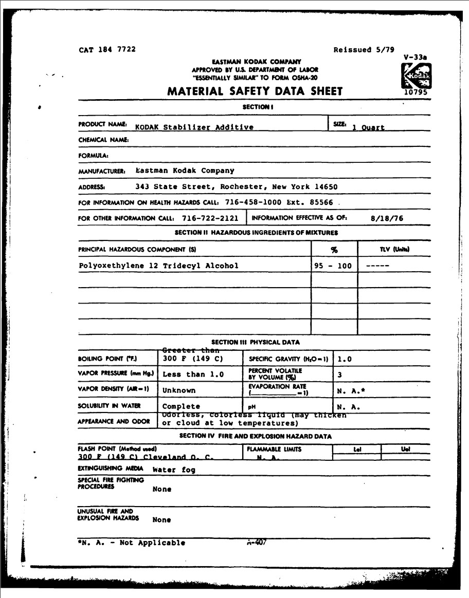

How about ECN-2 film? Kodak does prescribe a stabilizer (Kodak Stabilizer Additive) in final rinse, but adds that in case of biological growth Proxel GXL may be added. This suggests that Kodak stabilizer additive is not formaldehyde-based and its role is only to protect dyes against reaction with colour couplers.
Photo Engineer wrote in the beginning that only recent C-41 films received a treatment against dye-coupler reaction, so I guess a stabilizer is a must in ECN-2, too (if longevity of the negative is needed).
Also I wonder if cross process of C-41 film with CD-3 based developer affects their dye stability. After all CD-3 creates slightly different molecule with a colour coupler than CD-4 does...
I am not a chemist, so I don't know the answer to most of these questions.
What I do know is that none of the ingredients in the prebath, developer, stop, bleach, or fix in my DIY ECN-2 chemistry are on my personal list of known stabilizing agents. Since I have photo flow/formalin stabilizer mixed up already for E6, I just put my ECN-2 films in there before hanging to dry. So far it has not hurt anything, and if indeed it acts as a color stabilizer and anti-biological-growth agent as well, all the better. If nothing else I have the effect of the photo flo working in my favor :smile:
This "Kodak Stabilizer Additive" component is not actually a stabilizer, but a surfactant like Photo-Flo 200. Also, the remark about Proxel GXL apparently refers not to the film, but to the specific baths where it is listed when the chemistry sits in the drums.
Thanks for explanation. So it would mean that Kodak Vision films are inherently stable without need for a stabilizer.
