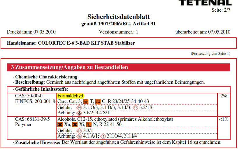

I'm aware of many threads about chemical toxicity, which is not really the point of this message.
Developer, stop and blix are rinsed, so properly used, I'm not concerned about them.
But stabilizer should not be removed from the film. It stays on it, and once dried, you handle the negatives unaware of it.
Does the stabilizer remain on the film? does it suppose any risk if unhandled properly? For example, when used for enlarging, or scanning.
I read that stabilizers are quite nasty for health (but don't know if they are formaldehyde-based ones, or all of them). I haven't find formaldehyde in the Tetenal kit MSDS (but not being an expert, I don't know many othe its ingredients, which may be similar).
Thanks!
Slide/reversal film (E6-development) still requires formalin as had been stated in a myriad of posts on this site. Considering the miniscule amounts retained in/on the developed film, and as one normally would not eat the developed films, well, I can't imagine any health issues (possibly except for hyper-allergic issues, though I've never heard of regarding the developed films).
The health warnings on chemistry apply to the packeged product, not the developed film.
The Tetenal Colortec E6-kit has formalin in the final stabiliser bath:
The formalin reacts with the gelatin and residual couplers and is therefore rendered harmless. This takes place during drying.
PE
