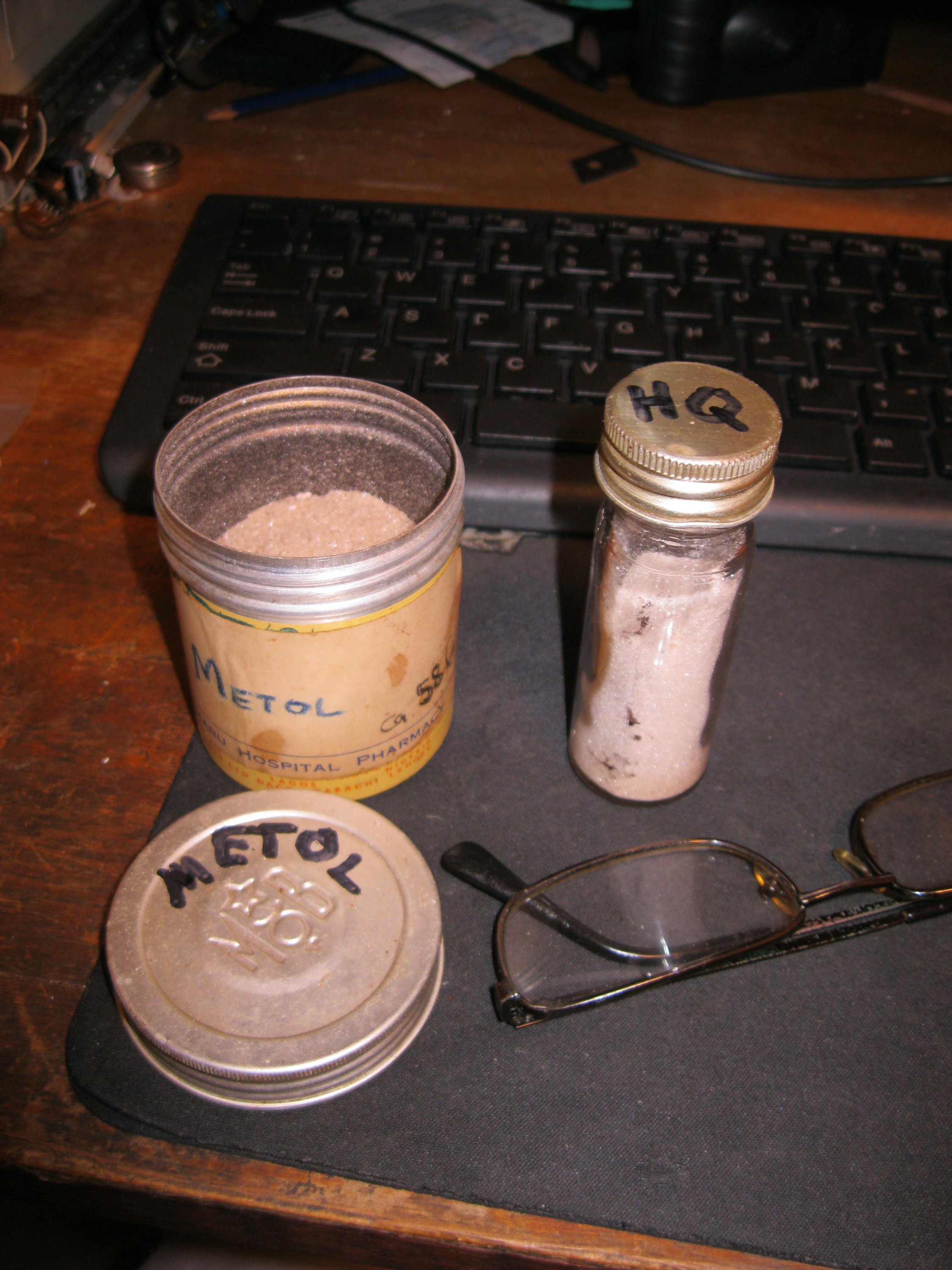

Murray Kelly
Jan 31, 2007
661
Brisbane, Australia
Sub 35mm
Metol and HQ liberated from the lab in 1957. Last 10 years in freezer.
