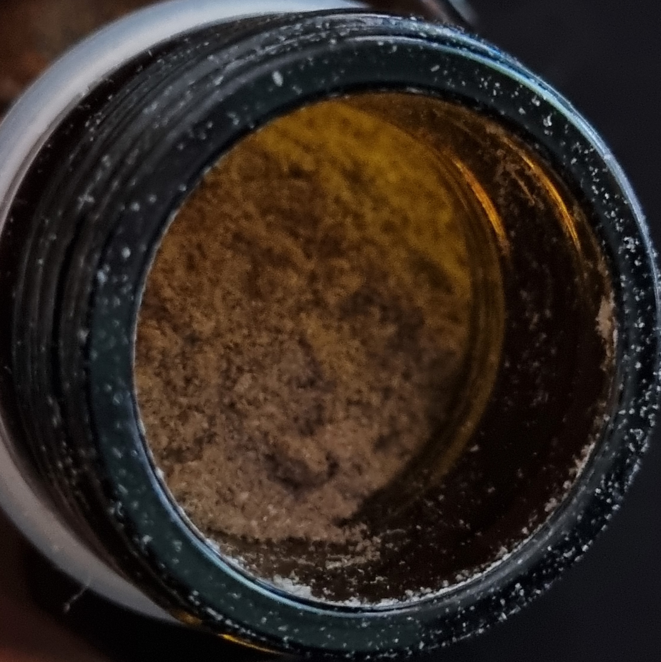

Hi,
this is the first time that I play mixing a developer from raw chemicals. I bought a 50g container of metol (produced by Bellini) from an online shop in UK and the colour is a grey-ish brown. I had seen a few videos online of people mixing up D23 and the colour of metol seemed white (like sugar).
I have now made a 500ml batch of D23 (which has a pale grey tint) to test it in a few hours after it cools down, but I am curious if this is expected or a sign that this metol could be subpar, or even gone bad?

I guess my surprise comes from seeing this color from an unopened container which is just coming from a shop.

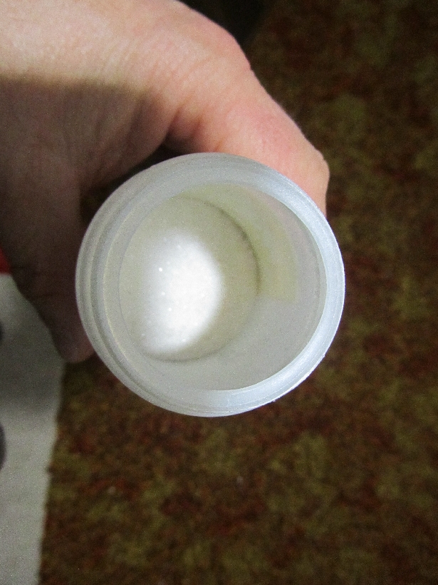

This is metol I purchased in 2006 and opened in 2016. Its 15 years old. It still looks almost brand new. In the 25-30 years I've mixed my own I've never seen it turn brown. While I might use discolored metol if I had it laying around, but I would never accept it purchased new that way. I'd return it in a heartbeat.
YMMV. Some people drink milk long past the due date. I can taste it going bad even before then.

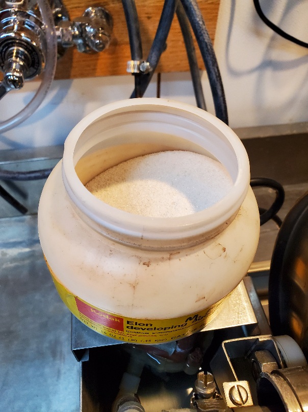

When Kodak made Elon (metol) and hydroquinone it was white crystalline free flowing material. It was packaged in squat wide mouth plastic containers that made it easy to scoop out of. I have a bottle of each I bought in the early 70's during a D23 craze. This material is slightly discolored.
I had a bottle of Glycin that turned to black brown mass. Totally unusable. The material in the picture looks like old, or lousy metol.

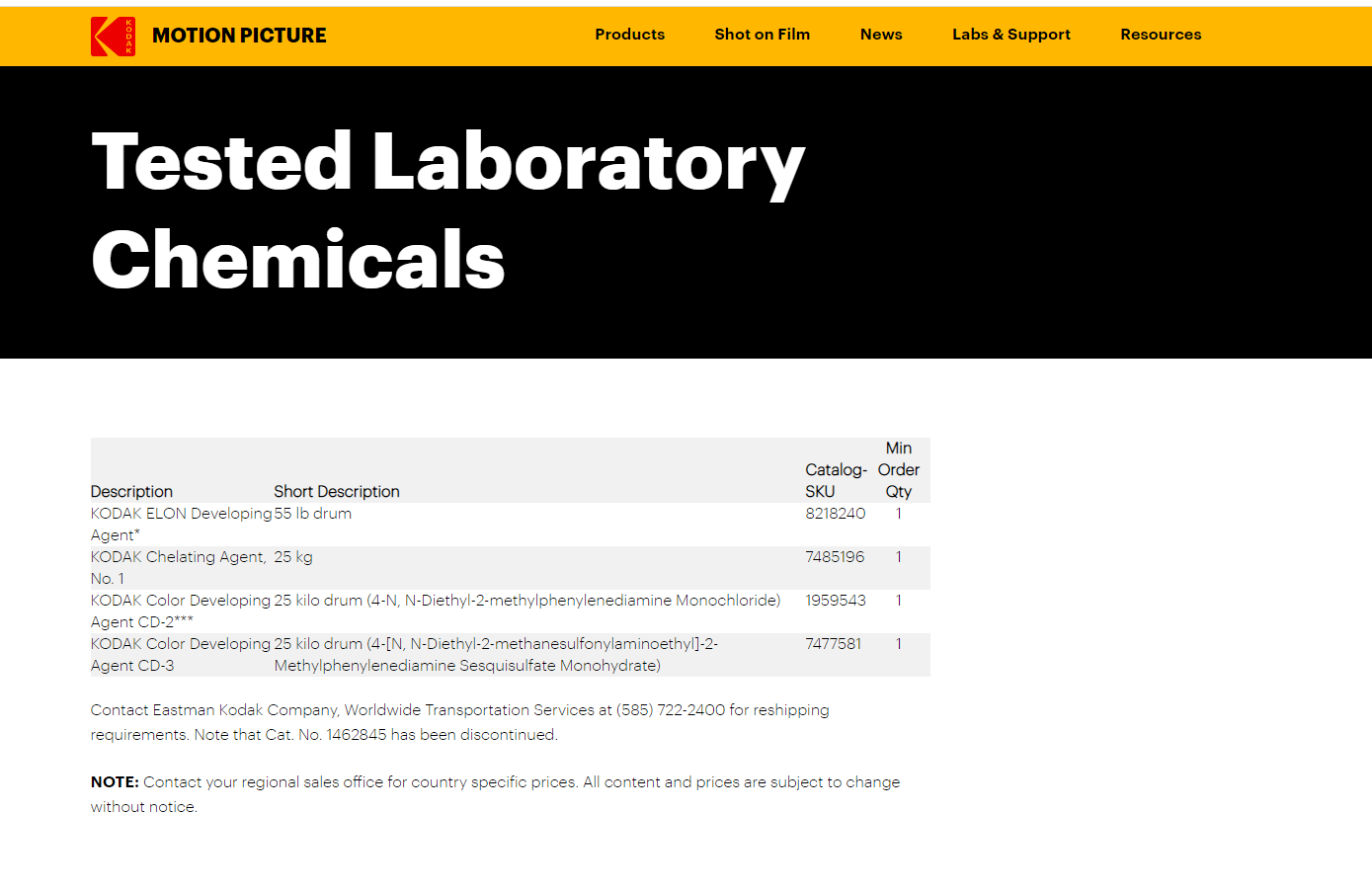

They still make some of them - just not in the sort of quantities you might want:
https://www.kodak.com/en/motion/page/tested-laboratory-chemicals
I've seen a person on Ebay selling small quantities out of these big containers. I wonder how old the material that EK is selling, clearly it is very high quality and keeps for decades.
It is sold mostly to the motion picture lab industry, so it is probably current.
