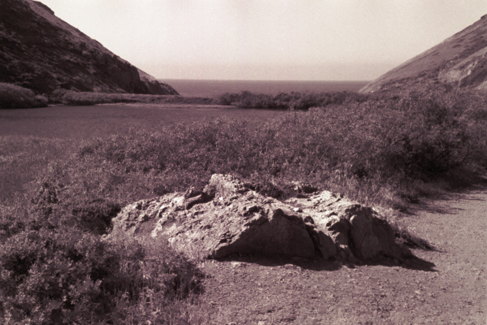

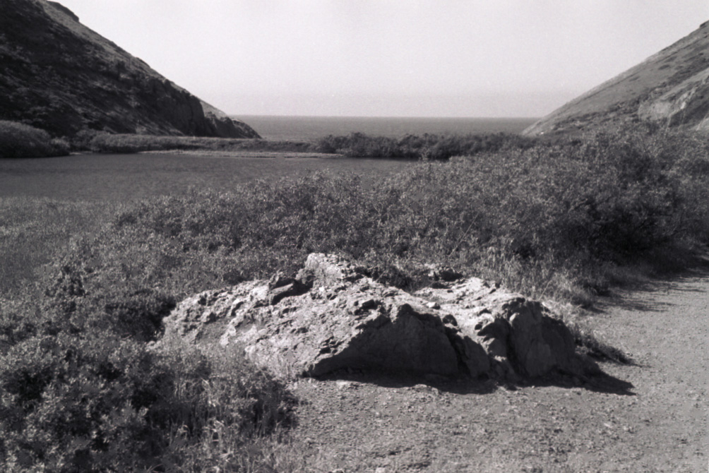

Well, it depends. You could get dozens of combinations. I use Silverfast on my scanners and there are many film combinations and setting like CCR (Color Cast Removal) on or off which can be selected. Also the base colour cast of the film itself will alter results of course.
I find occasionally tweaking the settings while scanning in color I can get a nice pseudo sepia or selenium tone, but by and large I usually just scan in B&W with the CCR switched on. I find using the Ilford Pan F film choice regardless of B&W film being scanned gives me a good first scan with the level of detail and contrast I can work with thereafter. A few examples below of TMX 100 film in 35mm showing the Silverfast film choice and whether scanned in color and with or without CCR on. I could go on for hours :smile:
Fuji NPH in color no CCR.jpg Fuji NPH in color with CCR.jpg Kodak TMX100 in BW with CCR.jpg Kodak TMX100 in color no CCR.jpg
Edit: I noticed the filenames don't appear anywhere.
1. Color scan no CCR film selection Fuji NPH
2. As above with CCR on
4. Color scan no CCR film selection Kodak TMX 100
3. As above B&W scan with CCR on

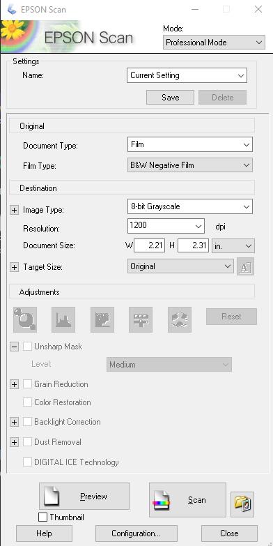

Epsonscan in professional mode with default settings clips the Black and White ends of the Histogram to give a "pretty picture" plus it has Unsharp Mask selected and resets to default settings each time a Preview is done.
Silverfast SE scans in 16 bit but outputs in 8 bit.
Both scan programs ship with the V800.

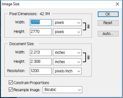

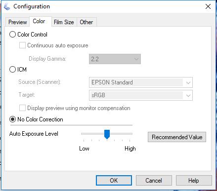

Epson scan settings box , clicking on the Configuration box at the bottom of the page opens some more control options. On the color tab selecting No Color Correction turns off all adjustments, the Auto Exposure Level has little to no effect on the scan. In PS Under the Image Tab is the resize option, other software should be similar.
These 4 scans of the same image were done at the settings shown in post 39 starting with 8 bit grayscale, then 16 bit grayscale, 24 bit RGB, and finally 48 bit RGB. There was a nasty under the scan glass dust mark in the sky on the right side that I removed with the clone stamp tool. The levels were adjusted in the highlights from 255 to 150 and the black from 0 to 2. The negative could have benefited from additional development but for camera testing after repair box speed and published times by the film manufacturer are used as are marked shutter speeds.
The image size was reduced to 2048 pixels on the long side then the resolution was reduced to 600 dpi as the 1200 dpi scan size was too large for the site.

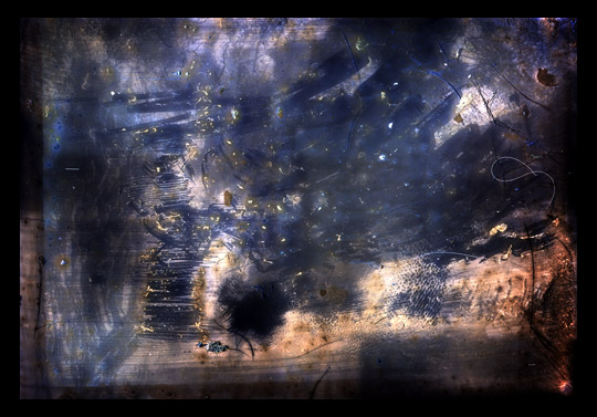

hi frank53
ii don't mind showing you why i like scanning in color
first of all, i don't really care how big the file size is, i have enough storage space
that a few extra MB is nothing, here are a couple links and a file
https://www.photrio.com/forum/media/federal-building-s-from-bacon-hill.58201/
https://www.photrio.com/forum/media/spring.58182/
both taken with regular old black and white film, both processed in a caffenol mixture ive been using for around 5-10 years
and split processed with ansco130, a developer i have been using for the most part since around 2001 ..
tonality and colors being pickedup by the stain in the developer. i just used levels ...
also
not sure if you can see it or not but its a 8x10 glass plate i coated with emulsion 35 yeras ago,
left in the sun and then scanned 2 hours later
colors and tonality i couldn't even imagine being trapped in the image just comes to life
(green, blue red gold, yellow & black and white )
with pretty much a straight scan / barely any burning or dodging, hue manipulation, over the top saturation,
( for the most part its just contrast and brightness) .
have fun!
View attachment 207211 View attachment 207212 View attachment 207213 View attachment 207214
Thanks for taking the time to provide this test result. I don;t see any real difference between them. I haven't noticed any differences on my own BW vs. color scans of Tmax 100 on a V600 with Epsonscan flat. RGB has no meaning to a BW photo. Now, scanning a color film in color and them adjusting each of the colors to change the tones works really nice when converting to BW. But you have the color spectrum in color film that's not there in BW film. There is no RGB in BW film.
