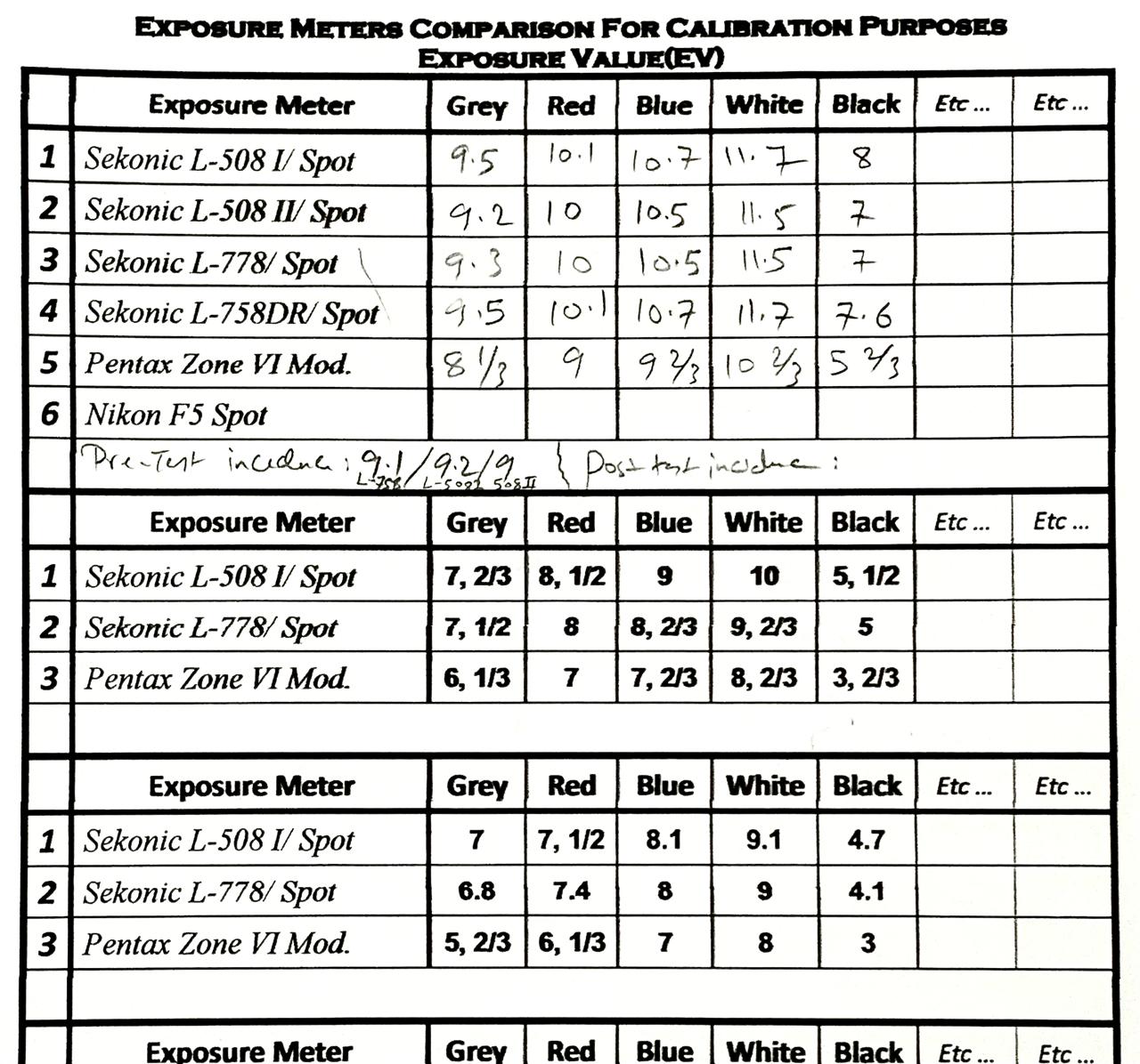

That much of discrepancy?
Standard spot meters Vs the Zone VI modified digital Pentax spot!
Photos attached for EV comparison.
Could the modified Pentax spot meter, correctly be in average 1.5 EV or more( range: 1 ~ 1.8 EV ), lower than standard meters, and still considered accurate?
Borrowed other meters, the gap could not be better.
AFAIK, the setup(photos) is ideal for a correct methodology & measurement from each meter and for the conclusion later.
I may add more readings later for comparison.
Please let me know?
I think the Zone VI modified digital Pentax spot, is not working properly!
Thanks indeed for any input.

The concern now is,
in the context of the 4 spot meters, and
of course assuming the modified Pentax has linear response, no light spectral variations!
How much of EV correction should be adopted to bring the modified Pentax meter in the area of being acceptably precise tool to go alone for zone system approach photography?
The added series of reading(hand written, attached photo) is taken in a constant indirect daylight(same setup as in post 1).
Most of the meters belongs to photographers from different cities.
Tried multiple time to bring another set of readings in direct constant sun light, but failed due to clouds every day.
BTW, the post-test incident light metering at the site of setup, was within 0.2 EV from the incident metering of the pre-test.
You don't really need to do any modification, the Zone system is about standardisation where you make your own accuracy, and if you do your initial exposure tests with the Pentax meter, to establish zone V etc., your workflow will be accurate. So the precision you look for is repeatability. Admittedly using another meter won't work but given every meter has it's own quirks (response, metering angle, etc.) you shouldn't be swapping meters anyway unless you do the tests all over again.

alentine - the as-is Pentax meters are tightly calibrated to specific industry standards. They have been widely used in the Hollywood film industry, in TV studios, in professional photographic studios, and of course, by many of us in the field.
They don't need to be "corrected" for the Zone System. They already read more precisely than mere Zone segments.
By comparison the Zone System is like a rubber band that can be stretched all kinds of ways, and these spot meters are more than adequate for that kind of application. Zone V is simply the central triangle reading on the meter, based on comparison readings of your shadows and highlights to determine their placement, higher and lower, on the dial scale. The basic rule for the Zone System is, "Expose for the shadows, develop for the highlights".
I really wouldn't get hung about about the alleged need for a modified meter for specifically ZS work. That's snake oil mythology. If someone gives you a modified meter, or you find an extremely good deal on one, fine, go ahead and use it.
I'd personally rather have unmodified Pentax meters which all match one another right out of the box from the factory,
all calibrated to a very specific industry standard for sake of ongoing consistency.
