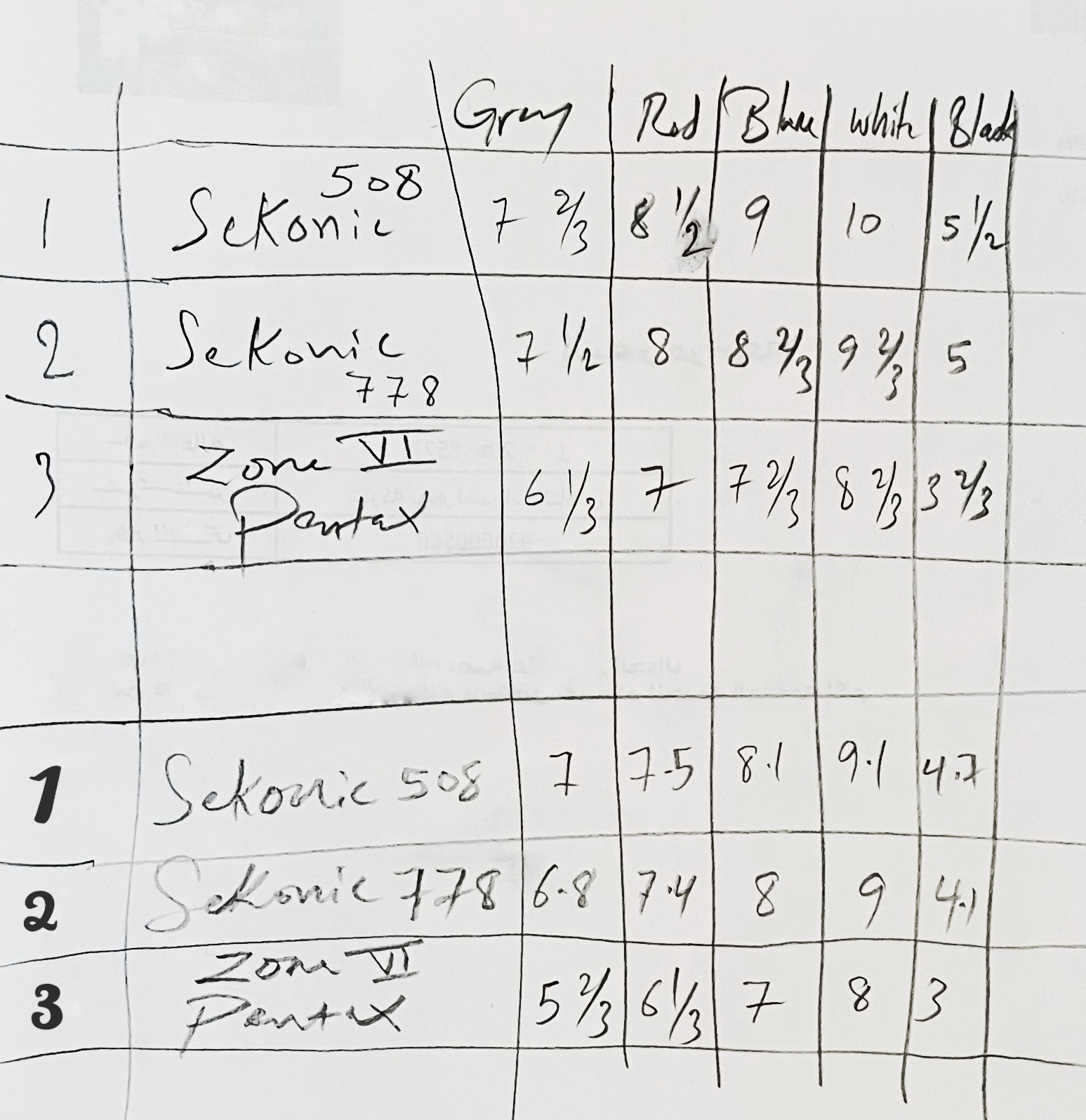

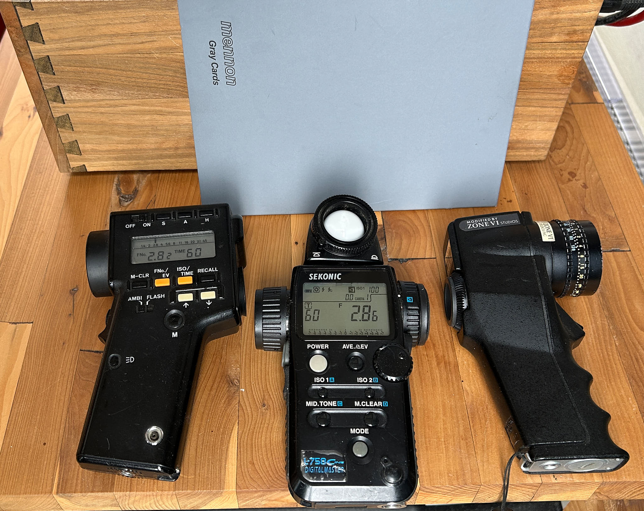

That much of discrepancy?
Standard spot meters Vs the Zone VI modified digital Pentax spot!
Photos attached for EV comparison.
Could the modified Pentax spot meter, correctly be in average 1.5 EV or more( range: 1 ~ 1.8 EV ), lower than standard meters, and still considered accurate?
Borrowed other meters, the gap could not be better.
AFAIK, the setup(photos) is ideal for a correct methodology & measurement from each meter and for the conclusion later.
I may add more readings later for comparison.
Please let me know?
I think the Zone VI modified digital Pentax spot, is not working properly!
Thanks indeed for any input.

I may have missed it, but there are two sets of measurements for each meter. The second set is 2/3 to 1 stop lower overall across all meters. How did you arrive at these measurements?

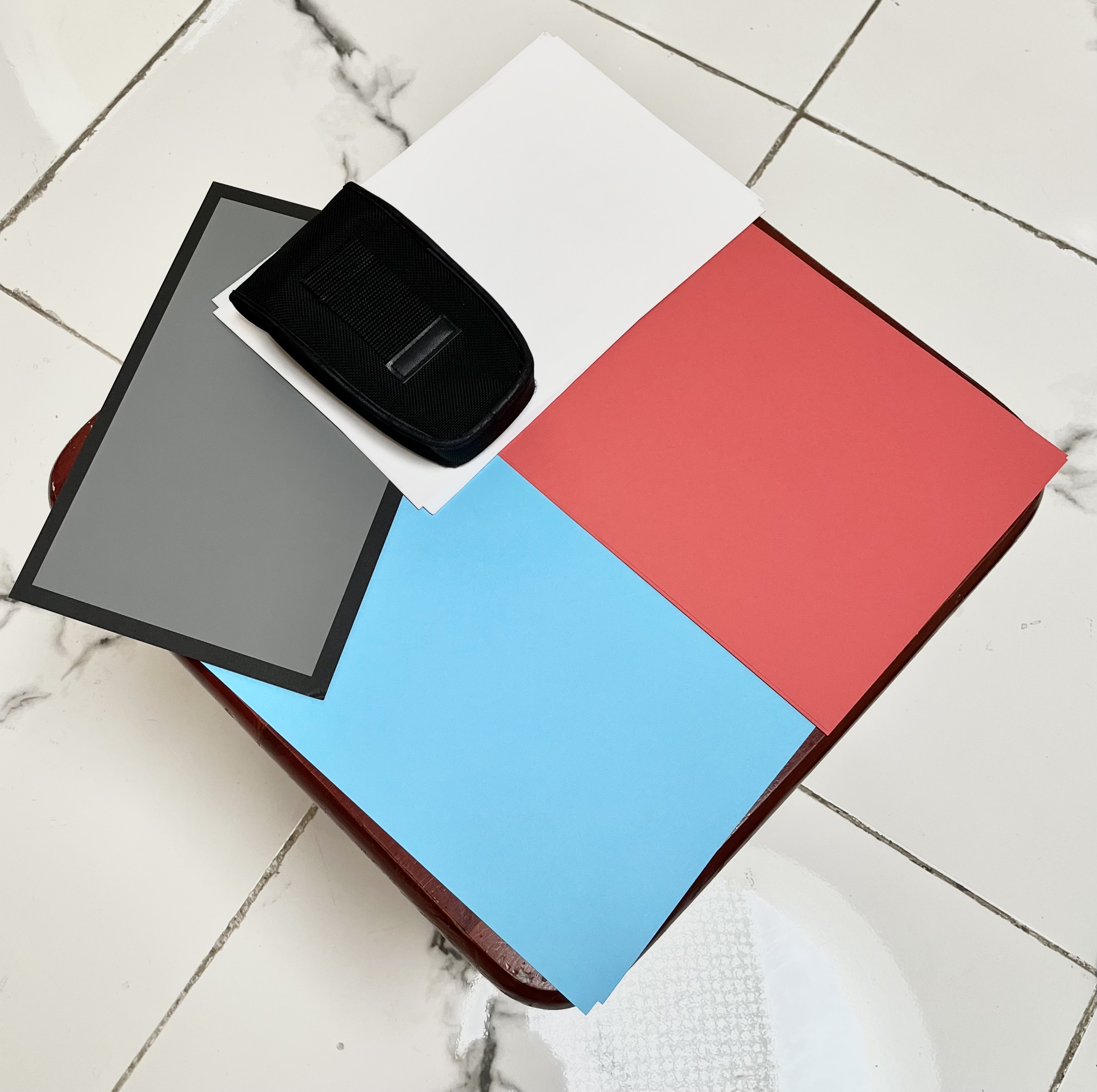

the setup(photos)
I see a couple of cards, but no metering setup. What light source? Distance between metering target and meter? Possible influence of flare, UV?

That should not affect the comparison itself, because any confounder variable should affect all 3 meters readings, while the standard meters agreeing with each other, for both sets of readings, the modified Pentax is out of the herd in each set of reading.
My apologies did not add measuring environment.
Constant indirect day light, measuring from 1.8meter, full battery each meter. The size of each target is almost A4 paper size except for black which in fact the manufacturer bag of L-508 sekonic.
I understand that the Zone VI meter has modified spectral response so it would read differently with the standard meter if the subject or light source color are different. However, the amount of differences are too great.
I believe the Pentax Zone VI is wrong.

They measure within 0.4 stop on the grey card.
In the measurements, the Pentax meter is consistently 1 1/3 stop low. You can just set the film speed 1 1/3 stops low on the Pentax and use it as usual. Or, the right calibration pot can be twiddled - however there is a danger that things get even worse.
The experiment should be repeated in sunlight, cloudy light, bright interior, dim interior to verify the discrepancy holds across varying light levels. There is no need to bother with colored squares, an 18% grey card would be sufficient.
