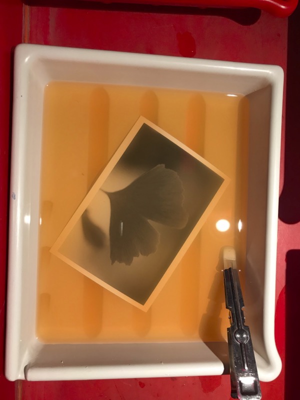

I am maybe 15 prints into a bottle of Tetenal Gold Toner and this has happened:
I will try to heat it and dilute the precipitate again. From my count, there should be quite some prints left before exhaustion.
Edit / FYI: I had the pic in the tray and poured the toner directly from the bottle.
Heating and stirring will not help. I have heated the orange toner to 60 C an stirred for an hour, no result at all.
The toner goes orange/brown due to some extremely fine precipitate, i.e. the substance causing the colour is not dissolved but a solid. It also accumulates over time at the bottom of the bottle.
Tetenal Gold Toner according to the data available is a "classic" gold toner containing goldchloride and hypo as main ingredients. I suspect (wild guess only !!!!!) the hypo has gone bad freeing up sulfur. So probably some gold (iii) sulphide has formed, which will not dissolve in water any more. Gold (iii) sulphide according to wikipedia is brown, maybe very small particles dispersed in a rather big amount of water can look orange/rusty/brownish.
It does not tone any more and will not dissolve, so silver recovery: here we got some gold for you!!!!
