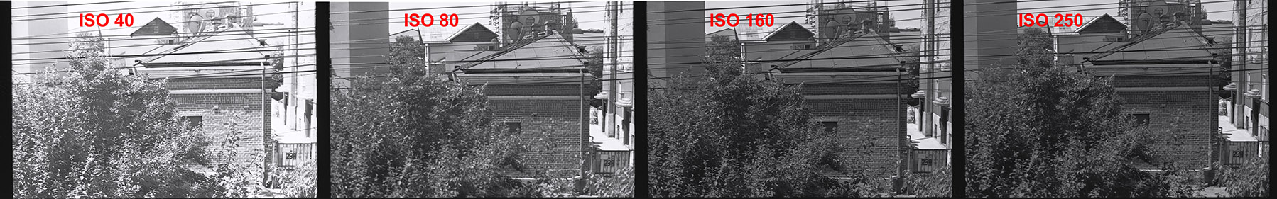

Tests on Agfa Aviphot Pan 200 and 80 films.
In test 405 Agfa Aviphot Pan 200 I exposed in wedge (250, 160, 400 and 640 ISO) and scanned as a single photogram.
https://www.flickr.com/photos/21121448@N06/37505363894/in/dateposted-public/
In test 405 Agfa Aviphot Pan 80 I exposed in wedge (40, 80, 160 and 250 ISO) and I scanned as a single photogram.
https://www.flickr.com/photos/21121448@N06/37505314164/in/dateposted-public/
The resolution on the Aviphot Pan 80 image is impressive, but the contrast is rather high.

Thanks for these pictures. It suggests to me that each film has about the stated box speed. I get confused about the connection if any with Rollei films but there appears to be a suggestion that both Rollei 80 and 400 are in effect the same film and both are Aviphot 200 or maybe the suggestion is that Rollei 80 is Aviphot Pan 80 and Rollei 400 is Aviphot 200.
The latter explanation may be possible as if they are based on Aviphot Pan films then Rollei 80 and 400 are not the same film based on your tests. If Aviphot 200 is Rollei 400 then it certainly looks as if you could claim a 400 speed and I for one would probably not challenge you.

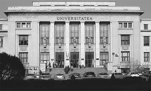

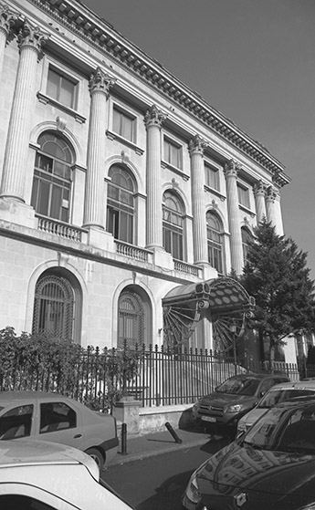

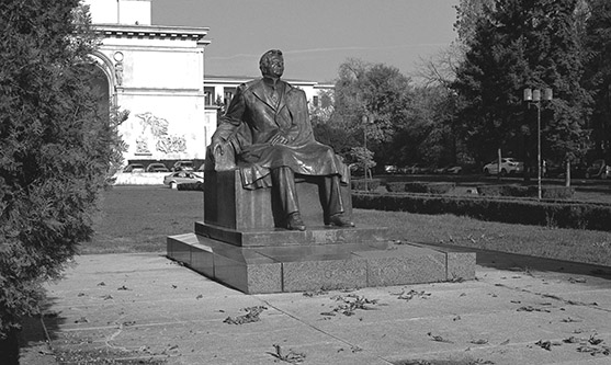

Same pictures taken on Agfa Aviphot Pan 80.
George
