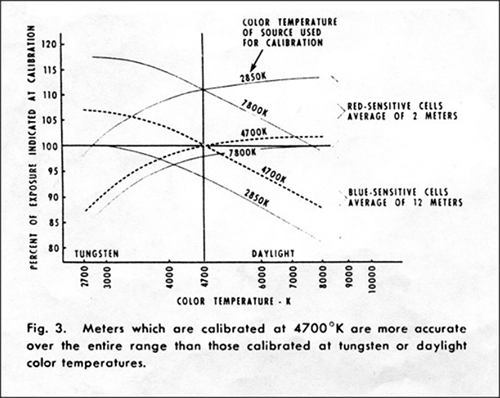

This is from Stimson, Allen, An Interpretation of Current Exposure Meter Technology, Photographic Science nd Engineering, Vol 6, Number 1, Jan-Feb 1962.
One of the more telling statements from the paper is "Among other innovations, meters will henceforth be calibrated at 4700 K instead of 2700 K to make them more accurate in daylight and eliminate the need of different tungsten speeds for most panchromatic materials." There was a period where films would have two exposure indexes: one for daylight, and one for tungsten. The change in the color temperature for calibration, split the difference between daylight and incandescence, it made neither absolutely precise and the degree depended on the spectral sensitivity of the meter's photo cell.

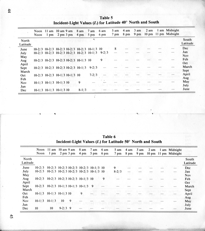

Don't forget Illuminance changes with the time of day, season, and latitude. Here's a page from the ANSI Exposure Guide.
