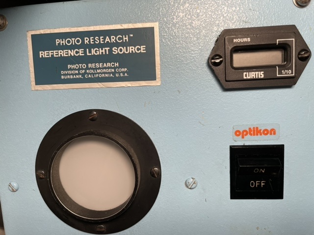

One of these. There’s two like it on eBay one is less than $75 free shipping, the other is like mine with the timer jimmied for about $100
How do you know the light is still calibrated? Don;t they get dimmer too.
The number of hours is reasonably low. The bulb is “under driven” and power on is slow. I haven’t relied on it to calibrate meters. Instead I use it to verify meters and it’s been working for that.
