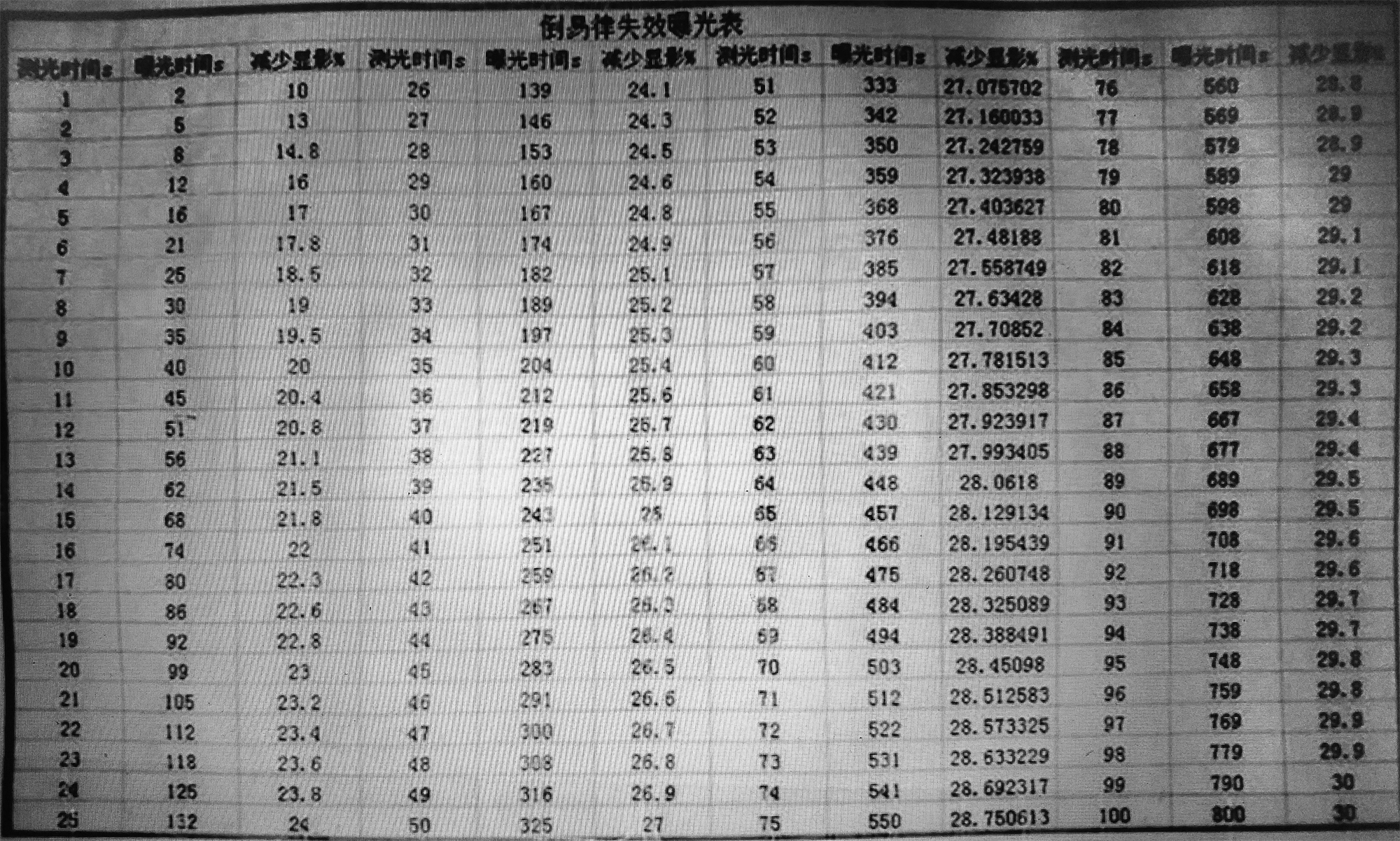

Here is a chart that I have been using for a few years. It's in Chinese but it's not difficult...The first three columns show: metred time; compensated time; reduction of development time. The chart goes from 1 second to 100. I have it on my phone for reference. It's right up there with the worst reciprocity characteristics of any film that I have used...but that doesn't stop me from using this film as it is quite nice.

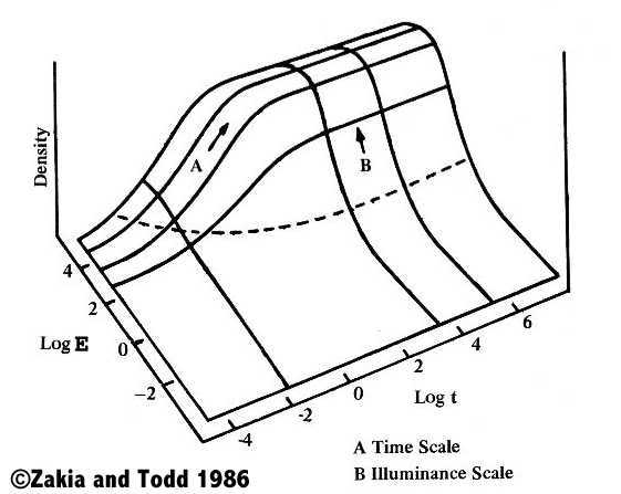

But wow what studies have been done and what ways to present the data! I like the 3-D model IX-racer posted earlier.
The simplest presentation of results though, are the charts giving advice to adjust exposure and development for different exposure times.

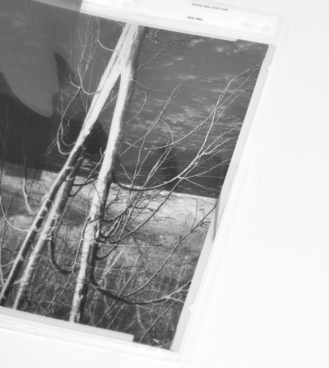

My last batch of Shanghai had some pieces with notches at both corners. My images came out fine, exposed through the back of the film, they were just backwards.
Here is one for the text book: I just did a quick test with two sheets of 4x5, one with the notch down (as per the instructions) and one with the notch up (the usual convention for Kodak and Ilford). Guess what: the instructions are wrong, I've been exposing through the back of the film. Luckily only half a dozen sheets so far.
So for the record, the notch for Shanghai sheet film is the same as Kodak and Ilford. The instructions provided with the film are incorrect.
I realize it's been about a year and a half since your post was made, but can you comment more on the meaning of the third column in the table? You said it gives the reduction of development time, but what exactly does the number mean? Is it the percent reduction in development time?
% in reduction of your normal development time.
