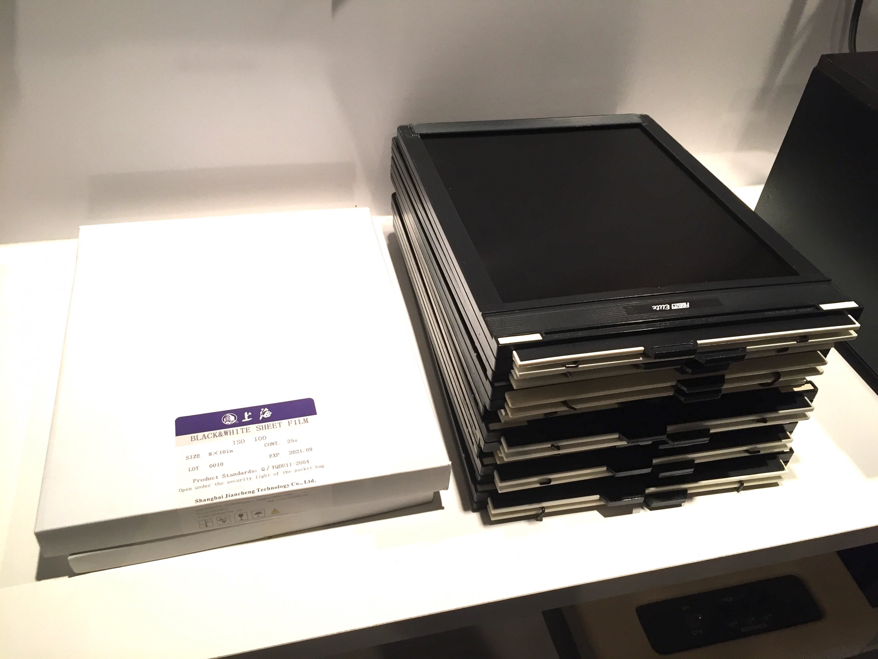

I have never used Shanghai film, so before I load it into the film holders, I'll test it for its sensitivity to light and development.
I use HP5 almost daily, so Ilford HP5 will be the comparison film.

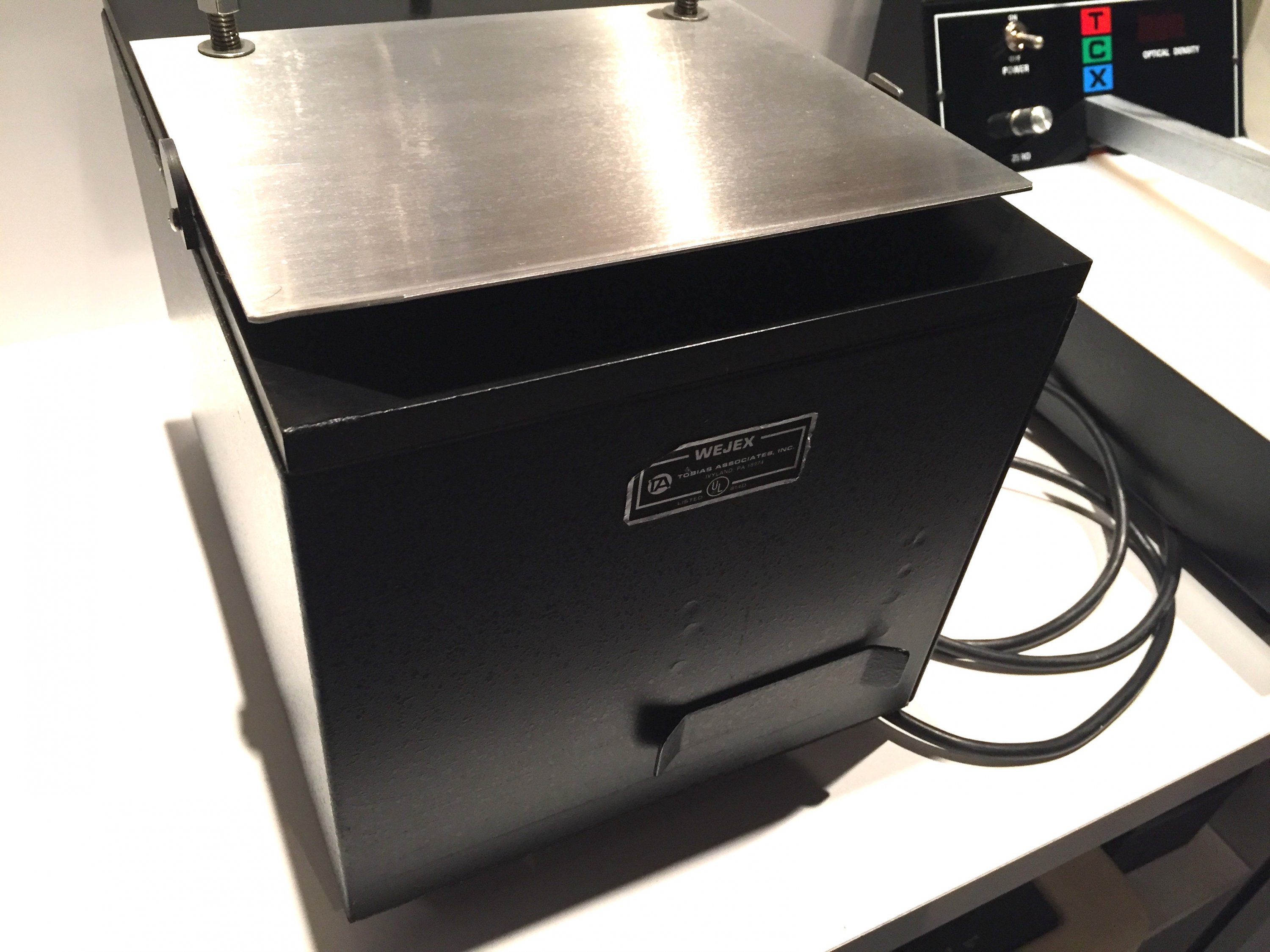

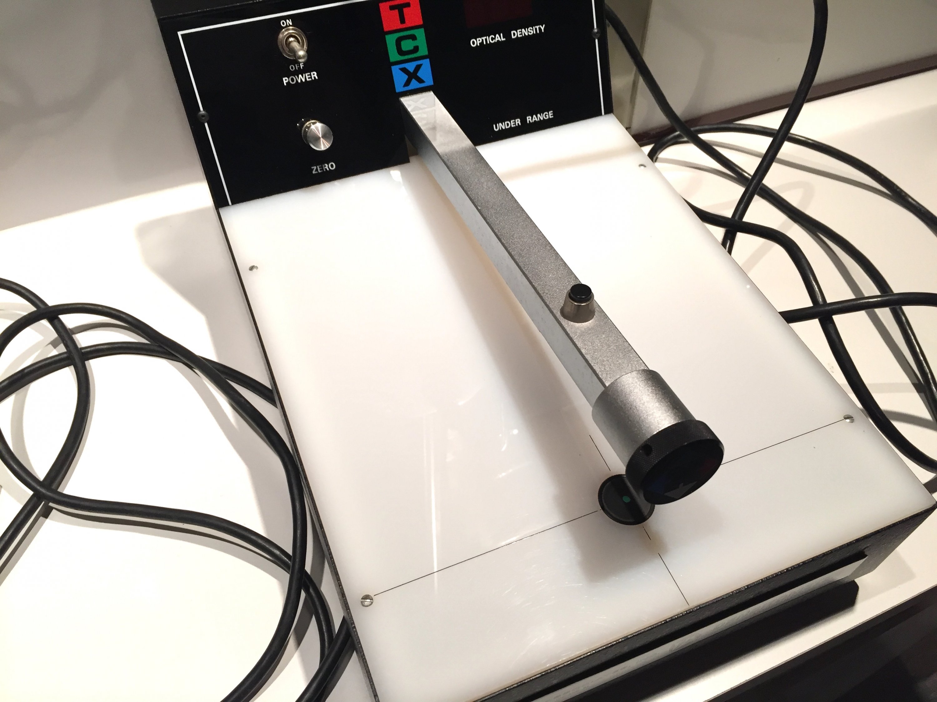

I'll use a Wejex Sensitometer (by Tobias) and Tobias Densitometer pair for the test.

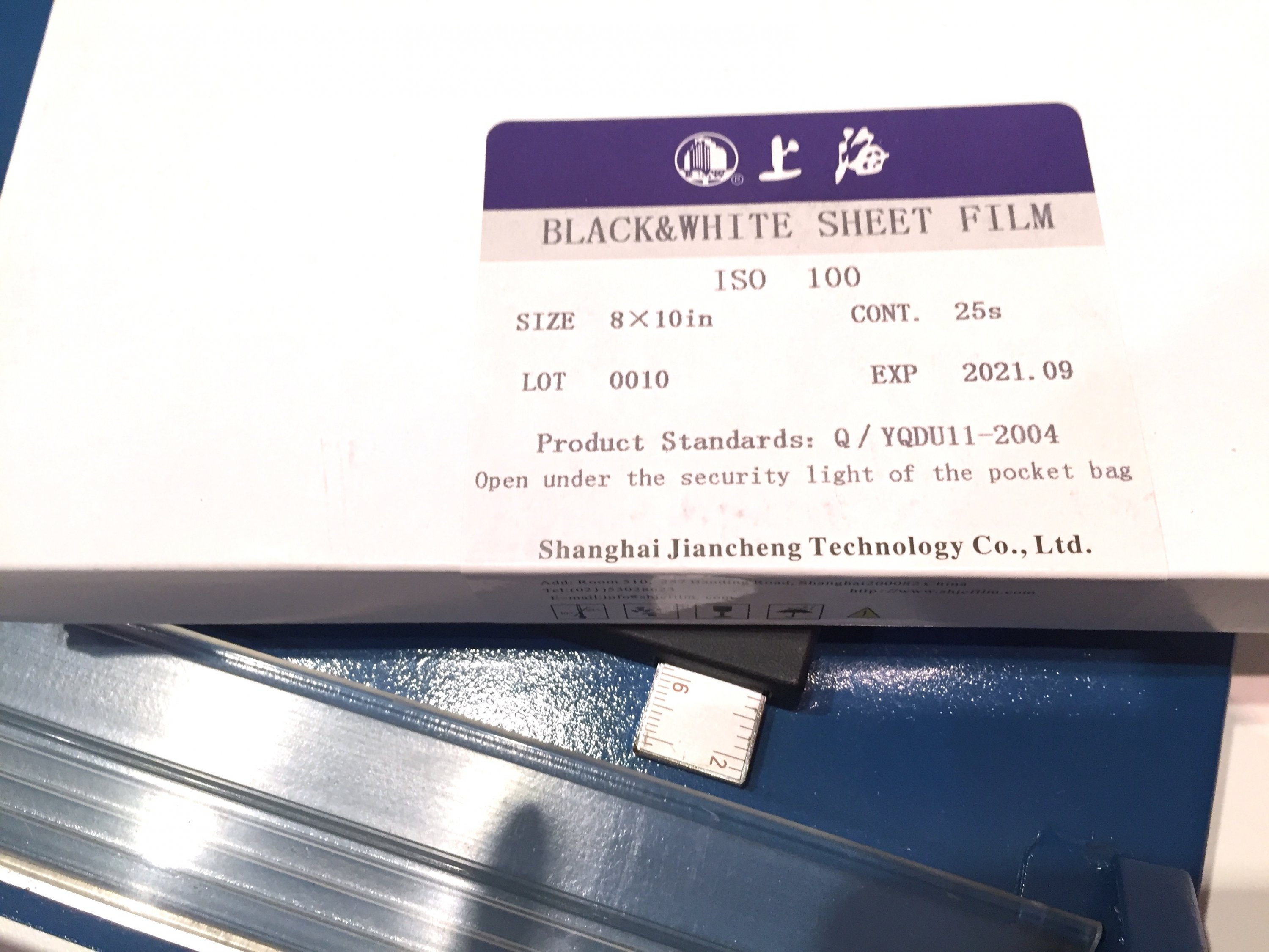

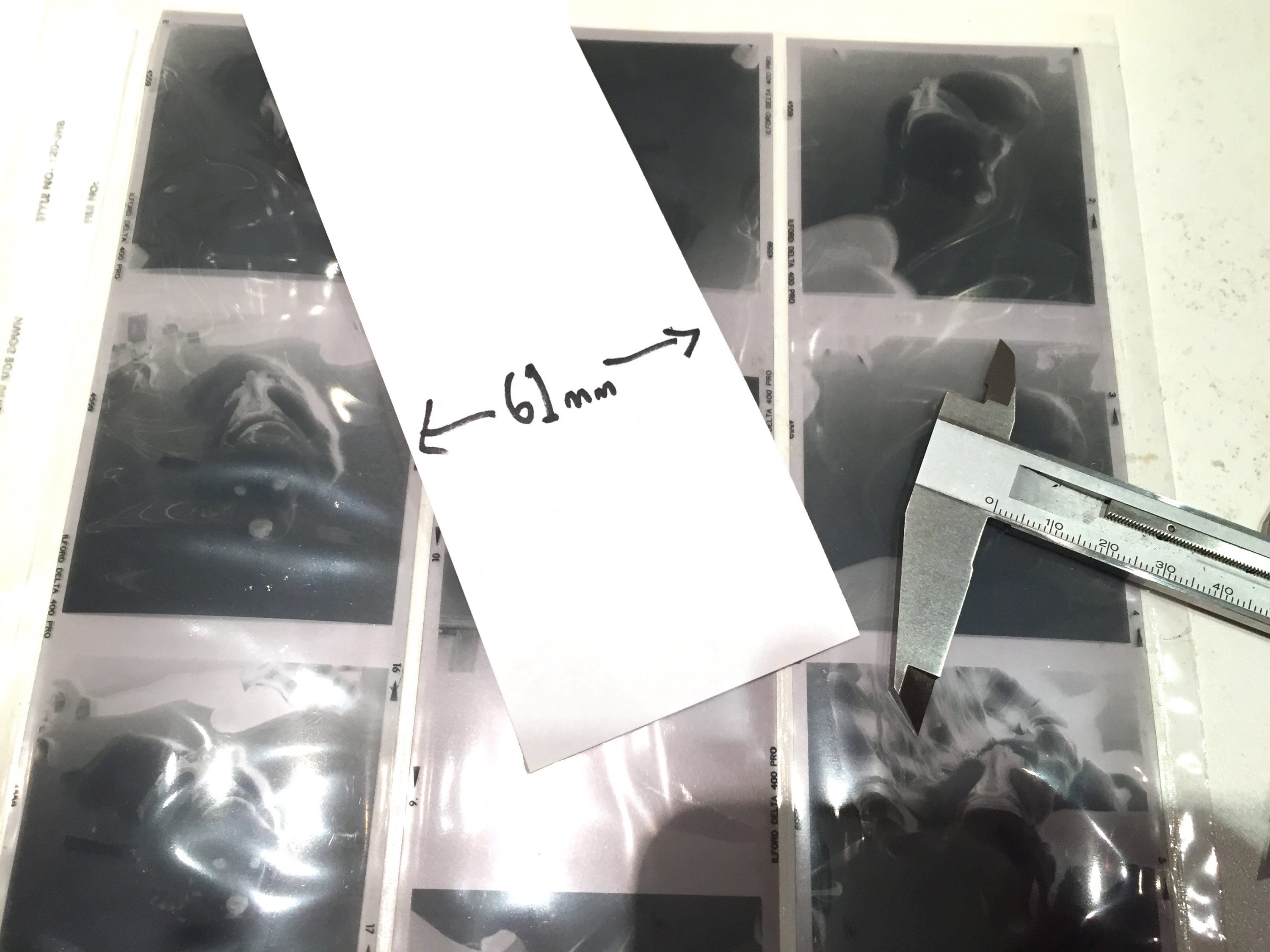

I will cut the 8x10 sheet into strips to get multiple tests from each sheet. In this case I cut to 120 film size for easy processing. I set the backstop on my paper cutter for 61mm to cut the film in the dark. I make note of the film notch and clip a corner of each strip to identify emulsion side.

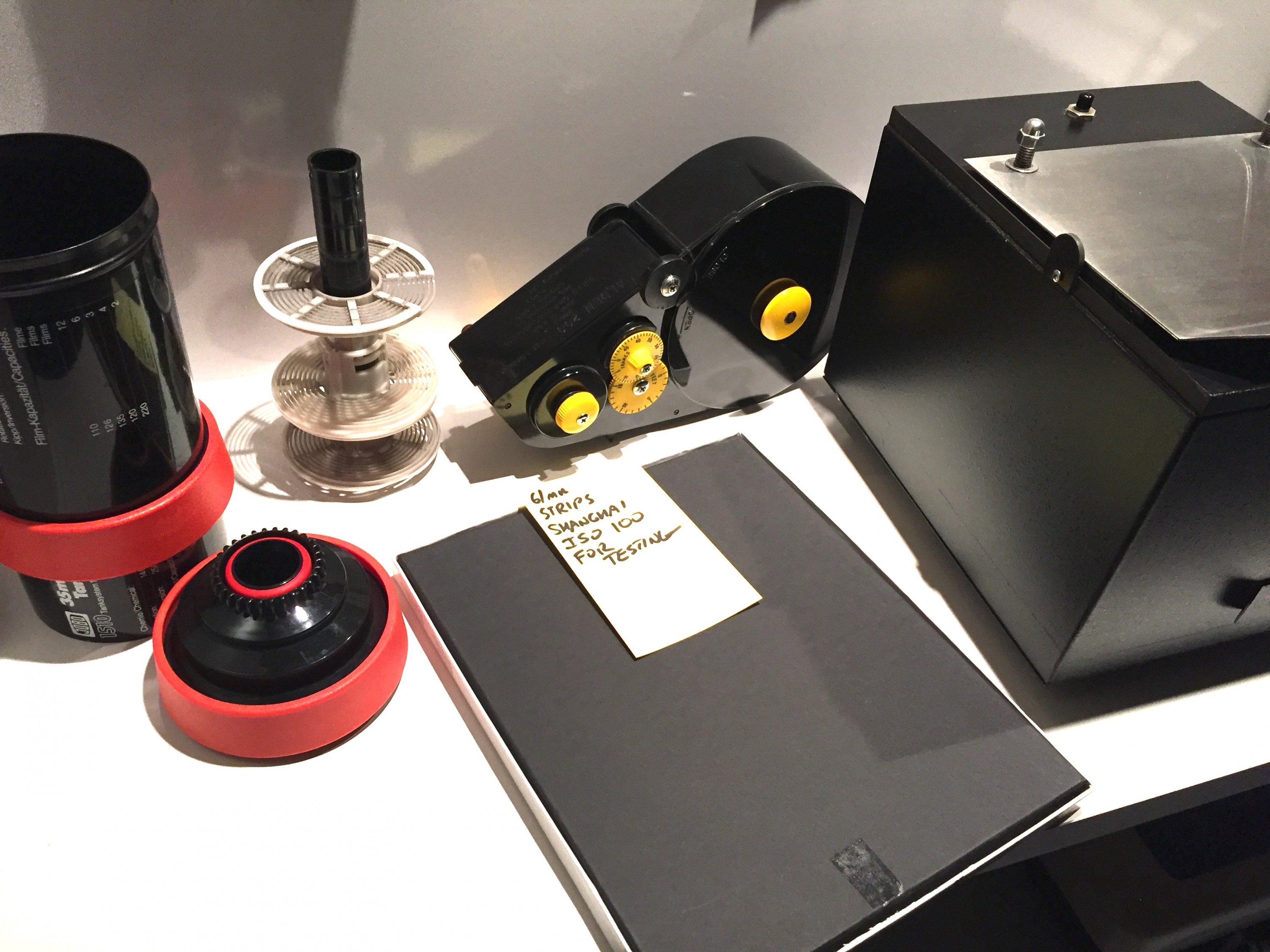

In the dark I expose a strip of Shanghai with the sensitometer and load it on the 120 reel. I also remove a strip of HP5 (in the bulk loader) and expose it with the sensitometer and load that on the other reel.

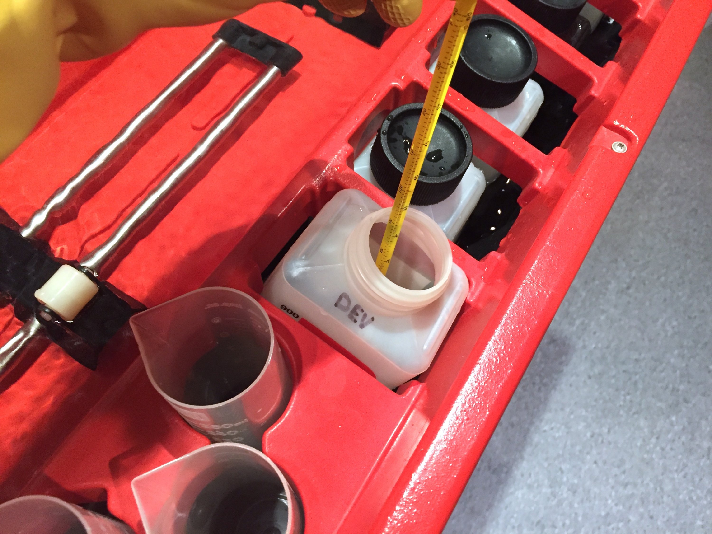

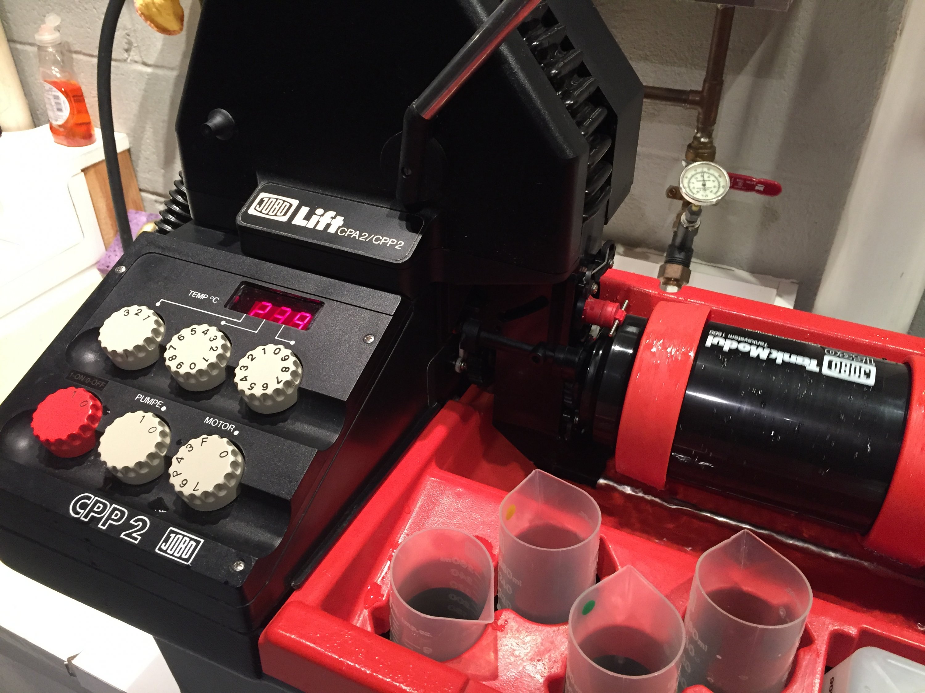

Process the film in the usual manner, making sure the developer has stabilized at the appropriate temperature.

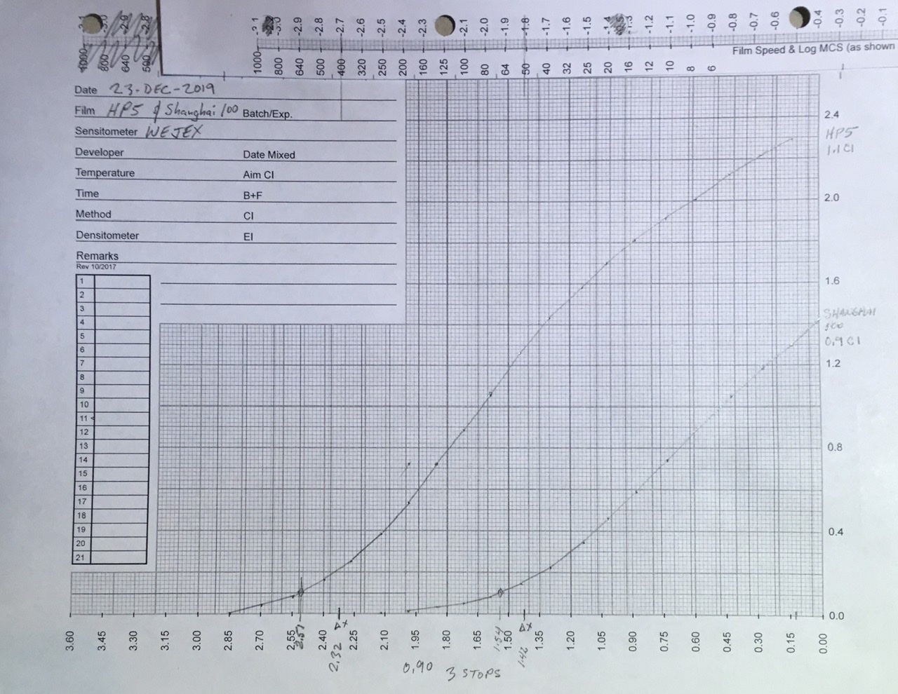

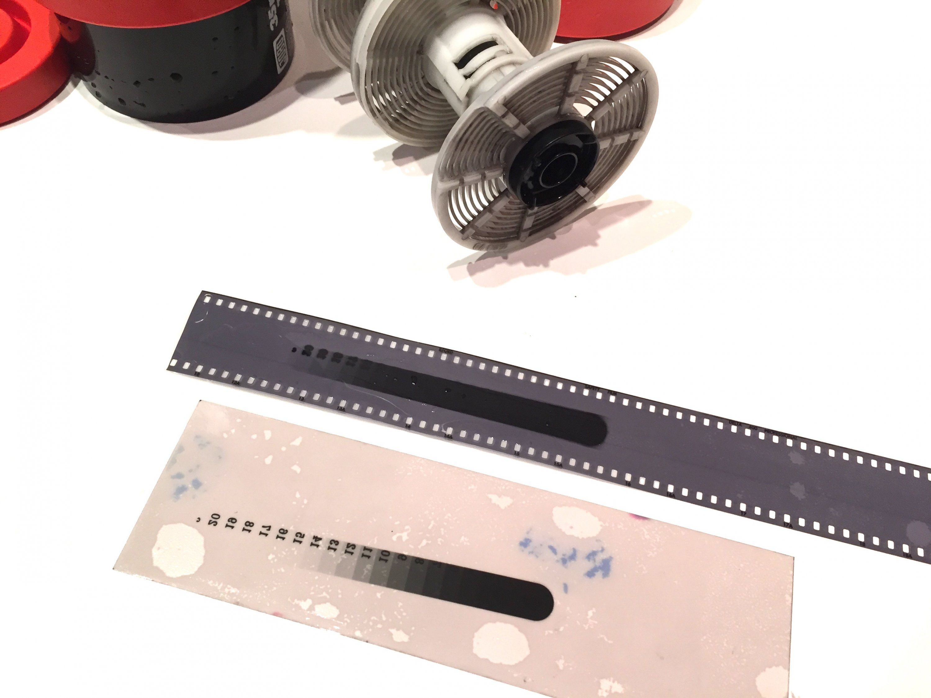

Even before the film has a chance to dry, you can see the new film is about six of the half-stop patches away from HP5 (20-14=6) without any specialized math. That puts the film at EI 50. But I'll use some specialized math anyway...

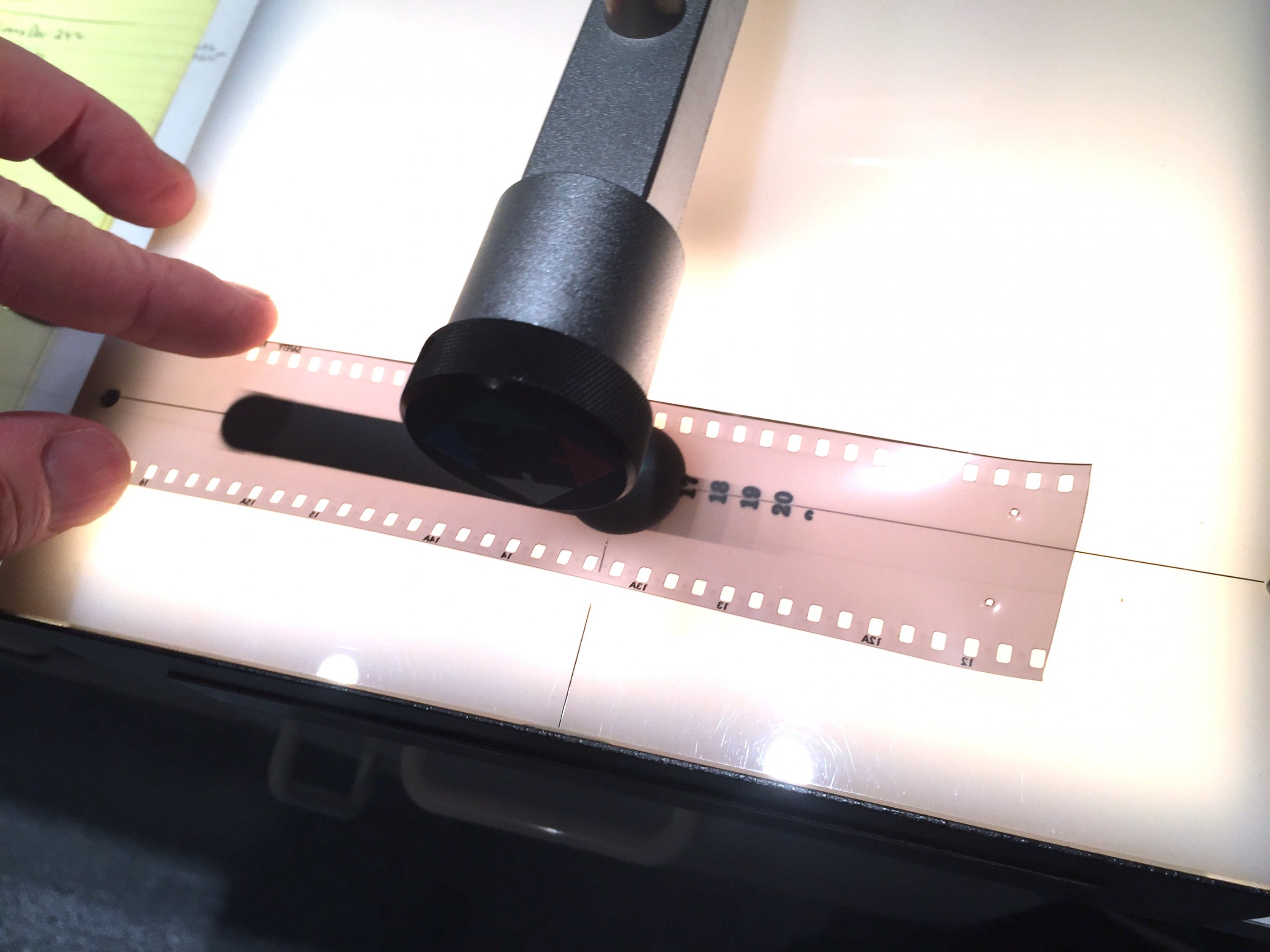

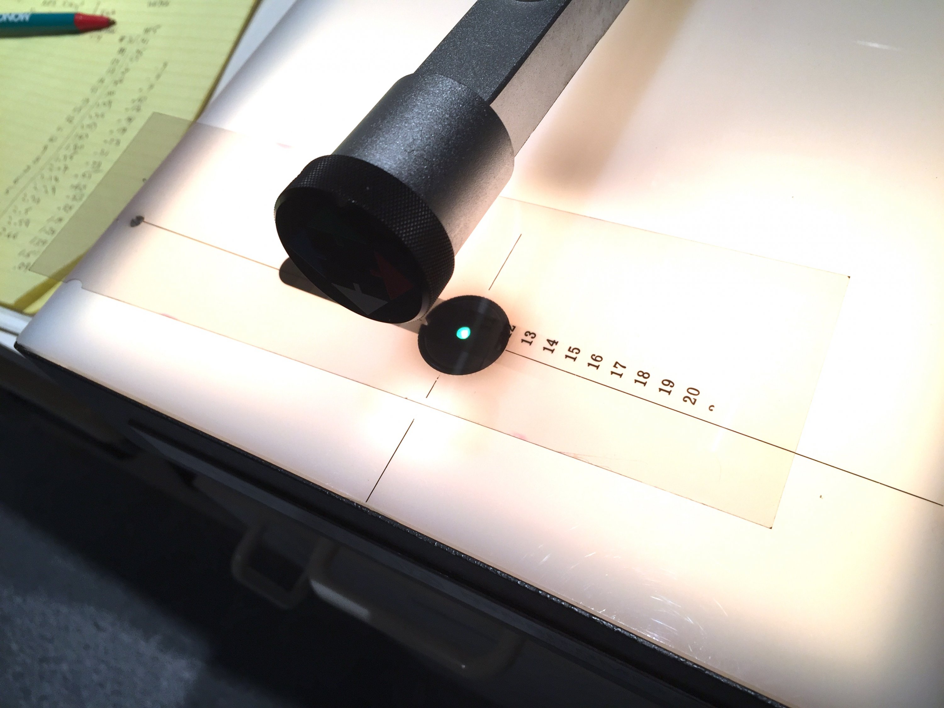

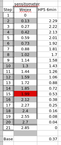

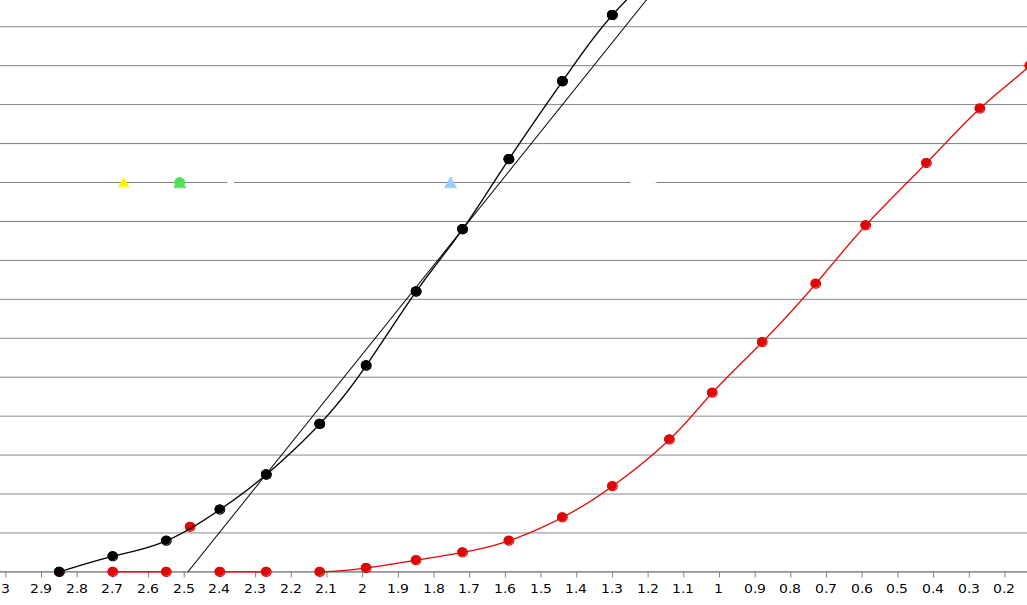

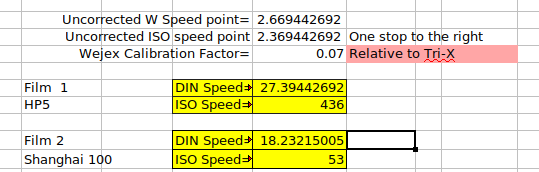

The dry film is measured and plotted for density. I already know the values of the step wedge in the Wegex sensitometer to use as the input values for the H&D curves. I use a spreadsheet that finds the film speed using a mathematical approximation of one-third the average gradient. That saves me from having to make a whole family of curves to find one that fits the ASA triangle.
The stepwedge in the Wejex is permanently affixed in the machine to project the numbers with the correct orientation. Just as a reminder, in case one forgets if the emulsion should be up or down when making the readings. (Emulsion UP).
After plugging the values into the spreadsheet, I can view the two characteristic curves and the relative film speeds, compared to Tri-X which I had previously tested and assigned ISO 400 in the software.
The software gives more significant digits than necessary, so EI 400 for HP5 and EI 50 for Shanghai 100 would be the final results.
Again, since I use HP5 almost every day for everything from 35mm, 120, 4x5 and 8x10, I know where to set my meter to get a good exposure.
Now I know the Shanghai is THREE STOPS slower, so I can set my meter appropriately and start exposing film tomorrow. I know this after using less than one sheet of 8x10 film.

Can you share the “raw” data, then I could draw graphs and check “delta-x” speed, etc.
Yes, they are on my other computer but I'll post them so you can put them in your software.

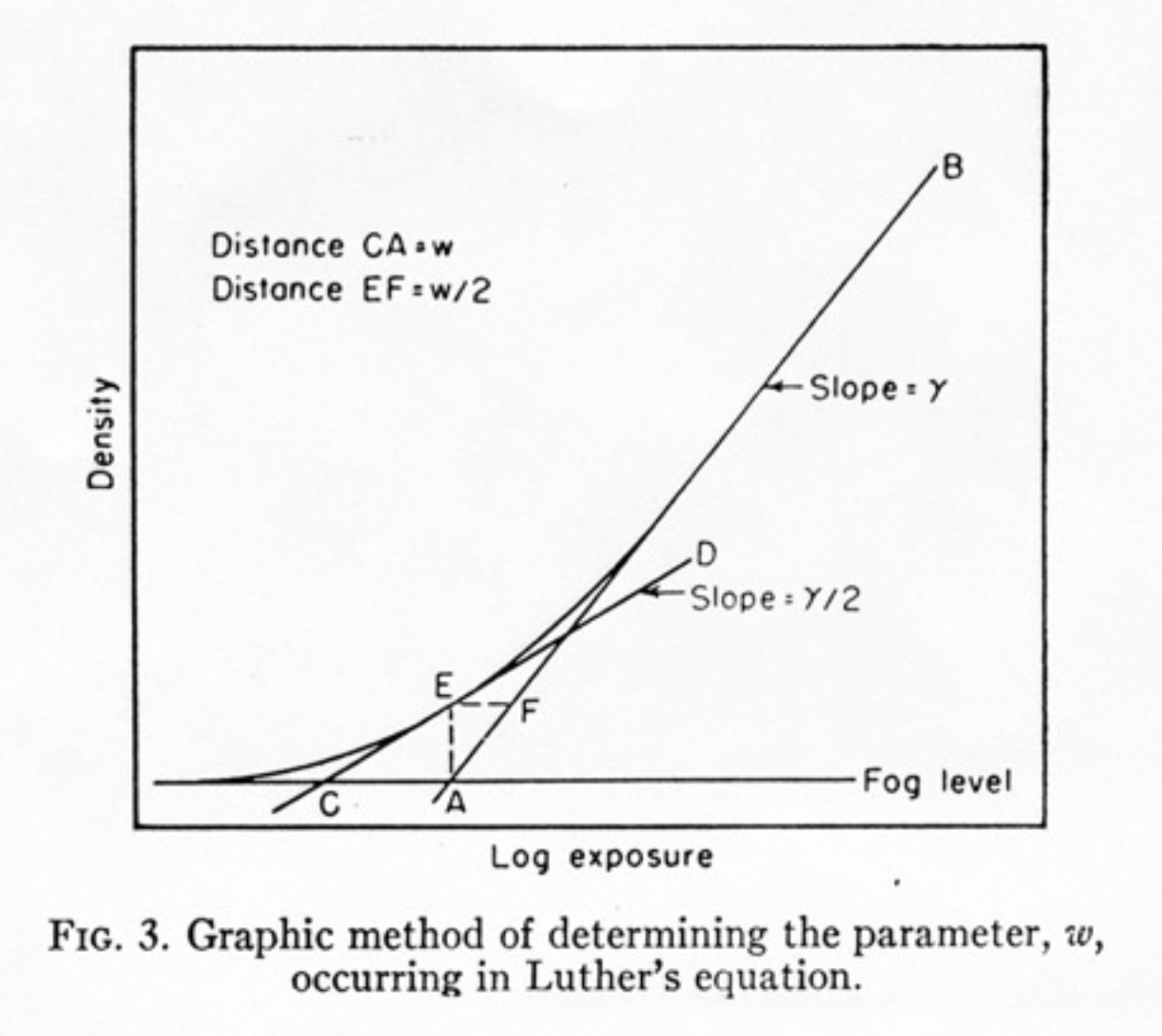

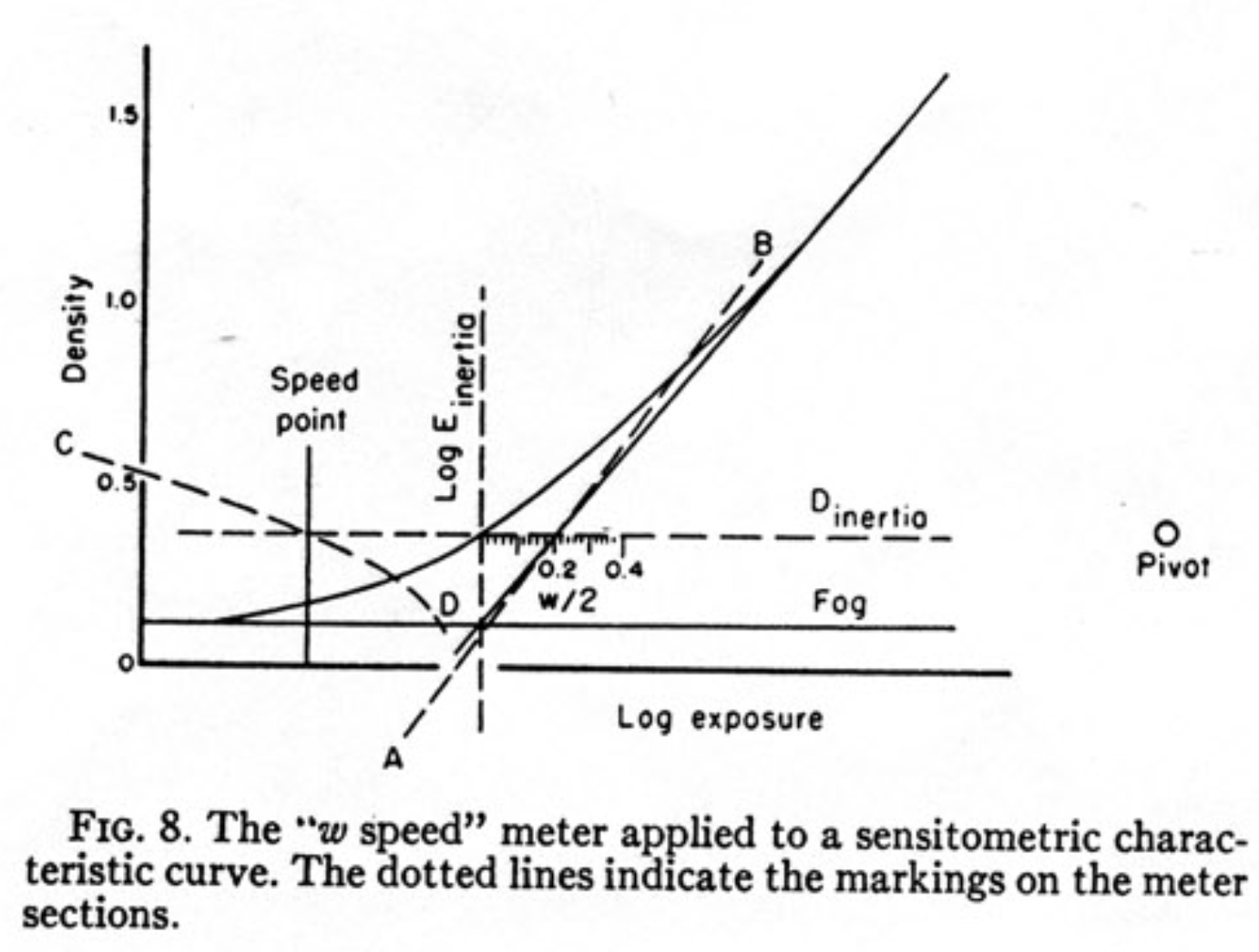

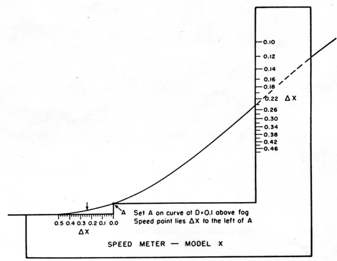

As a review, fractional gradient speeds were difficult to obtain from a hand-drawn H&D curve, so there was a paper in 1956 "Simple Methods of Approximating Fractional Gradient Speeds."
The two methods involved clear plastic cutouts that could be placed over the hand-drawn H&D curve (W-Speed and Delta-X).
W speed meter was in two pieces with a pivot:
Although the Delta-X looks easier to do on a hand-drawn H&D curve, if one has the H&D curve data in computer format, I fount it easier to calculate the W-speed.
For example, the W-speed relies on this calculation of "W" which is obtained by triangulation and can be done with simple spreadsheet program functions.
Looks complicated but break it down. Slope is easy to get. Then the Y-intercept is easy to get ("A"). With "A" one can easily intersect straight up to get "E" by stepping though the dataset until the two surrounding points are found and interpolated. If we know "E" and one-half the slope, the second Y-intercept is easily found at "C." Again the spreadsheet it calculating these Y-intercepts for me.
Once the two Y-intercepts are obtained the key value "W" is found with simple subtraction of "C" - "A."
Once "W" is found the fractional speed is easy math (all the numbers in the equation are empiric constants):
Fractional gradient speed = -0.0948 + (0.0122 *W) - (2.2945 * W^2)

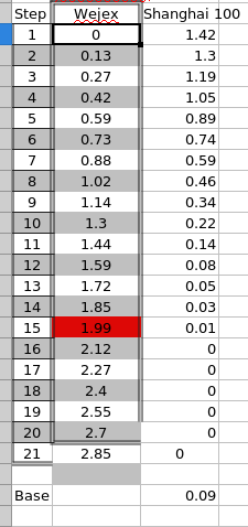

The tables did not cut and paste nice, so I made screen shots:
You developed these to a pretty high Contrast Index. I used a modified Delta-X meter, like the picture you showed but shifted 0.29 to the right. If you have an 0.62 CI curve of HP5 I could double check, but it looks like this works backwards to 0.40 mcs (-0.4 log mcs) for the Wejex. (Do you have an estimate? Is that about what you think it is?)
Exactly three stops difference by Delta-X paper graphing. So the advice I would give matches your advice...
Nice, thank you for posing.
I actually have never done the math to actually work backwards to get the MCS of my sensitometer but it should not be hard to incorporate this calculation in my spreadsheet. I believe you shift the Delta-x meter to remove the safety factor, yes? I do this in my spreadsheet, likewise shifting the W-speed to reflect current ISO.
The high contrast index of these test strips could be the start of some other epic thread, but it is due to processing only a short strip of 35mm and a short strip of 120 sized negative in a solution volume that would normally process FIVE 8x10 sheets.
My actual gamma, when a control strip is placed on the tail of a 36 exposure roll, processed as I do with seven other 36 exposure rolls in the Jobo, gives me a gamma around 0.75 with the same developer, and temp and time.
When I first got my Expert drum, I also did the above with the Jobo Expert 8x10 drum. That is I put a sensitometer exposure on a full 8x10 sheet and processed it with 4 other fulll 8x10 sheets to get my actual gamma. But I don't see the need to do that experiment again. I'll just extrapolate the gamma from the over developed strip. But this is all open to constructive discussion.
