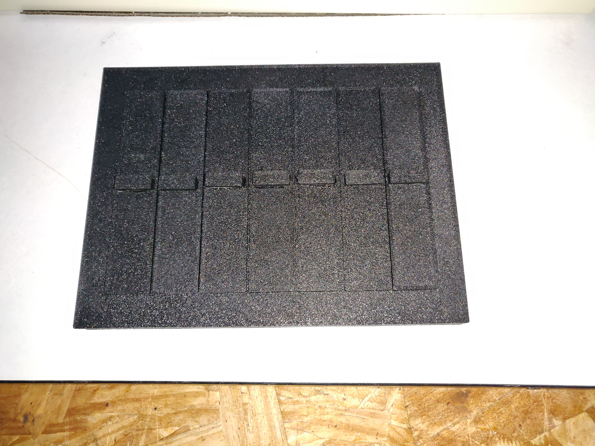

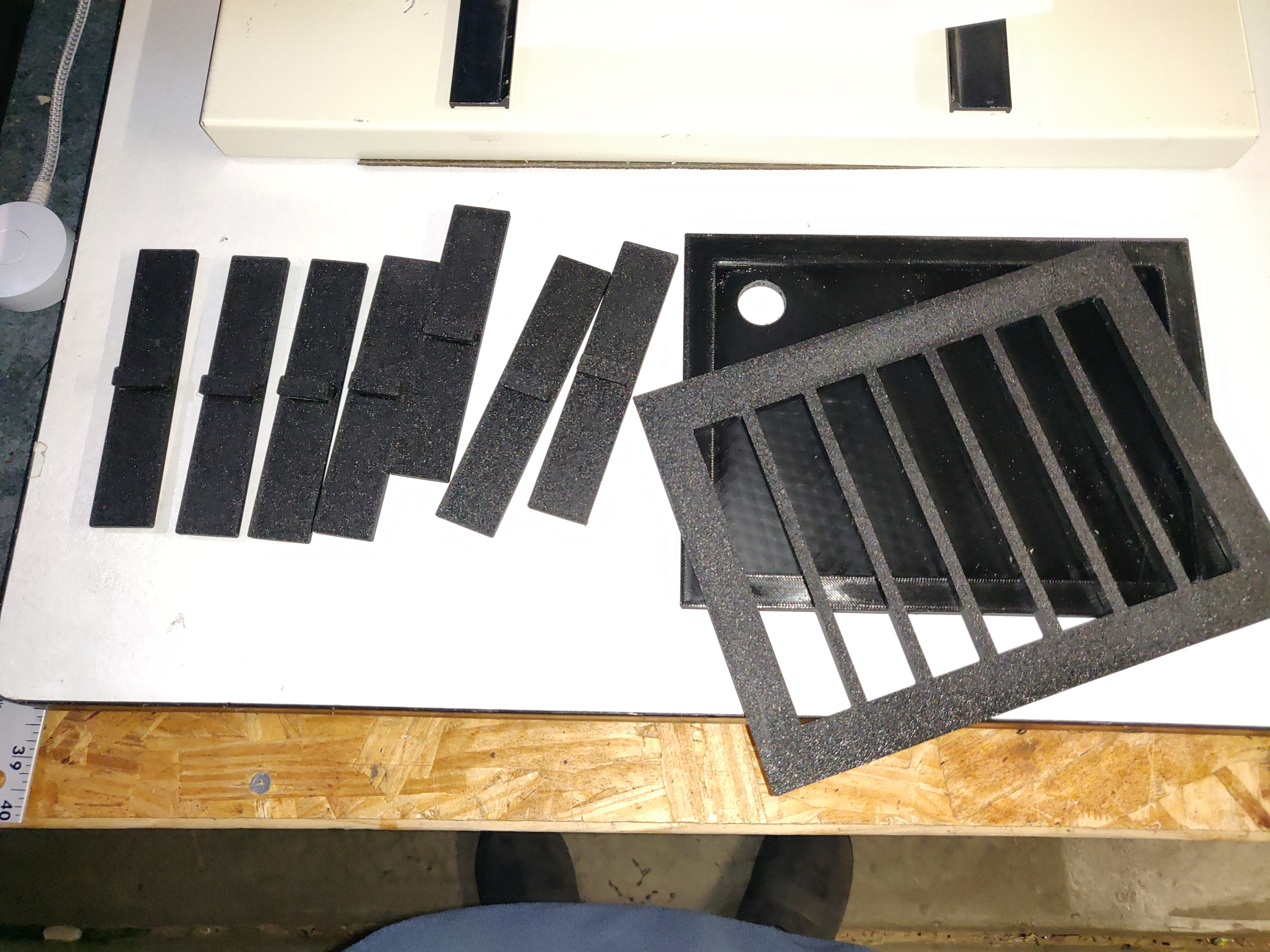

Since recently getting my Stop Clock and Zone Master I'm finding I like the way it works. I printed several pictures with it just using the built in Ilford MGRC IV profile. actually gave fair results. After getting more familiar with it, I decided to calibrate my setup and actual paper I use, Ilford MGRC Deluxe ( NEW, I think aka V ). I was just using two pieces of black sheet to make a slot over the paper as I ran through the filters I have. It worked but was cumbersome. I want to fine tune things more so I 3D printed a strip holder for 5x7 paper. Parts fit was a little tight, so I will open it up more then place it on thingiverse in case anyone could use it.
The results are noticeably better even with just my first pass at exposure calibration.
Here it is if you want it.

I can do a 4x5 one fast enough, question is how many strips? I only did 7 on mine because that is how many full grade filters to do to calibrate the Zone Master.
Do you remove one of the strips and make an exposure that is the same over the length of the strip using the same VC filter;
=Or=
Do you make a test strip at each location, sliding the plastic strip with a series of exposures, and each strip is exposed with a different filter?

What I have recently been doing is exposing each strip one at a time using a different filter for each. But there are many ways this could be useful.
With skills in 3D printing anyone might find it worthwhile to make the test strip printer that Ralph Lambrecht gives dimensions for in his book Way Beyond Monochrome As I recall it he has made the link available on Photrio as well. It has the facility to allow the same part of the negative to be exposed each time in 1 inch strips as well as 7 different parts of the overall negative on a 5x7 sheet
