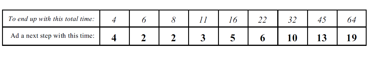

I like to accomplish this by sequentially covering more and more of the strip. I accomplish that with the aid of this chart:

Download and print a copy of the f-stop printing table that Ralph has so kindly provided. I photocopied a similar table from Tim Rudman's books and its the most used item I have in my darkroom. Going to f-stop printing from "time" (linear) intervals completely changed my success rate in the darkroom. After all, you shoot/base your in-camera exposures in stops, why not prints as well? Going 5-10-15-20 seconds (as I was first taught) means that the exposures are not equal, each subsequent exposure is less than half of the previous one. Where as printing in full (or half or third) stops, the consistency/exposure will be exactly the same between each strip. It also means that your dodging and burning will also be the same (based on stops) when making different size enlargements, as opposed to time values, which will change with each size.
Right. If full EV increments goes 5sec, 10sec, 20sec, 40sec, going in half EV increments yields
Sec Increment
5.....2
7.....3
10...4
14...6
20...8
28...12
40...16
56
