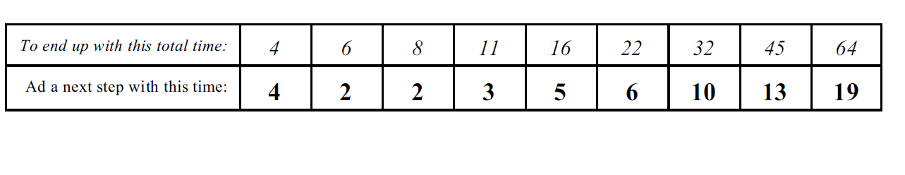

I use half stops - 2.8, 4, 5.6, 8, 11, 16, 22, 32, 45, 64 ... - if for no other reason than it is easy to remember.
I'm comfortable rounding things off to 3, 4, 6, 8, 11, 16, 22, 32, 45, 64.
I like to accomplish this by sequentially covering more and more of the strip. I accomplish that with the aid of this chart:
  • Test Print time progression.pdf

The problem with making test strips with fixed intervals is that, as exposure time grows, the fixed interval becomes a smaller and smaller portion of the total exposure; big differences in the beginning, imperceptible ones at longer times.
My approach is similar to Matt's above. However, I don't bother with all the complications of f-stop timing (who needs to be dealing with decimals and square roots when printing anyway?). I use percentages; each stripe on my test strip is a certain percentage more than the previous one.
I usually make test strips in roughly 25% intervals, but they are sometimes a bit difficult to evaluate; 25% is almost to close to clearly delineate the stripes. 30% is a good place to start; you can modify later if you wish.
I like exposure times in the 15-30 second range, so my 30% test-strip sequence looks like this:
Total time: (7) - 10 - 13 - 17 - 22 - 29 - 38 - (50) (values in parentheses I use only rarely; the ones in the middle are my standard)
Count: ............. 10 -- 3 --- 4 --- 5 --- 7 --- 9 -- (12)
You get the idea. The sequence is easy to memorize too. For 25%, use the following:
Total time (7) - 10 - 13 - 16 - 20 - 25 - 32 - 41 - (53)
Count: ............ 10 -- 3 --- 3 --- 4 --- 5 -- 7 --- 9 -- (12)
FWIW, I think in percentages for all my manipulations as well: Increases or decreases in print exposure are done in percentages, dodge and burn times as well. These get notated in my printing record and make life a lot easier when I have to scale a print up or down. I just make a test strip and then figure the new manipulation times as percentages of the new base exposure time.
Hope this helps,
Doremus

Always go in1/3-stop intervals because f/stop timing is the best way to go and keep records.
  • f-stopTable.pdf

I've only memorized the range of third stops from 40 seconds down to 13. If I can keep my printing in that range, I can do it by heart.
I don't even memorize the times themselves only the seconds to count between moving the cardboard over the test strip.
It's a pretty easy series of numbers to memorize: 10, 8, 7, 5, 4, 3

Part of the confusion in this thread is due to the way we make test strips. Some (like me) cover stripes successively and time additively; some uncover and time subtractively, some use bursts of a fixed time, etc., etc.
Maybe we should add our test-strip-making methods here as well. Here's mine:
I use a metronome in the darkroom for printing (actually, the metronome function on my timers, but I have used good old music metronomes in the past). I get a "beep" every second and simply count seconds. An exposure of (for brevity's sake) five seconds goes like this: "1, 2, 3, 4, 5, off." (I'm a trained musician and counting like this is second nature.)
When making a test strip, I use a third of a sheet, or sometimes a half a sheet of paper to get as much information as needed. Placement is important; I base my exposure on highlights, so I make sure my test strip gets placed where highlights are. I lay down the sheet under the easel blades, cover the lens with a card and start the timer. The timer is beeping at one beep/sec. I uncover the lens and simultaneously begin counting, "1, 2, ... 10...," at the point where "11" would be, I move the card, covering a stripe of the test strip, and start over counting, "1, 2, 3, ...," etc., etc. For a 30% test strip, I count "10, 3, 4, 5, 7, 9, off," giving me stripes with 10, 13, 17, 22, 29, and 38 seconds exposure in roughly 30% intervals.
I find using percentages so much easier than f-stop timing that I wonder why more don't use it. I don't need to figure how to give an extra 1/6 or 1/3 of a stop exposure to anything; I have a scale with more steps (5%, 10%, 15%...) and have learned to use that. 30% is about a third of a stop, 50%, half a stop, 60%, approx. 2/3 stop, but lots easier to figure from base exposure; no tables, no nothing :smile:
Best,
Doremus
