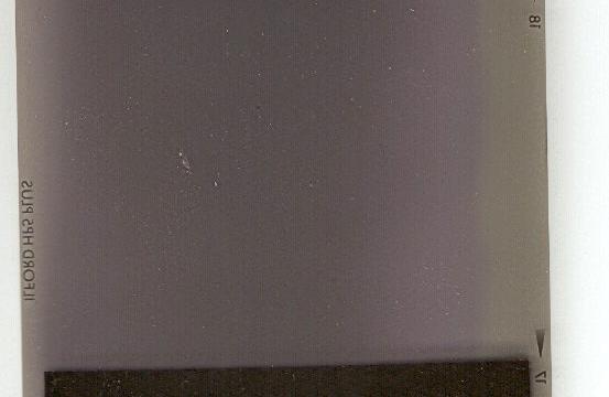

Well I've still got leaks. I had removed the carrier and film while I sealed the shell and the back of the RB (unlike the one shown in Goodman's pictures, my revolving back has no seals except the two strips where the film back meets it). Then I shot the rest of the roll. The dark transverse line is now gone, but there is still fogging
from one end of the film to the other.

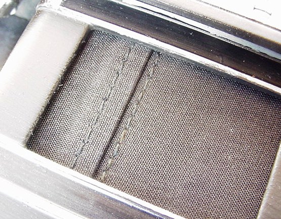

It's fogged from the lower edge of the film, below the image area, about 7/8 of the way up to the top edge. The top edge is clear, and it is less fogged outside the frame area even on the lower edge, which leads me to think its the dark slide seal. I took apart the dark slide part of the back and the fabric seal looked like it was worn unevenly, with a chance for leakage from the middle toward the top edge, which would be the bottom of the image area. I'm going to go look at sticky felt at the craft store but don't know if it will be suitable or not...

Hold it. You can remove the whole back. You can't just pop open the back and remove a loaded film insert(the part with the rollers and advance crank) without fogging and/or lost frames--unless you're in total darkness. Is that what you did???
Adhesive backed felt would work--if it fits--since it will resist abrasion better than foam.

The film hasn't dried yet but it looks like success! So now you know what a bad dark slide seal looks like, and bad back hinge/lock seal looks too. Everything looks pretty clean now. Thanks! It cost me under $2.00 for the foam and felt. I cut the foam and felt on my paper cutter to get nice even slices. Time to test the other back now. And I still have to deal with the mirror, but its not leaking quite yet. Now I can take pictures!!

Hmm. I've still got something going on. I don't see any fogging per se, no silver/gray/black, but there is still a faint purple density that goes from the bottom up to about 1/2 inch from the top edge. It looks much like the photo in post 208 above, but very faint, and only pinky-purple. Maybe it's a developing issue, but I'm not sure why it wouldn't go edge to edge if it was. I've been using a pre-rinse for 1-2 minutes and fixing in plain sulfite-hypo fix for 5-6 minutes, in a plastic Yankee tank. The tint doesn't bother me-the fact that it's not uniform across the film does...

The pink tint suggests insufficient fixing - maybe you didn't use enough fixer to completely immerse the film. Either that or else your agitation technique did not circulate the fixer enough.
This has me thinking about the previous rolls I developed where there was obvious silver in the area that is now just pink. Those rolls also had a clear area with no silver or pink, which might be from uneven fixing at the bottom or top of the tank. When I went to develop my most recent roll that showed pink but no silver, I realized I had used only 50% of the correct amount of hypo in the fix. I used the correct amount (about 1:4 by volume) on that last roll. I don't usually use plain fix on film, but I'm too poor to buy rapid fix. I've been agitating for 30 seconds initially and 5 seconds every 30 seconds.
