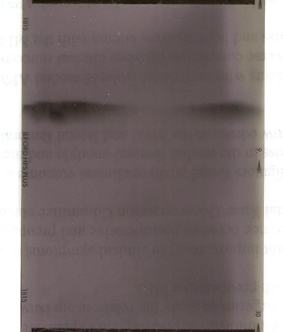

So I finally got around to developing some film, and I obviously have some light leaks. The seals on the back of the camera where the film back seals are definitely shot. I'm wondering if anyone can diagnose other possible trouble spots from this picture. Its a crappy scan and looks like the whole film area is fogged, which it isnt-but the whole frame area shows some. There is a broad, more diffuse horizontal- lengthwise smear of leakage, and the darker vertical line 1/3 of the way into every frame. The lengthwise smear is continuous from one end of the roll to the other, and shows through even in exposed frames, but the vertical mark doesn't show up in any of the exposed frames. That vertical mark goes all the way to the edge of the film in blank frames, as shown, but does not show up on the edges of exposed frames.
I'm off to get some seal material...
Don't sweat it. Light leaks happen in the best of families.
Go back upstream and look at the Japanese link I posted on the anatomy Mamiya light seals. Looks like the whole roll leak is probably the film back/RB seal. The cross frame leak looks like the clasp/hinge seals on the clam shell portion of the back that surrounds the film insert. Both sets are an easy fix with thin adhesive backed foam.

I don't understand why the darker leak isn't present on exposed frames...
But anyway, I've got most of the seals replaced now on my backup holder, which was in worse shape than I realized when I bought it. I have a half roll of exposed film in the other back. I think I will switch the film carrier innards over to this shell with new seals, and see if the second half of the roll comes out any better. Or maybe I should transfer the film carrier over, repair those seals and put the carrier back in that one and finish it up. That's probably smarter.
