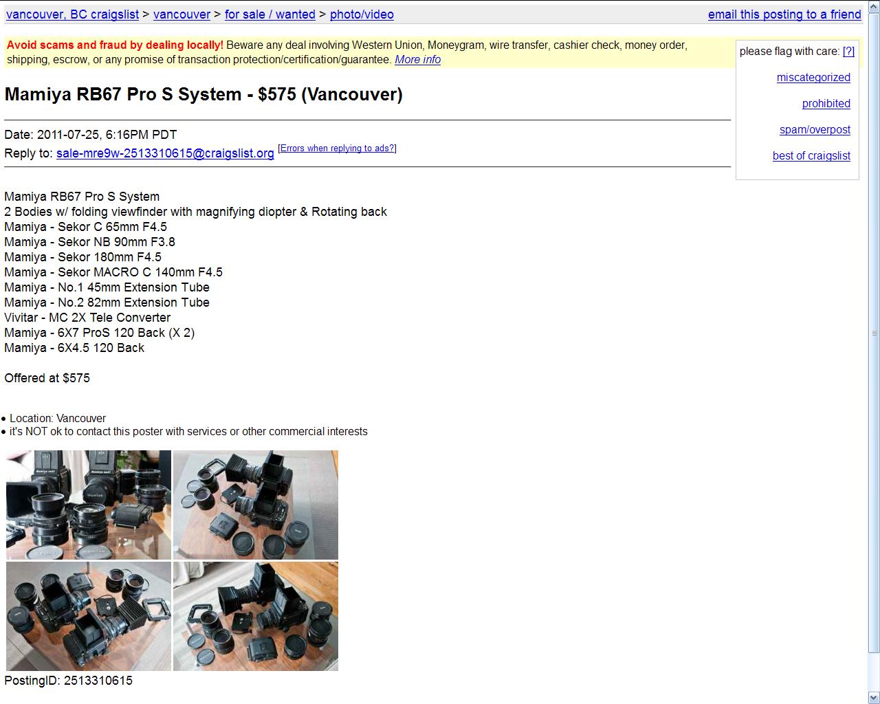

For handheld use, look as well for one of the Mamiya Grips with the built in left hand shutter release trigger. They are also compatible with the Mamiya C330.
Here is a photo of the multi-angle version, courtesy of Graham Patterson's excellent Mamiya TLR resource:
http://grahampatterson.home.comcast.net/~grahampatterson/grahamp/mfaq/jpg/lgrip.jpg
I use the non-multi-angle version on both my Mamiya C330 and my RB67.
As for prices, they vary greatly, depending on the source - see the attached Craigslist ad that ran recently in my area:
