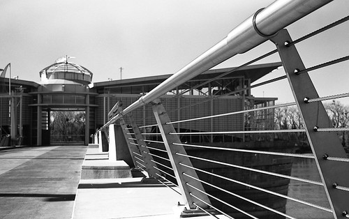

I developed a roll (1994 expiration) the other day in RLC (6 minutes) and was quite pleased with the results, except that I think I over agitated it as evidenced in the sky. No visible grain, sure looked better than Tmax100 to my eye. I have a good bit of Technidol, but not as much as I have of TP.

RLC? Agitation pattern? Print or negative scan? If it's a print, what paper and grade was a good match?

It is nice to Rollie Low Contrast able to handle TP so well, the short development time makes it hard to do minimal agitation. The sky does show some over agitation, but controllable in printing.
What was your agitation style and how frequent?

This was scanned on an Epson v700. The agitation method was as Kodak recommends in this bulletin, but I did not fill the tank as instructed (it had been a while since I read the bulletin). I loaded the reel then poured in chemical in the light. So maybe it wasn't my agitation, but my sequencing.
Y'know, I have never cared much for the film, but i have to say that seeing your result makes it tempting. But, I'd sure find a way to slow it down. Longer development, gentle agitation - so much more reliable.
