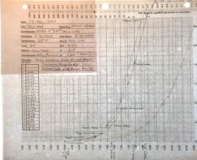

Here’s the graph of the result in D-76 stock 64 minutes at 68-degrees F with “Kodak” agitation for the first 15 minutes then agitation every minute or so thereafter.
Negatives have blown out skies but good graphic effect.
I put it on light box over the 18:20 graph you can see how much difference longer development makes.

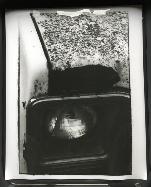

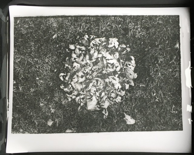

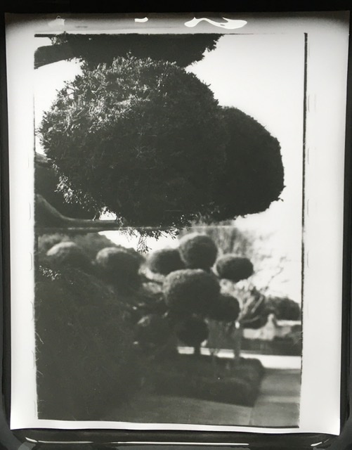

Here are wet 11x14 prints on Ilford Galerie grade 2. 1/3 stop dodge in a couple places otherwise straight prints.

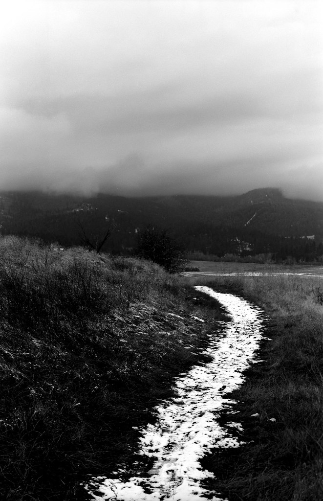

16 EI Kodak Technical Pan
Rodinal 1+150 for thirteen minutes/ 68 degrees F
Agitate with 30 seconds initial inversions, then 3 inversions at 10 minutes,7 minutes,4 minutes, and 1minute counting down. (every 3 minutes)
Regular stop, fix and hypo.
I used 5ml of Rodinal in 750ml of H2O. That gives less than the recommended 10ml of Rodinal but the negatives really look great (full tone scale).

That looks surprisingly good, with nice shadow detail. Thank you for sharing. I have a roll or two of TP in 120 in the freezer, and, of course, Rodinal in the darkroom. Maybe the rolls will have a chance to get used now.
