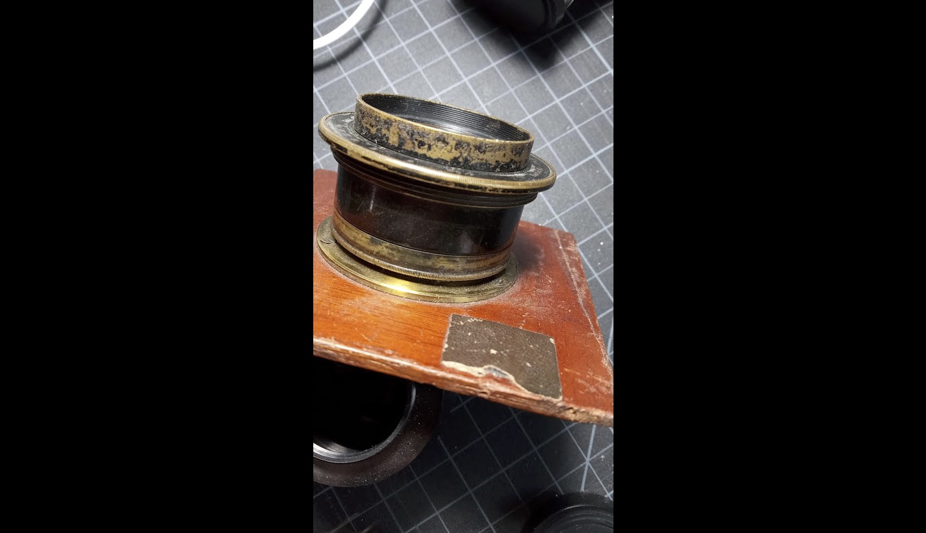

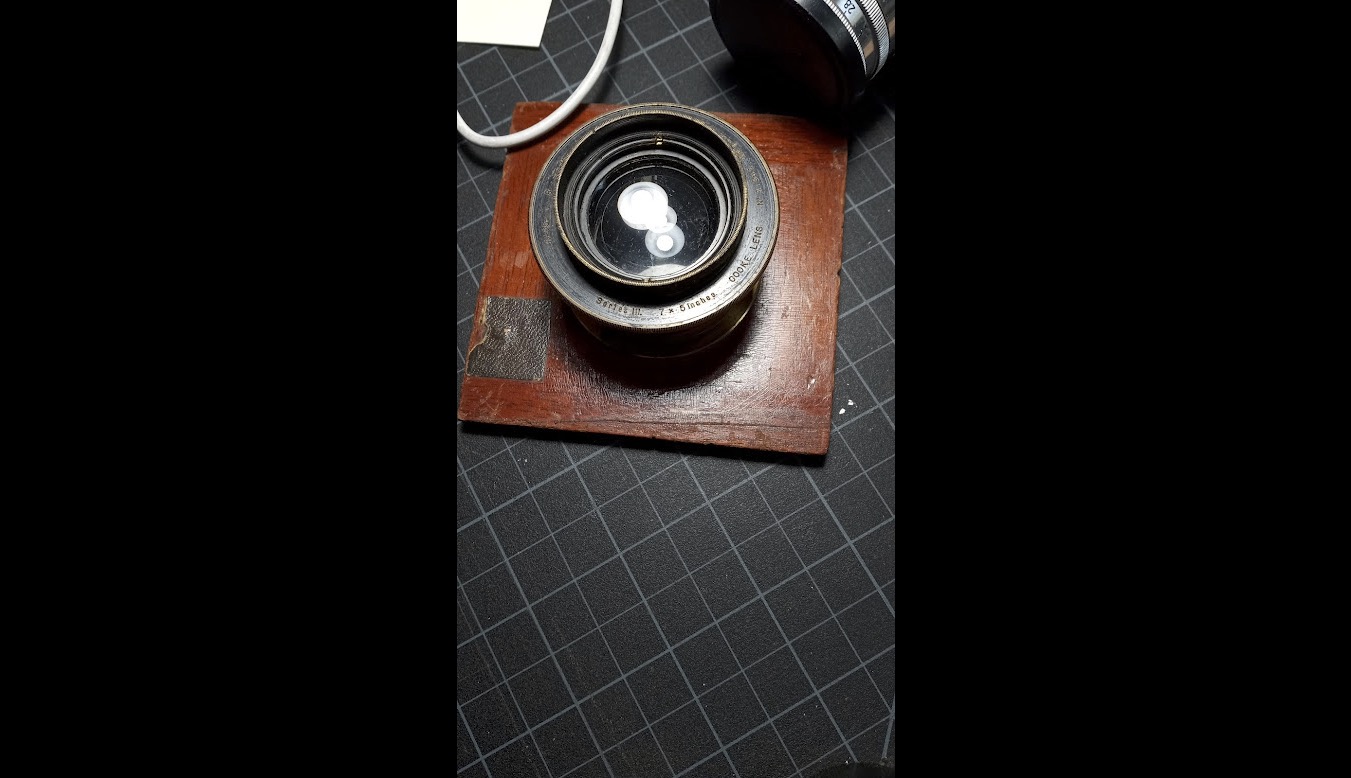

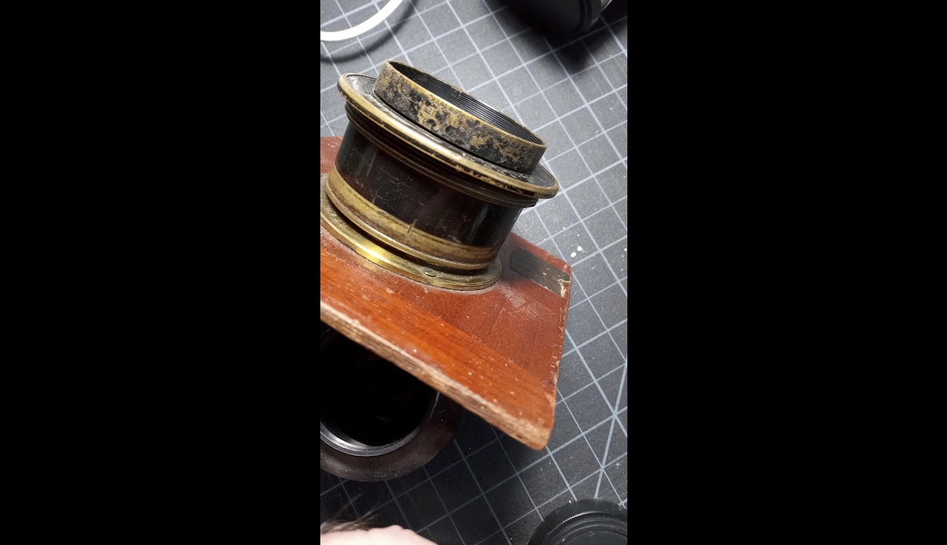

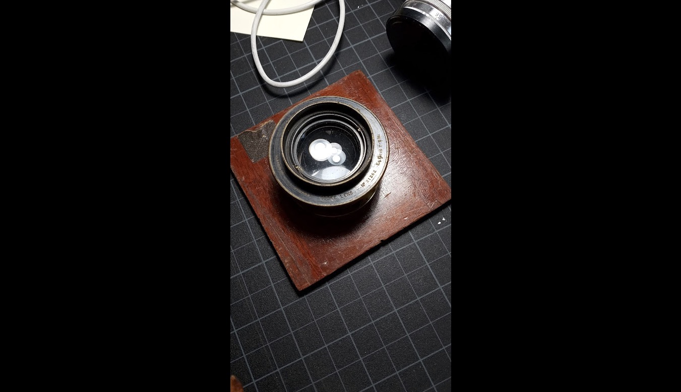

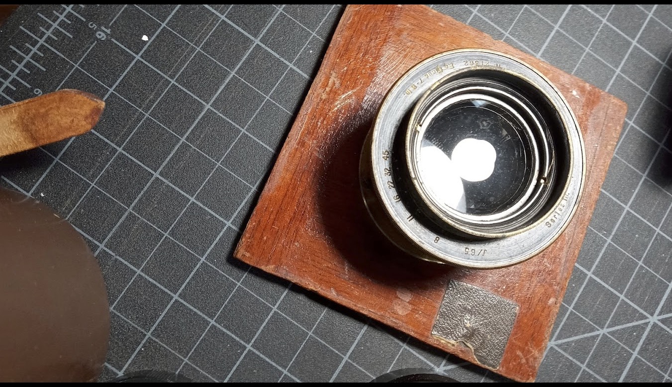

I have a very old TTH lens that came on a view camera bought in an auction. The lens was wrapped in the old style cloth electrical tape--mummified if you will--and I've never been able to find information about this particular one. I've looked through my copies of old BJP annuals for any info and come up empty. There is lettering around the rim of the front element that reads: "Taylor Taylor Hobson Ltd., New York & London" but is almost totally obscured by old paint.

Series III was in production from 1897-1923. Yours may date to around 1911. Thanks for showing it.

Yes, if you look closely at the markings on the front face it says "Series III" but I haven't seen a series III with that wide front face--all the examples I've found (like the one in the catalog) have a much narrover body with the f-stop markings on the side rather than the front. Does that make sense? Is this some odd variant?

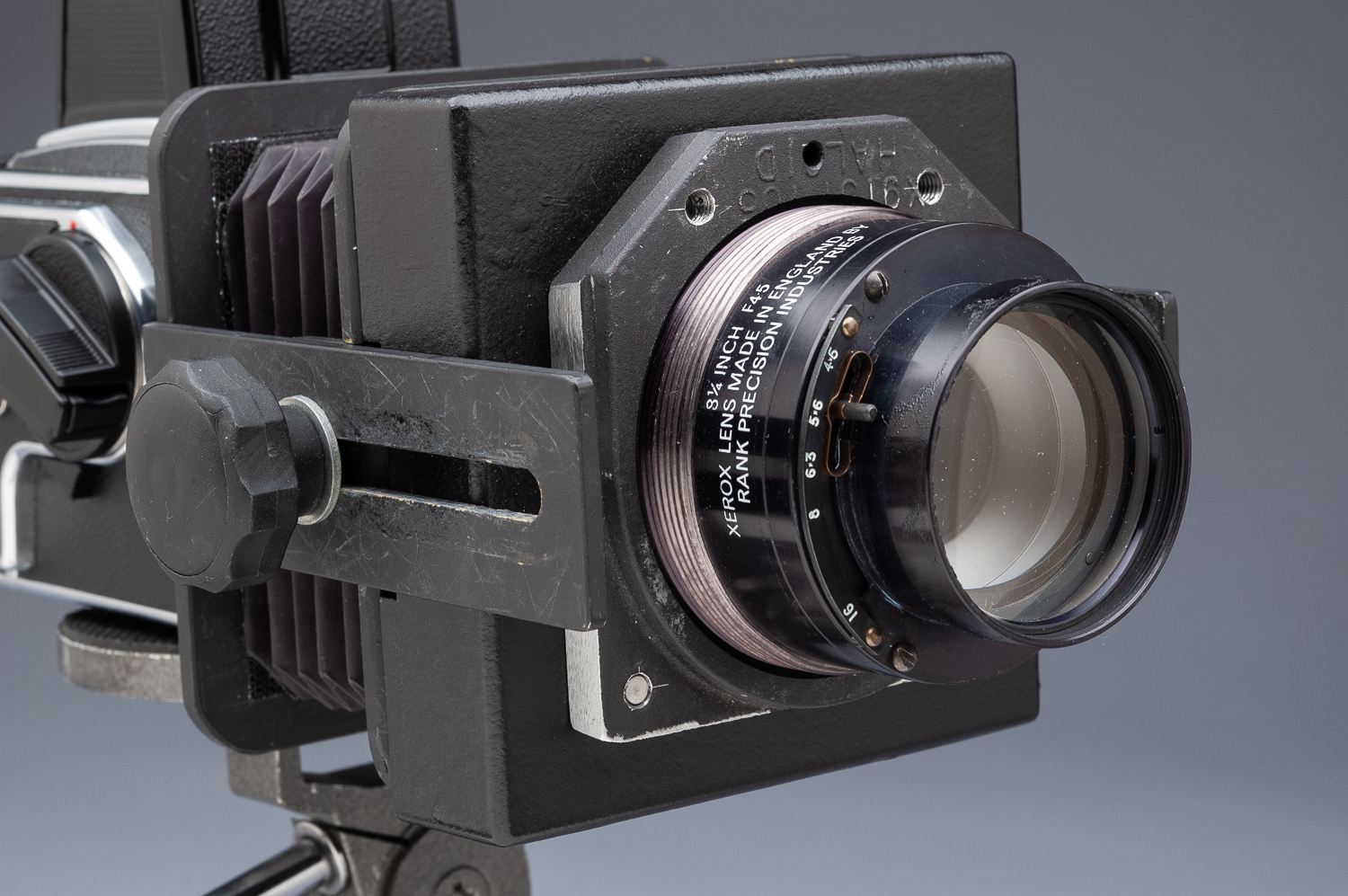

Ian, I own 2 lenses, both 8 1/4" - 210mm most likely from photocopiers and all those names are there. There is one with Xerox-Rank markings.
