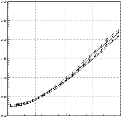

The other was a group of six or so curves, all superimposed, forming a band in which you could see variations from each other. It showed that Kodak's manufacturing was staying within reasonably tight tolerances, but that's still not what we want for comparing with our own work.
Bottom line: I have no curves to post that would help us with our own measurements. But I can post what I got if you're still interested.
Mark

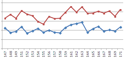

That's two requests, and others are probably interested too, so here goes.
The curves below show the lower- and upper-contrasts for all recent batches of TMY2. It's clear that nothing has changed in the last few months:
And here are the curves of recent batches. They all fall within a reasonably close band, so once again, no problem:
As a result of my query, Kodak pulled some sample films from storage, exposed and developed them, and plotted the above curves. I was hoping they would include samples purchased from the open market, but I'm guessing the curves above convinced them that everything is fine.
