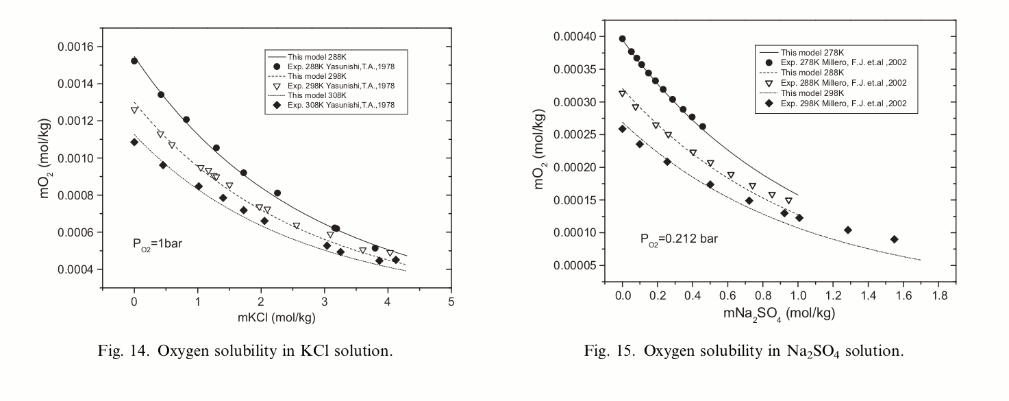

(!) If you try to make p-aminophenol from acetaminophen without added sulfite it darkens very rapidly in air which suggests that Rodinal (clones at least) will oxidize rapidly once the sulfite is all oxidized.
(2) There have been suggestions that Agfa Rodinal formula recent version contained an additional additive as well as sulfite to prevent oxidation. Mysterious properties were attributed to it, such as being able to slow the diffusion of dissolved oxygen. The matter was never resolved.
The high salt (generic term not sodium chloride specifically) concentration to a large extent prevents oxygen from dissolving in the concentrate. Think about what happens if you add something like sugar (Mentos mints) to carbonated water. You get a lot of foam as the sugar forces the carbon dioxide out of solution.
http://www.sciencedirect.com/science/article/pii/0013468667800070?via=ihub
I did not get the full text but this article supports Gerald's explanation for the long life of Rodinal, both the solubility and diffusivity of oxygen fall with hydroxide concentration. There seems to be no reason why the various clones should be much different, if that explanation is correct.
Alan, take a look at this:
I do remember a discussion about whether the clone was to be made up as 200ml or 250ml. Mine was made to 200ml according to the spreadsheet I was provided by Dorff.
