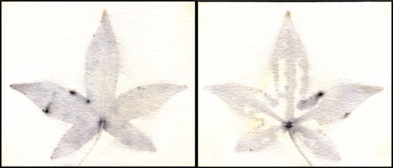

sycamore photogram "wet cyanotype"

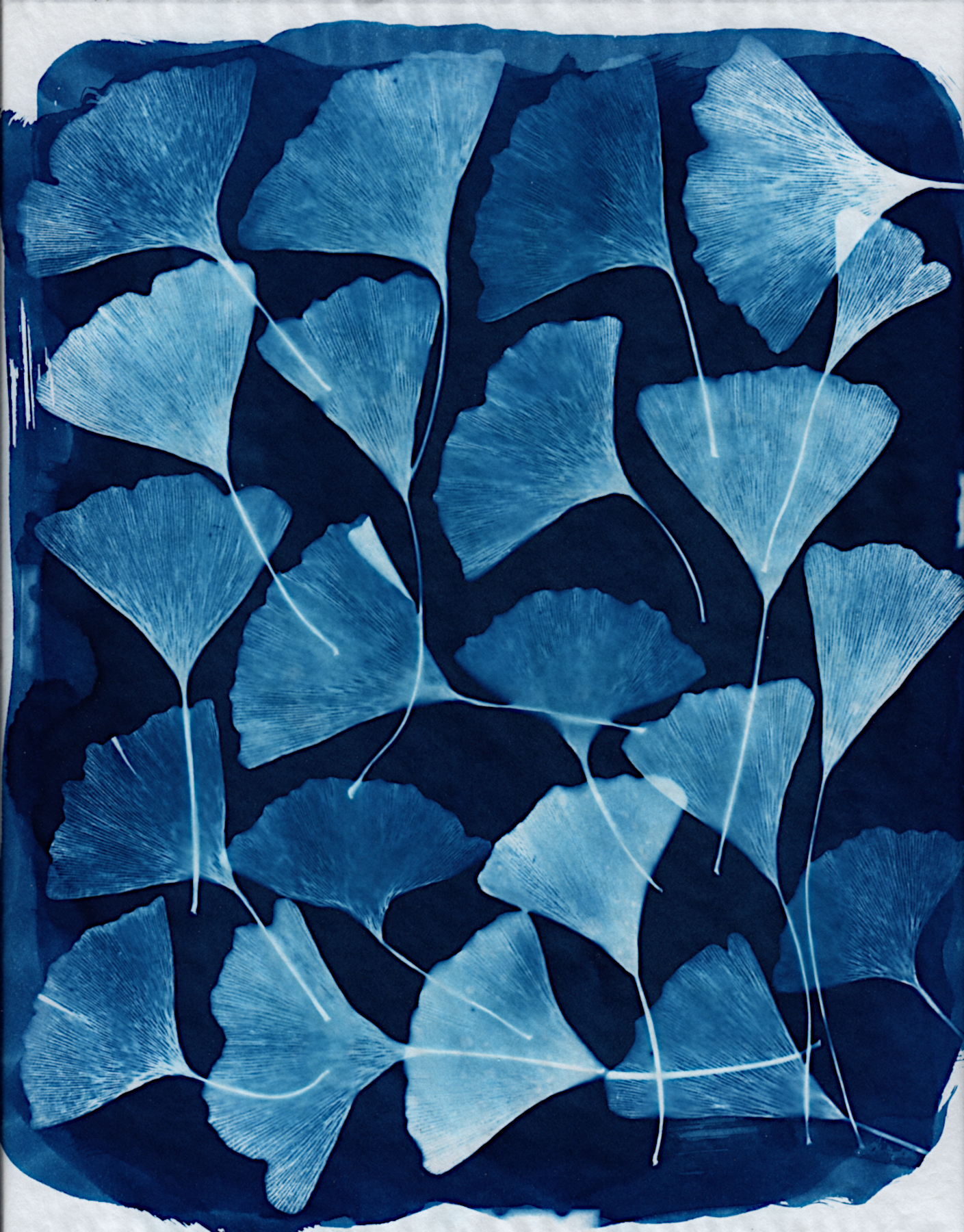

(~3h in sun) blue ginkgo:

I'm enjoying these a lot, Ned. The ginkgo images look like living, moving organisms.
Love this image. Anna would be proud! Ginkgo is one of my favorite trees.
Looks like you made a straight cyano with this one. Did not use the sepia inter-negative, right? Is that because of the fixing issue? Also wondering about sodium sulfite. Aren't you fixing with hypo?
:Niranjan.
Right that's a straight cyanotype. Not for any reason except I thought it might look nice :smile:
For those sepiaprints, I fixed them using sodium sulfite instead of hypo. Namias mentions this in his article and suggests that the more yellow color is better for making negatives. Only time will tell if they are truly fixed, but one sat under my UV lamps for 8 hours didn't look any different at the end, so it appears to work. I have a theory about why it works, but more on that later...
Got it....thanks.
Perhaps silver citrate has a better solubility in sodium sulfite than do silver halides that makes sodium sulfite OK to use here but not so in salt prints or traditional DOP papers. Just theorizing...

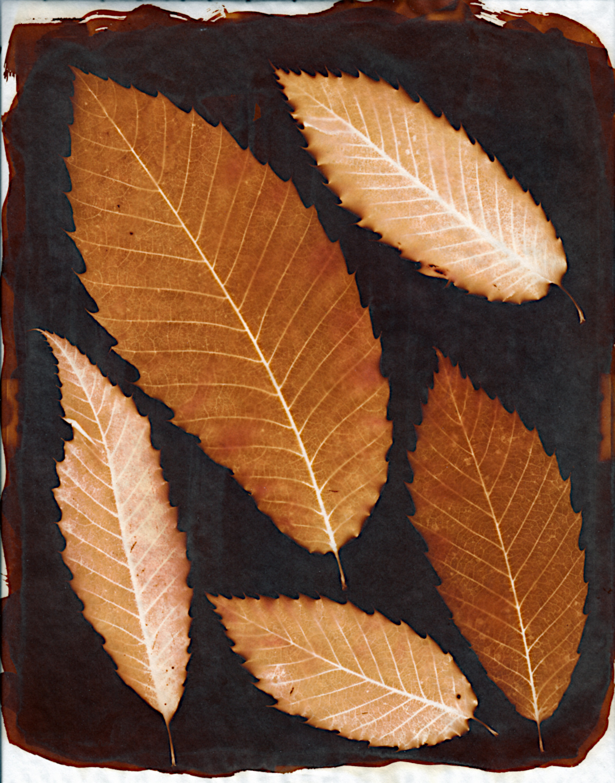

And some more. These are chestnut leaves, the sepiaprints fixed in salt.

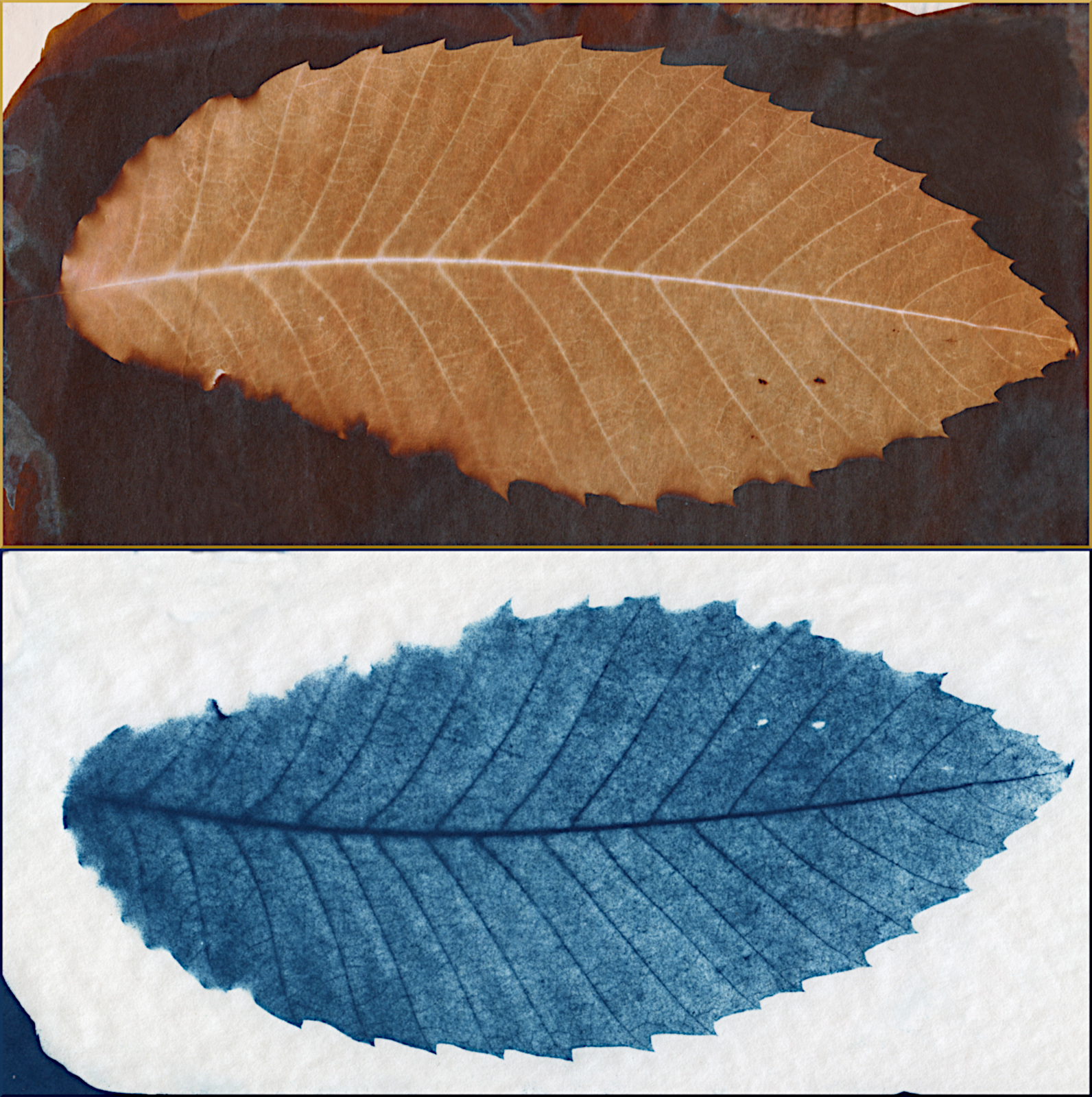

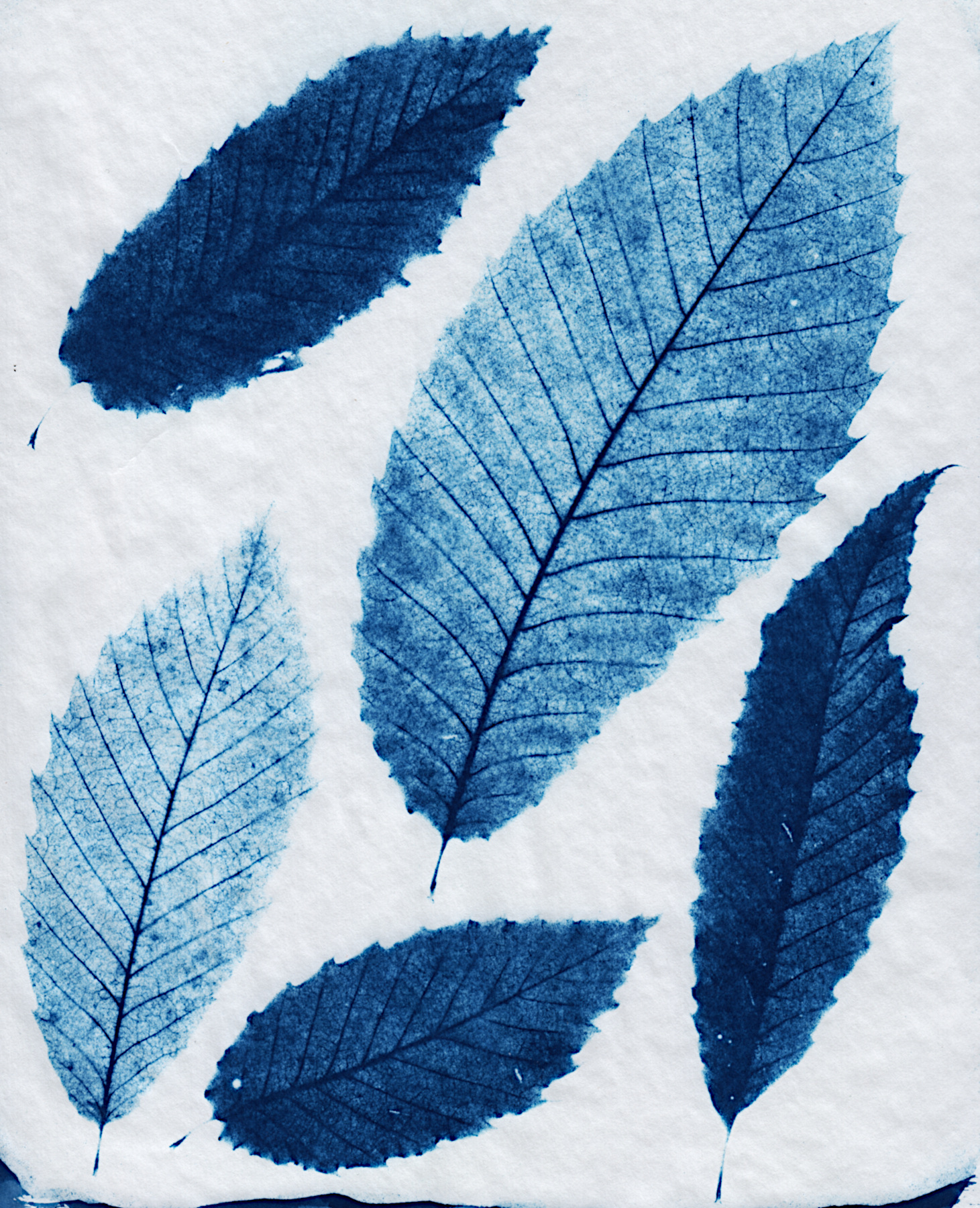

I'm going to print this sepia negative today as a cyanotype positive:
cyanotype positive from sepia negative:
Need to leave a little more room around the edges so that "dirty border" could be masked off with a window mat.... and give the subject a little room to breath...
These are nice to hold in hand, with the bright colors and detail.... since that's what's nice, it makes me wonder if painting the leaves with bright colored inks and running through an etching press might not really be what these need :smile:
By the way, that sepiaprint negative that was fixed in salt was out in the sun all afternoon yesterday making this print, and it looks no different now than it did when I first made it. No idea what it will look like 10 years from now, but it seems to be perfectly well fixed for short term use.

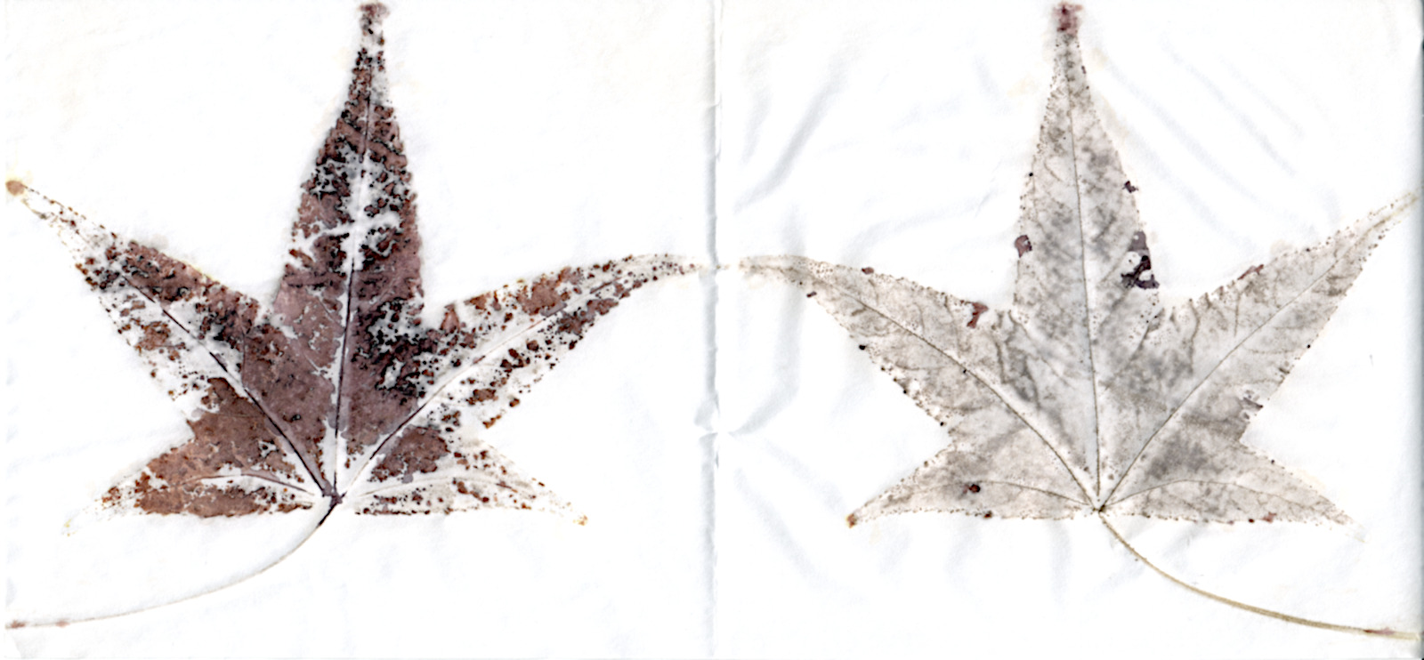

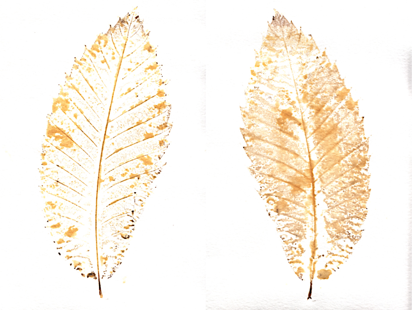

:D Well, I'm getting pretty far away from cyanotypes or anything to do with photography with this, but this is what I've been fooling around with the past few days.
I painted some AFC ( one of the cyanotype chemicals ) onto some paper, then some tannic acid, and it made a black ink that did not wash out. So I thought I'd see if the tannins from the leaves themselves could make the print. I painted the AFC onto the leaf and then pressed it in the paper. Took a few tries before I started getting anything ( it needs some moisture, and it's faster with some warmth ).
This one made by putting the leaf between two sheets of strathmore 400 printing paper, putting an oatmeal can on top of it, filling it with boiling water, then letting it sit all afternoon:
This one made by putting the leaf into a folded piece of canson marker paper, putting damp paper towels on either side, then into a ziplock bag and zapping in my microwave a few times:
Kinda fun! So now I'm off in tannin leaf printing land for a while....

In my head, I'm calling them "tannigrams" :smile:
You could try a dry mount press too. Or an iron..
Thanks! Lots of people are dying fabric with leaves and calling it "eco printing". Not quite the same thing I stumbled into, but similar.
I was also thinking a steam iron might work really well for this, but haven't tried it yet.
Not so sure about these... I think the colors will be fast, but it also looks more than the others like a leaf that was dipped in paint and then simply pressed onto the paper. 2 sheet of printmaking paper, each about 6x9 inches, and a big chestnut leaf that was dried completely flat and brown... Did it in the microwave last night and let dry until now. I'l going to try washing these to learn more.
