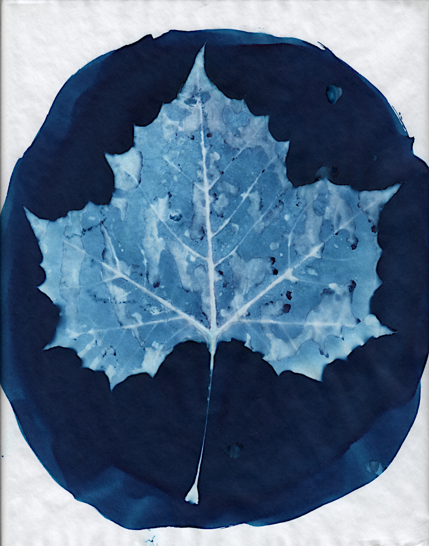

A scan of what this looked like before washing is in the gallery. Here is what it looks like after washing and letting dry for a couple days. When it was first washed, there was darker blue within the leaf...as it dried, the leaf got lighter and the fully exposed area around it changed from a lighter cyan to a darker blue.
It's really fun! There is a huge amount of magic printing out and this is easy and quick and costs next to nothing...

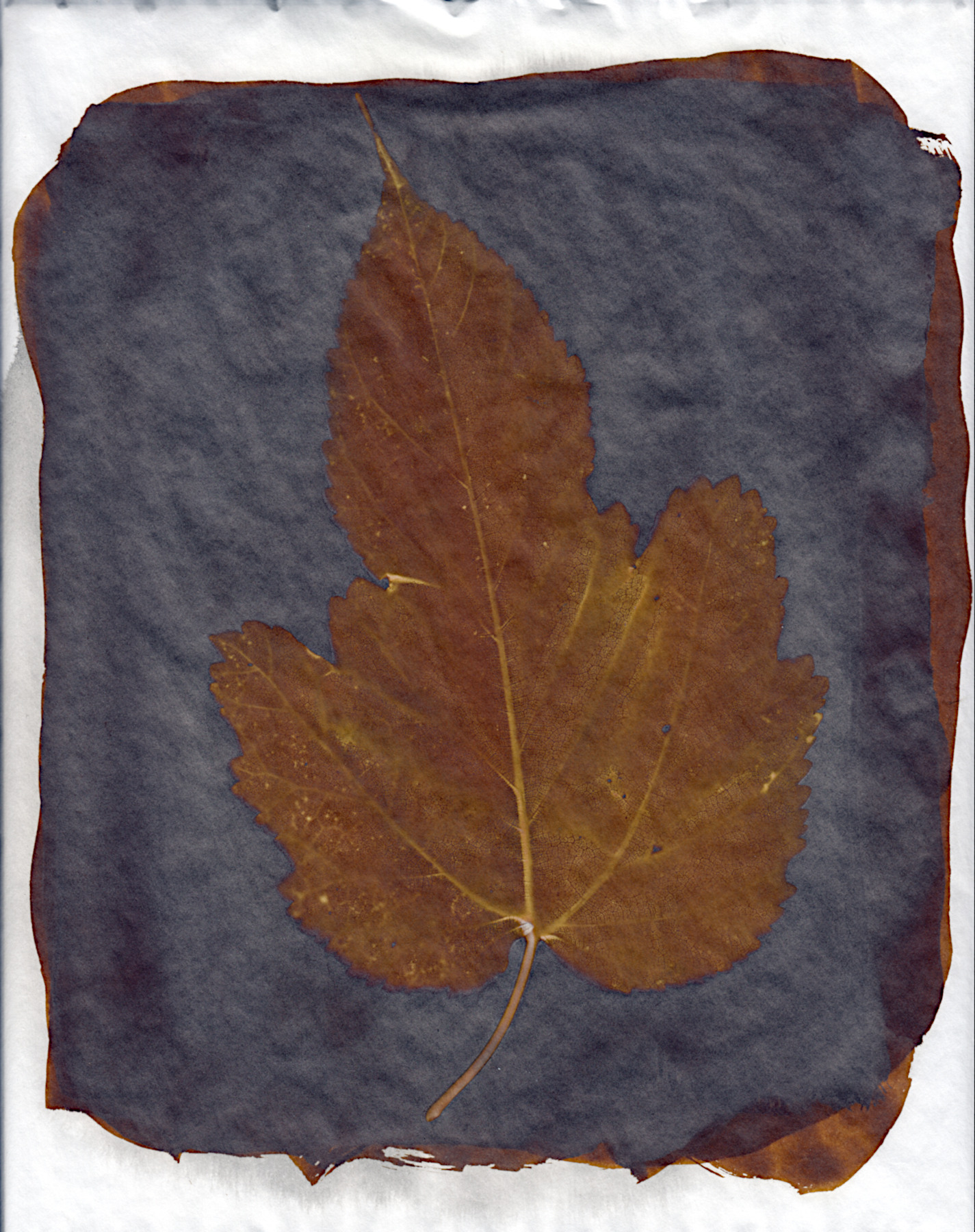

Today I'm going to try to make a "positive" of this maple leaf. I made the "negative" using Namias' Sepia, fixed in sodium sulfite instead of hypo:

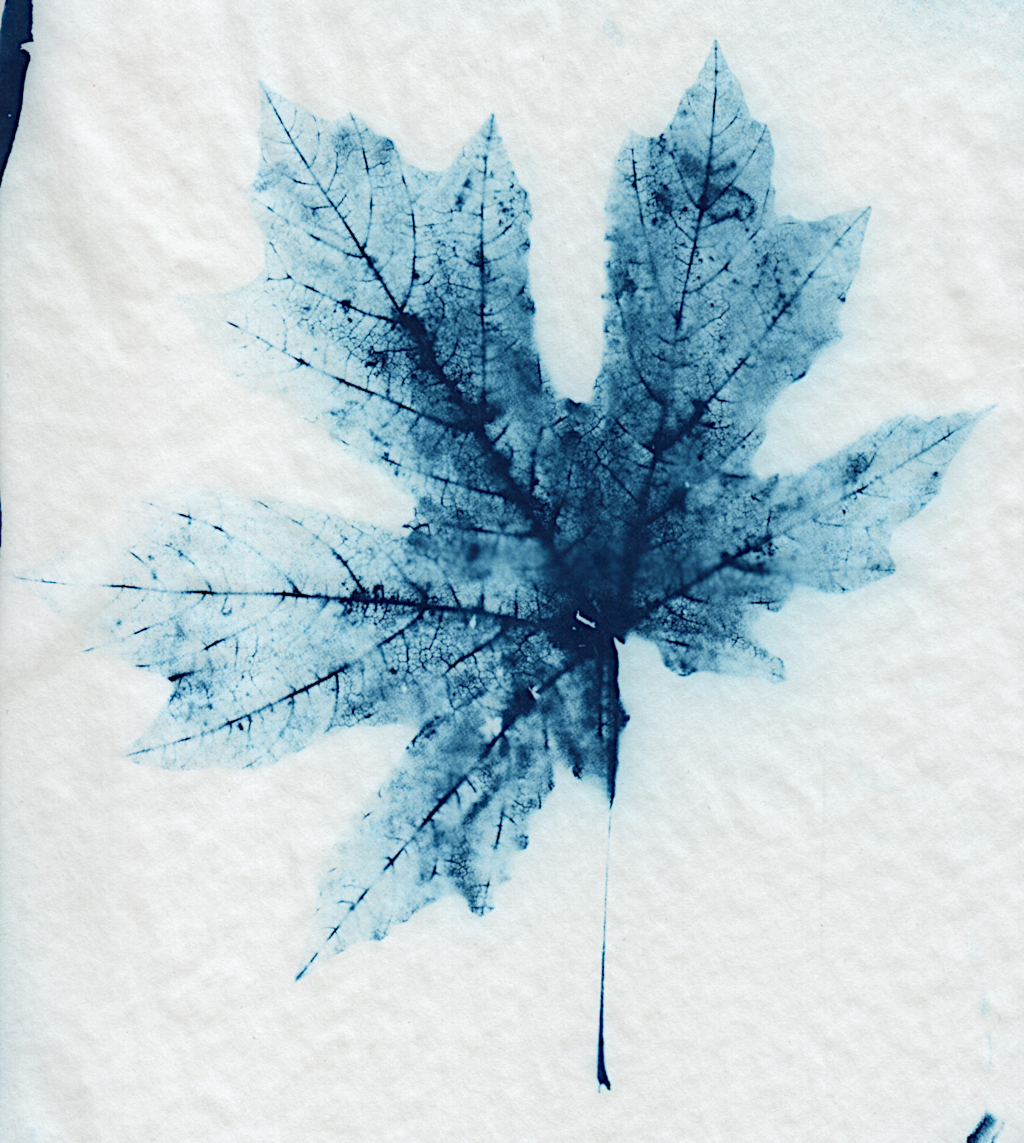

The maple leaf positive cyanotype is printing now... we'll see what happens.

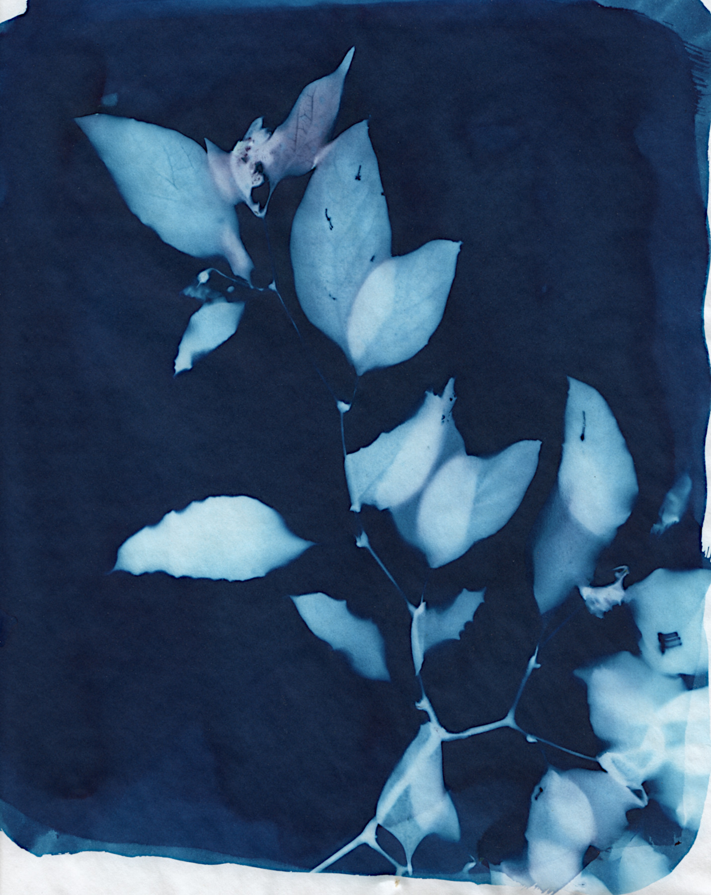

The past couple weeks I've been looking at leaves and my eyes are opening to the infinite variety.... even under the same tree they are all different and each one unique.

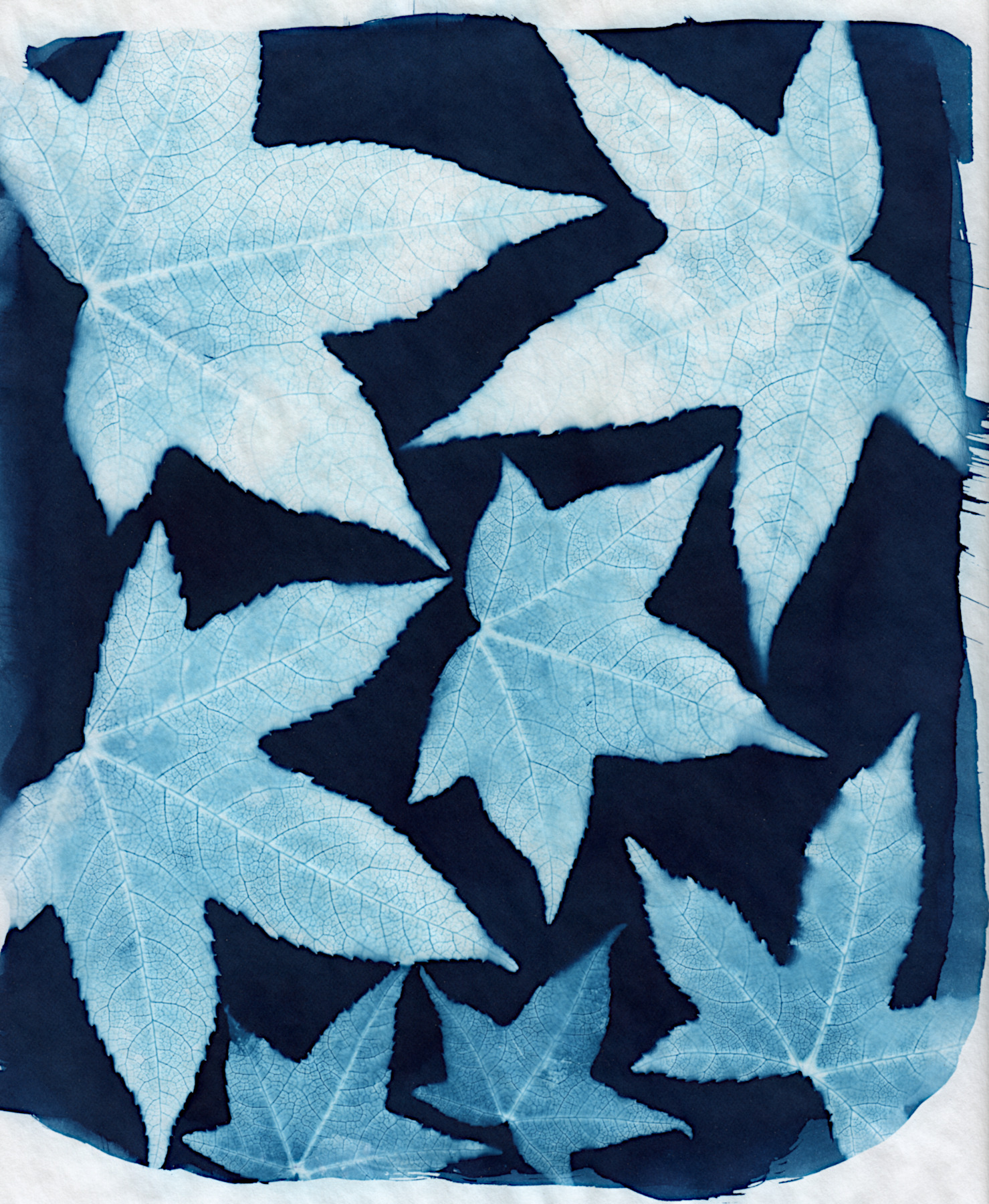

Here's the positive I made from the sepiaprint maple, and also a liquidambar one...
All of these are 9x11 inches on canson marker paper ( someone here recently said was good for cyanotype and I've got a couple extra 11x14 pads here )
Sorry for the silly question: How do you get the positive print? You don´t use the "Pellet's process" for it...
Hi BJ68, To make the positive print, I contact printed the negative in post #4. The negative was made as a sepia print, which is supposed to work better as a negative than cyanotype.
The only thing different for the sepia print was that I used 5% sodium sulfite to fix it, rather than sodium thiosulfate. This was recommended by Namias to make a more yellow image for printing.

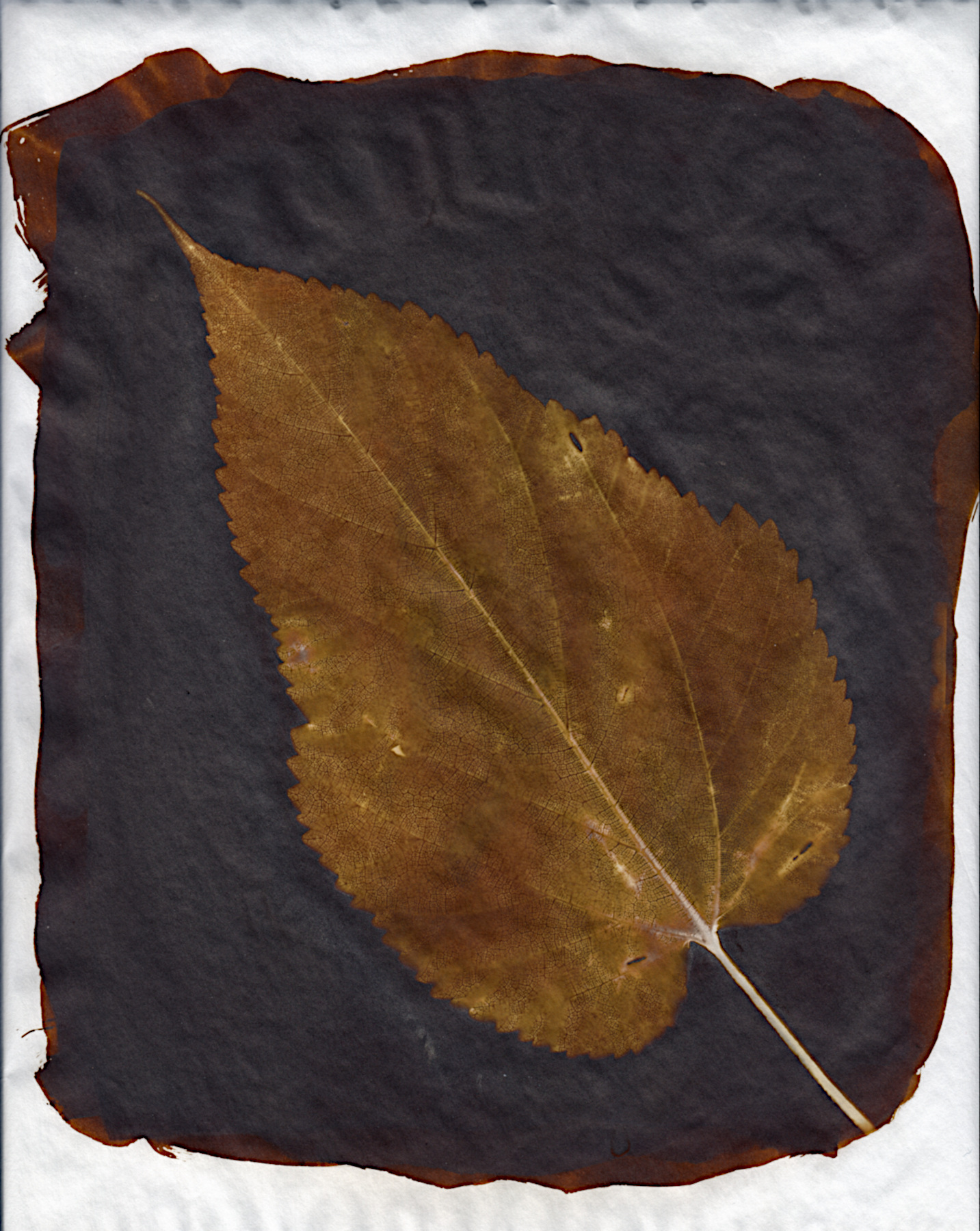

Not sure what kind of leaf this is. Printed yesterday. A positive cyanotype from this is exposing right now.
According to Leafsnap app, the closest resemblance is to Amur Maple.

From the start, I figured it was going to take a lot of UV to make an "x-ray" and see structure of the leaves. So these are all pretty long exposures. I've been putting the cyanotypes out in the yard in the early afternoon and then picking them up when I get home ( I'm not sure exactly how many hours until the sun goes behind some trees, but at least 2 or maybe 3 ). Then I've put some of them under my BLBs for another couple/few hours. I don't think I've seen a cyanotype yet that I thought was overexposed.
For the sepiaprints, I can't remember how long I put that maple leaf under the BLBs, maybe an hour or probably 2. But the ones I've done since in the sun have all been overexposed -- I can't make positive cyanotypes from them very easily ( but they still look neat even if they don't make good negatives ) One positive cyanotype I left under the BLBs for 8 hours and it wasn't nearly enough. Yesterday I left that one just above in the sun all afternoon and then under the BLBs for a couple hours, and it looked neat but I knew it was going to all wash out and it did. Yesterday I made the sepiaprint I'm about to post below, and only left it in the sun for 1 hour, and even that was probably too much.
The leaves have been yellow, light green and the liquidambar had green and yellow and red in them. The leaf definitely matters... I tried a green fig leaf cyanotype, left it in the sun all afternoon and then under the BLBs all evening, and it looked neat at first, and even after washing it was okay, but when it dried it became all white.
There have been surprisingly few failures... maybe I'll make a post with some of them. Anyway, the sepiaprint is a lot faster! I remember when I first tried sepiaprint thinking it was about twice as fast as salt, so probably for a salt photogram with leaf details, it will take a few hours of sun at least.

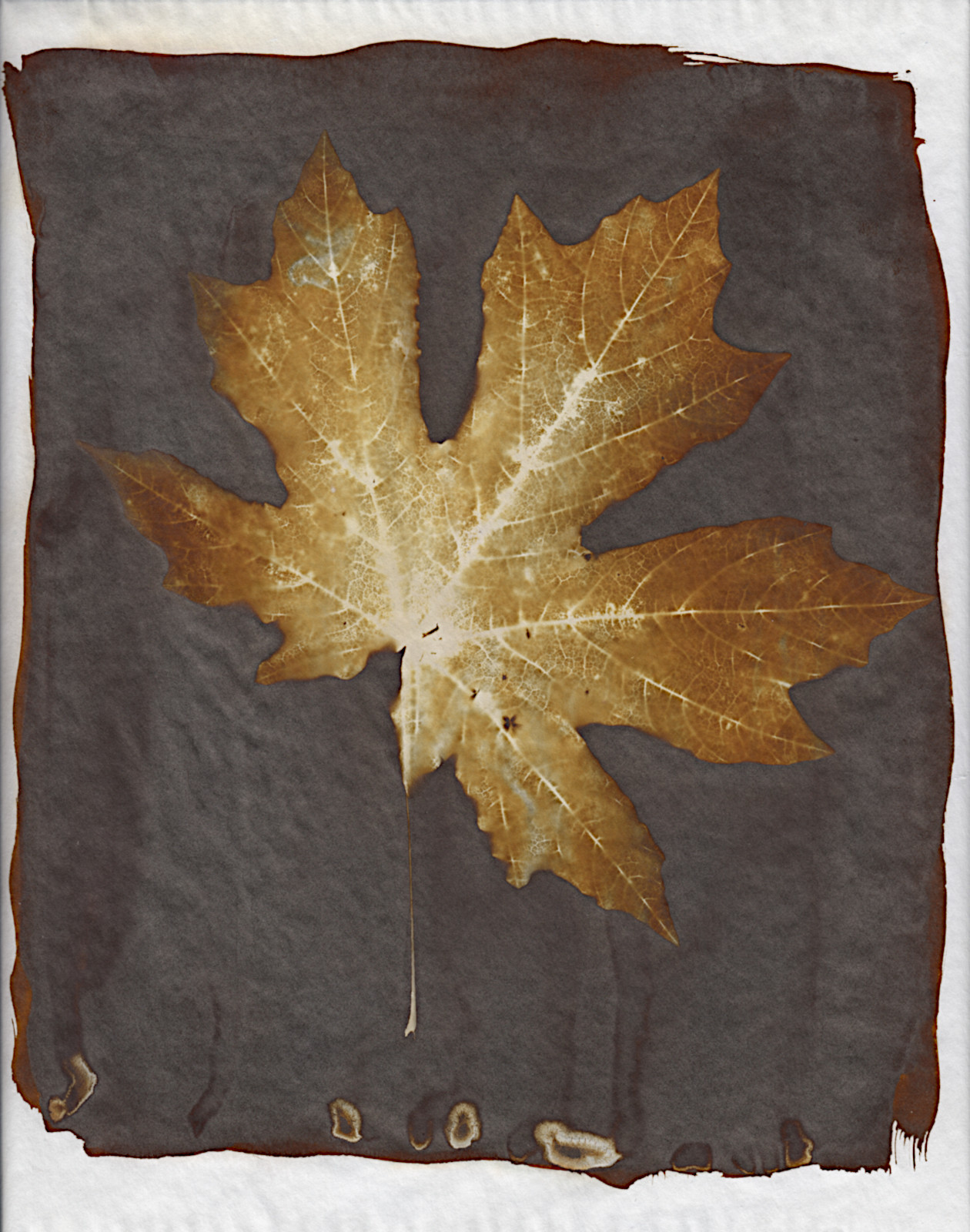

sepia negative ( 20m in sun ) and cyano positive ( 8h under BLBs ):

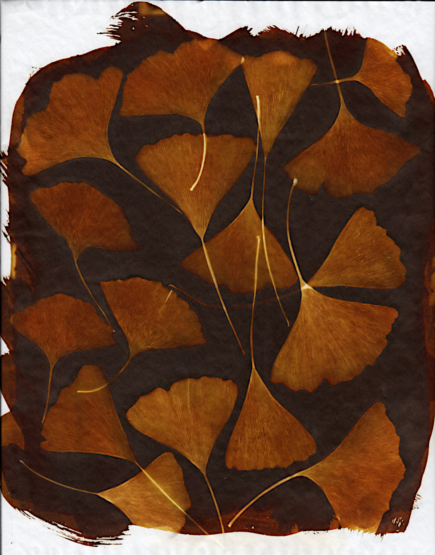

ginkgo biloba sepia:
I'm out of sodium sulfite. I'm going to try fixing the next papier sepia photogram in salt like pdeeh did... it makes an interesting and very pretty gold color. No idea how it will behave as a negative.
