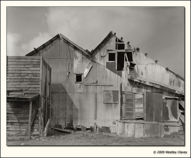

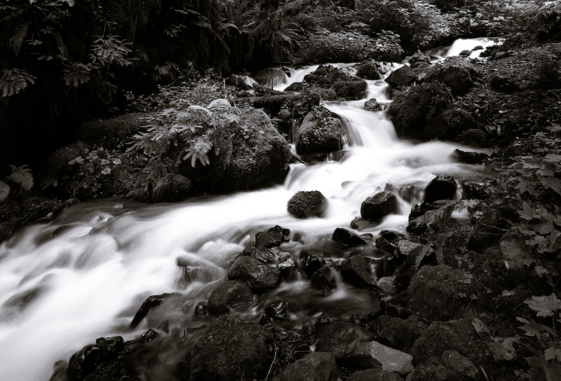

Films: Arista.EDU (100), TMY-2 (400), CXS Green X-ray
Film size: 4x5
Developer: Diafine, each solution diluted 1:1 with water at use & discarded
System: Jobo 4323 tank (8-12 sheets) on a Uniroller reversing base
Some samples:
TMY-2
TMY-2
X-ray
