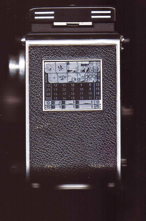

Rolleiflex with built-in 'meter'!
I use the sunny-16 rule to check my hand-held meters.

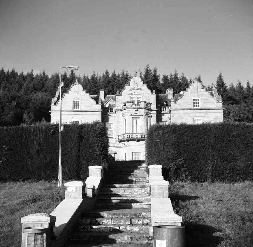

Hmm, seem to have stirred up a bit of a hornets nest. I'm still attempting to upload a result.......
This is bright low sun shot using the Rule.
So; Pan F with a Y filter makes 1/20th Sec at f16
Zeiss Ikon 120 folding camera.
Dev 6 mins in RO9 at 20 degreesC.
This is Baskerville Hall, Clyro, Mid Wales.
