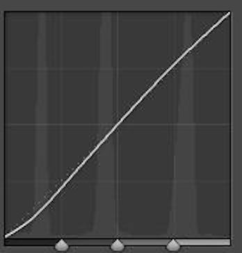

Just measured at Latitude 38 degrees, 11:10am on Pacific coast with a clear cloudless sky:
ISO 250, 1/250 f/16 +0.3EV using Minolta Autometer Vf with incident hemisphere...close enough to the traditional Rule of Thumb for me to trust the rule! I trust my incident meter.
Here is a reflected metering target, and the histogram of this shot, as exposed per my Minolta Autometer Vf reading:
